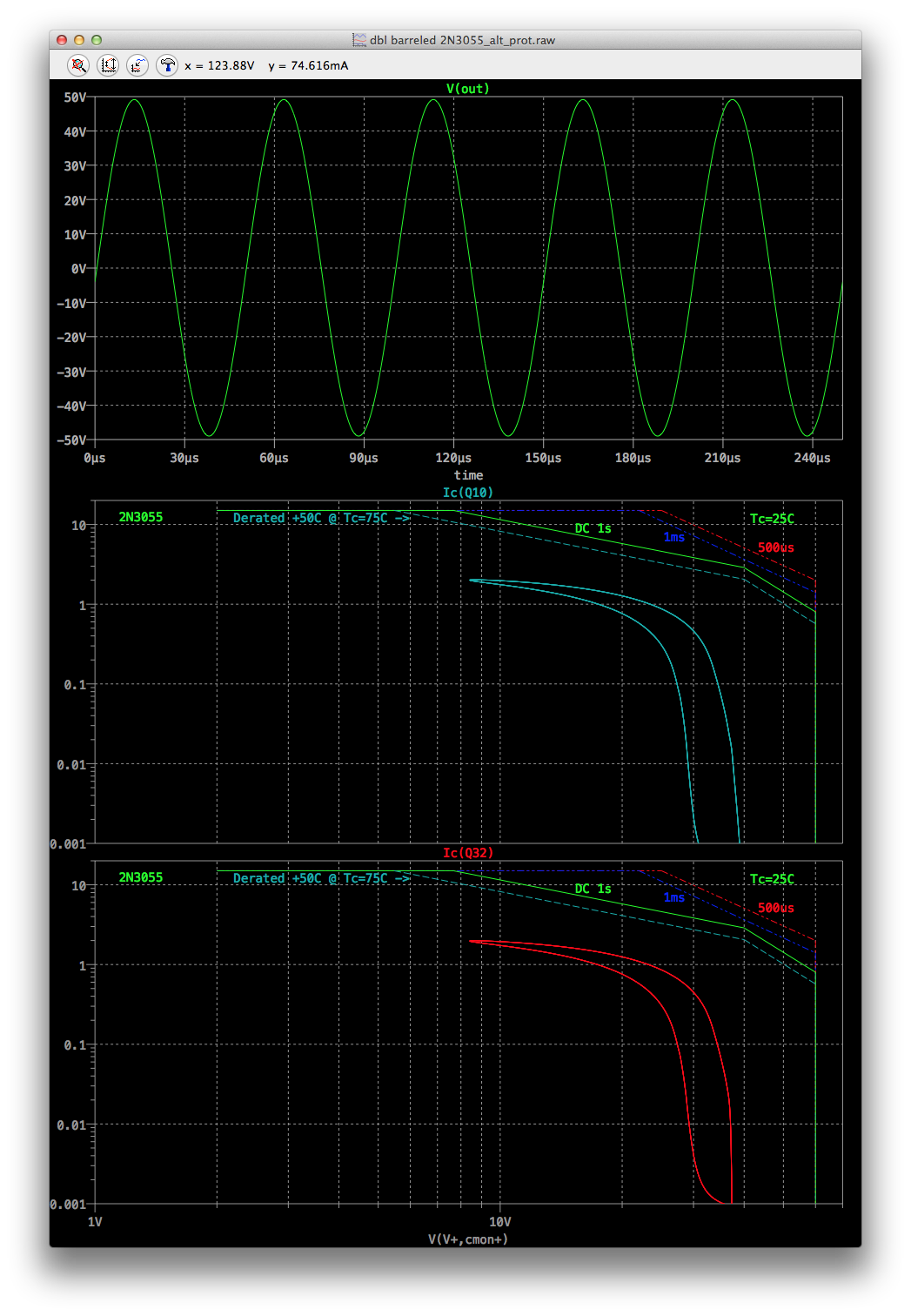

Did you derate the outputs for heatsink temp rise, say assuming 75 deg C case temp?
When you say 3 sets of outputs, I assume you mean series connected for a total of 6
output devices per channel?
Yes. See attached example.

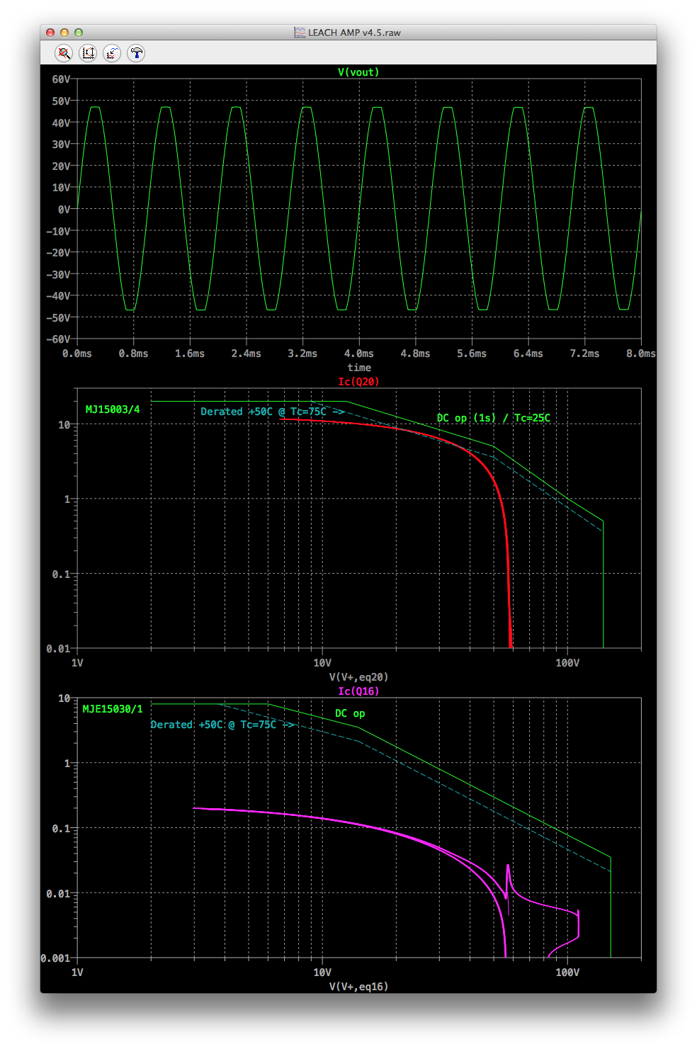

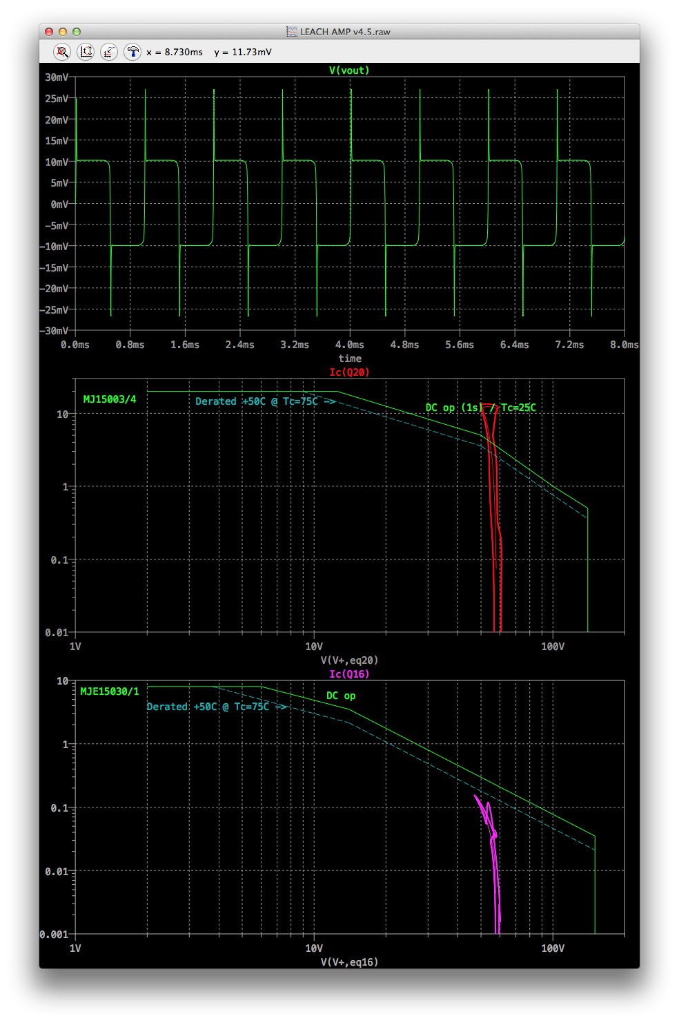

The worst part is if we throw a crowbar on its output. I put a 1mohm dead short on the load, and the SOA is totally violated, the limiter are not preventing a potential failure.
As an example, I'm posting a visual of the 2ohms resistive load case, where we can see the derated SOA being slightly violated for the outputs (just one of them, as they are all dissipating about the same).
The next posted visual is this same sim but with a 1mohm dead short on the load, and it's quite clear how the limiters just can't keep it SOA safe.
One good thing at least is that although the outputs have their SOA grossly violated, the drivers are safe there.

I would use a newer device that can handle the voltage - this has been proven out there are many modern devices that can take the full VAS voltage.
For the original sim, I left his original choices in place and used the models posted with the sim on his site for the leach amp.
But since the superamp sim would not work properly, I have tried other sims of it using a good number of models, including that 3055 based versions I wanted to get going, which just couldn't work properly.
I would use the BC550C/60C for the front end on any leach build, regular or double barreled, and for the vas, seeing how bad the DB139/40 behaved there, I've tried the KSA1381/KSC3503 and 2SA1381/2SC3503 from various origins, and so far, it seems the only ones to work right in those positions are the 2SA1381/2SC3503 from cordell's library.
That works for both the vas and predrivers.
Then I tried various options for the drivers, and the ones I got to work are MJE15030/1 that came from the models posted with the sim on his site, but that I had tweaked by adjusting their VAF to a more realistic value. Only then it worked somewhat fine. Cordell's models for the MJE15032/3 didn't work out well at all there.
Then for the outputs, it just refuses to work right with any of my 3055/2955 models. Once I replaced those with cordell's MJL21193/4 models, then it started working about ok, although not without some issues, but at least no wild oscillations that wouldn't go away.

In the 3055 version, I did end up removing his nested feedback loops and used TMC plus a few sprinkled caps here and there, necessary to keep that thing from oscillating wildly. And that way it does perform somewhat better, once the oscillations have stopped, the thd is lower, but definitely not a stellar performance.

Actually I don't, since I haven't tried 3055s on the regular leach amp, because it's not worth bothering, with the rails having to be lowered to some 30-35V.
That was the whole point of the double barreled, which is exactly suited for this.

It would work fine at 20hz, or 1khz, but when increasing frequency, at some point, trouble starts, and it gets worse as frequency continues rising, to be an unrecognizable sine at 20khz and some 20-40% thd, with a lower output level than it should, and in most cases, after a few cycles, it would latch up to a rail, usually the positive one.
Have you added the AC source in the feedback path in order to look at gain and phase margins?
I inserted a tian probe and looked at those things, which looked really phenomenal, and logically would mean that amp should be totally stable. The phase margin at some point was near 100degrees, with gain margin near 40db.
Any amp with that much margin would be super extra stable, and yet, with those readings, it was totally out of control.
