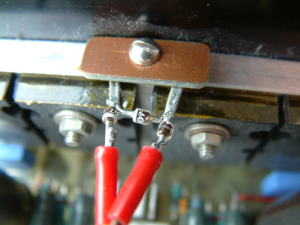

I found Leach’s original arrangement of three 1N400* Si diodes forming an H best, but with the leads themselves clamped to the heatsink via a Kapton insulator. This gave a much faster response to changing temperature than the diode bodies would.
His design calls for 4 diodes. Did you change that in one of your builds?
I see in your photo it's a rather tricky thing to set up. Exactly the kind of thing I wouldn't want to play around with.
It likely would, but likely as well not to be as fast as what you get with a TO126 bolted on the sink.
And I have been contemplating lately the option of slapping that sensor right on the TO3, bolted with one of its screws, sharing the same screw.
Even with an insulator between the TO126 and the TO3, it's only one extra thermal junction instead of 2 if they're independently mounted on the sink, and the distance and material between the junctions would be as little as we can possibly get. This I suspect would likely be the fastest response possible.
The only small hitch would be to have to file off a tiny bit of the TO3 case to allow the TO126 to rest flat on it, depending on how that TO3 was made...

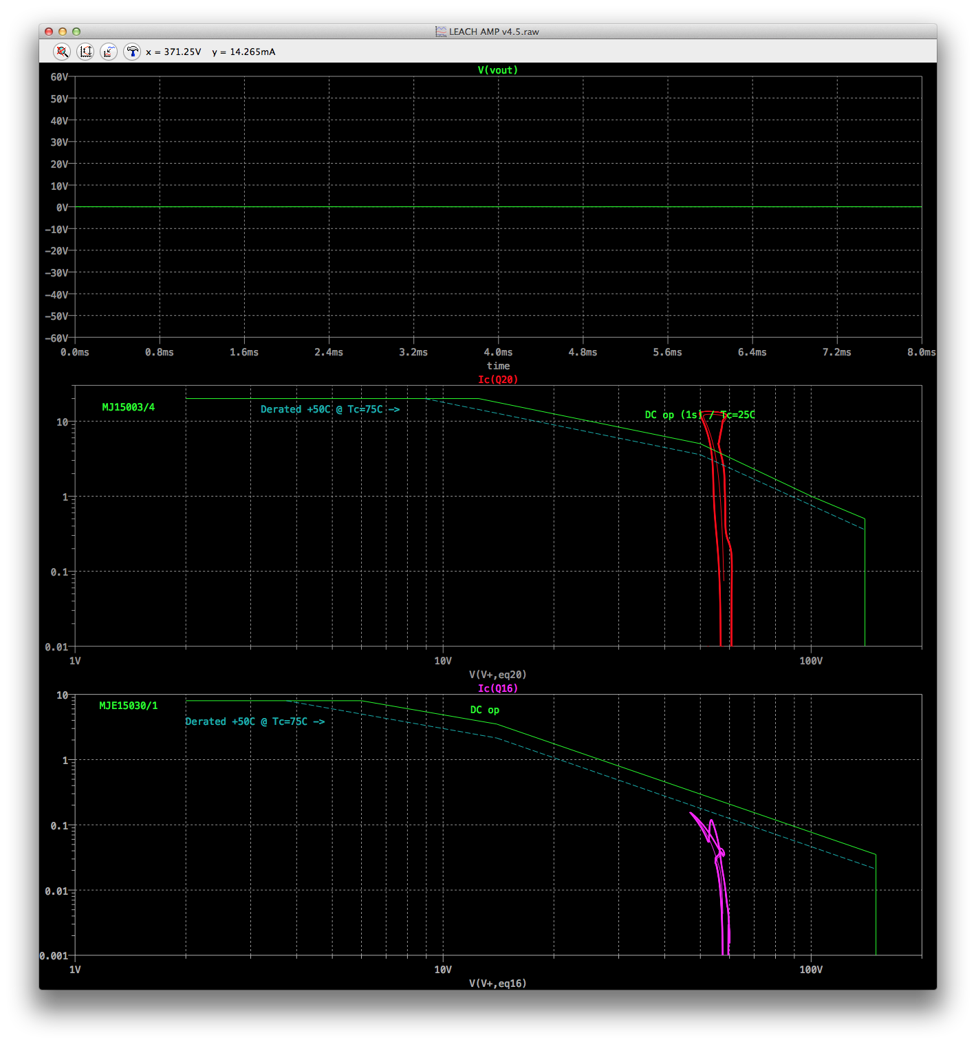

Here is to show my point about the limiters.
The posted plots are showing a definite soa violation, despite the limiters acting.
This is done on the original leach amp, as is, with his calculated published values, the outputs are the MJ15003/4, the drivers MJE15030/31 (models from the sim posted on his site), the pre-drivers are the 2N3439/5416 and the protection ones are the MPS8099/599.
That sim ran at 1khz, and I threw a dead short that would likely never be encountered in reality, at 1mohm. But a short of something like 100mohms gives about the same results.
The drivers are ok, no violations, even with the derated soa.
However although for normal use even under 2 ohms, the MJs outputs are fine, the protections don't work enough to keep them soa safe, at least in the sim.
What are we supposed to make of this? Why would a real build work better than a sim?
In my new 3055based superamp sim, I am using a more "involved" limiter, as described by Kiwanuka, with a dual slope and I have tweaked certain things, such as the caps on the bases and the sensor res, as well as the res on the bases (2k2), to make a more optimized time constant that is shorter than it really should, so the action would come in early enough, although not too late either.
This is still not enough to keep the 3 sets of outputs in their soa, and it does work much better on a 4 sets build, with minimal violation, but still some.
