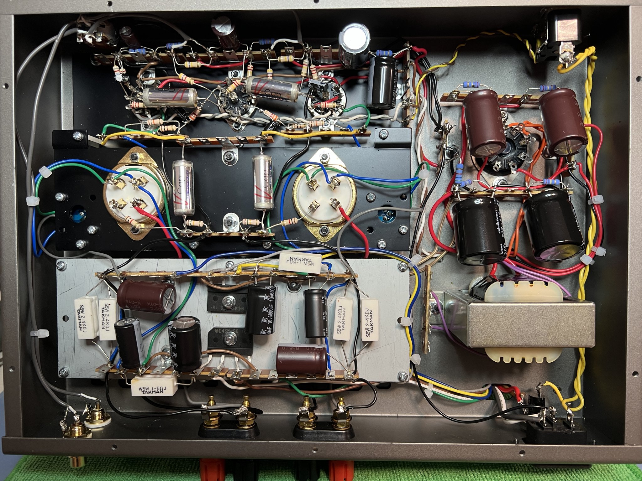

In this case I am not sure why I am getting low level 60hz on the output. If anyone has any ideas your help will be greatly appreciated.

Thank you for being so helpful. The hum is on both channels. I am using the 5AR4 rectifier (Gold Lion). Attached is a picture of the build.
Ron
Ron,
Knowing the hum is in both channels is helpful to the analysis. Thanks for sharing the photo. I'll take a closer look after work tonight. However, for now, I have a suggestion that is quick and easy. It may not solve the issue, but it is nevertheless best practice. You have the input coax cables tied together with and running parallel with the 300B filament supply wiring for a couple of inches (left side of your photo). In all my years of car audio installs, I have always made sure to separate signal runs and power runs as much as possible, and when they have to be close, always try to have them perpendicular. You should try removing that cable tie and pulling the blue/green wires away from the coax cables, and situate the blue/green wires so they are not parallel with the coax cables. You could be coupling the residual 60 Hz component in the DC filament supply into the audio input signal lines. The hum pots will address this at the output tubes, but it cannot affect noise imposed onto the preamp input stage.
-Chris
Ron,
Maybe I'm not seeing enough detail in your photo, but it looks like you have grounded the positive terminal of your right channel speaker output. I think the grey wire should be by itself on the positive post and the two black wires should be on the negative post. You may want to take a closer look at this.
-Chris
Hi Chris,
Yes, that was a bit of carelessness on my end when I took the filament supply out to check the output transformer connections. The problem was quickly identified and fixed when I got no sound from that channel. I also seperated the input coax wiring from the blue and green filament supply.
I am still getting ~0.125mv of AC on the output with no input connected so the hum problem is still there.
I appreciate your help thus far and if you have any other ideas, it would be great.
Ron

Hi Chris,
That is 125mv, typo on my side. I am using the 8 ohm tap and the feedback is indeed connected to the 16 ohm tap. I have also made sure that the 0 terminal is connected to the E, did not miss that part.
I have checked all solder joints and they all have good connection from what i can tell. I also checked the resistance between the negative output terminals, the star ground point, the chassis and volume pot. looks like the resistance is 0 for all these connections and it all connects to the ground terminal on the IEC socket.
My speakers are full range Lii Song F18's, single driver, no crossover. Should be a simple load on the amp.
-Ronen

If that is the case, without plate voltages present, about the only plausible explanation I can think of is that the power transformer is electromagnetically coupling with the output transformers to produce the hum. I notice in your photo that you did not twist the two sets of power transformer wires going to the the filament supply plate. Those wires run in close proximity to the output transformers and it is certainly possible they could induce current in them. The photo of the SV built product shows all of the wire groups of the power transformer twisted, even the main AC input. You might want to try desoldering the two 3-wire groups from the filament supply plate lugs, twisting them, and reconnecting them.
[It still would not hurt anything to try this. Maybe twist the main AC input wires also.]
-Chris
Chris,
I do have an oscilloscope and I do see the noise on the scope. It's not a clean 60hz signal but more like noise with a leading 60hz component to it.
I twisted the leads for both filament supplies which did not change anything. Initially I did not as the documentation does not show these as twisted. Tomorrow I will go over all solder joins again focusing on the grounding in hope that redoing the solder will help.

Good to hear you have an o-scope. For electronics work, that is as essential as a ratchet wrench is for a mechanic. It sounds like you are seeing more of a buzz than a hum, due to it having multiple harmonics. That tends to point to bad grounding or ground loops rather than power supply ripple coupling.
Do you hear it (or see it on the scope) immediately after you power up the amp, or does it take a little while to build up, coinciding with filament warm-up? Knowing this would help rule out electromagnetic coupling. Although, since disabling B+ eliminates it altogether, we can mostly rule that out anyway. Since it exists in both channels, it really makes the B+ supply and the 12AT7 input tube the most suspect. Do you have the ability to roll in a different 12AT7 tube for a quick comparison?
It would be worth a try to build up the SS rectifier provided with the kit and swap that in for the tube rectifier. If the buzz ceases or reduces significantly, it could point to a bad 5AR4 tube. A really simple A/B test to produce another data point.
Regarding the B+ supply, carefully check all the dropping resistors and RC filters in the plate supply path all the way back to where it ties into the center tap for the AC filament supply. Use the scope to measure what kind of AC component is present on the DC B+ path at every connection point. This might reveal a bad solder connection or a bad component.
With no input connected, turn the volume all the way down, essentially shorting the input to ground. Then take a look at the AC component on the grid of each tube for each channel. Note what the waveforms looks like and how the amplitudes compare. This may help you find the origin. Each stage will amplify the buzz if it is already present at a prior stage.
Another thing to try might be to disconnect the negative feedback and see what changes. Something there might be making the amp unstable. Again, it is hard to imagine both channels exhibiting the same problem without there being something in common with both, i.e. the B+ supply.
Let us know if anything changes after you re-check and/or re-flow your solder joints. There is definitely no reason this amp should have this level of buzz at the output. What you are measuring is an order of magnitude higher than expected and something is not right. I think it will really make the amp sing when you get this resolved. An unnecessarily high S/N ratio directly deprives the dynamic range.
-Chris
Chris,
Problem solved. Your insights have been super helpful. I traced the voltages and in doing so noticed that the two in series filter caps after the choke were not connected in series as the solder was not making good contact. Once that problem has been rectified all is good.
