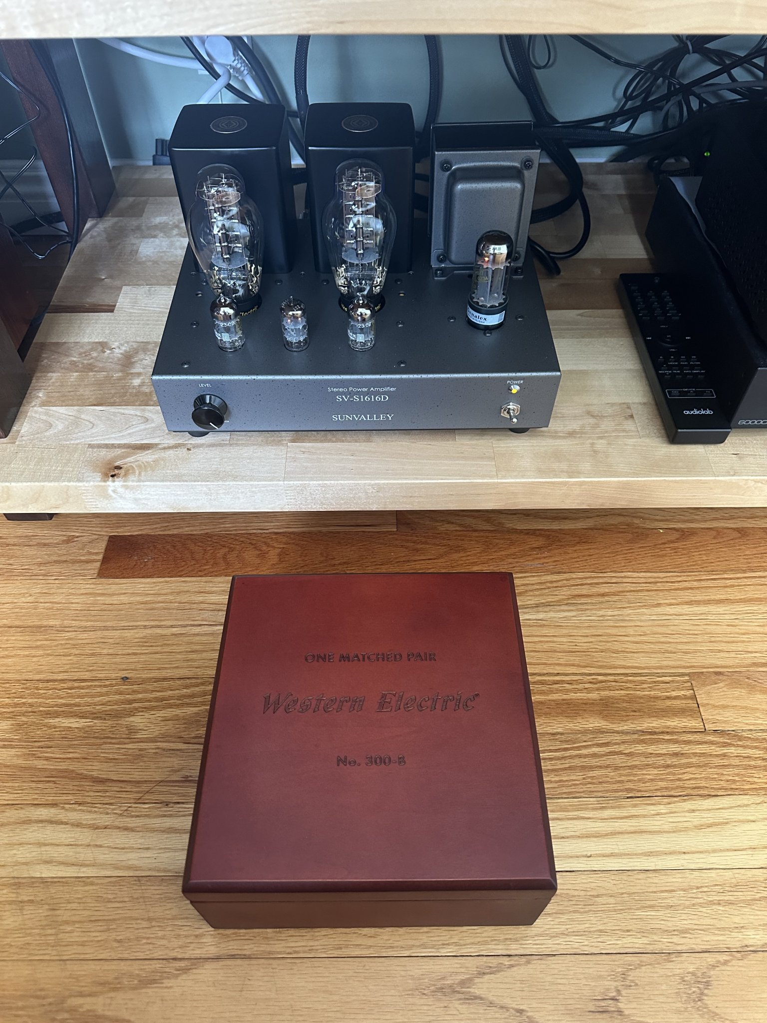

Hey MP9, I finally got my S1616D. I’m using the same WE 30b tubes that I had in the 8600S, and after just a couple days, listening to a bunch of different genres, I much prefer the S1616D. It’s more spatial, the lower mids (and below) are significantly more than with the 8600 - changing the performance of my open baffle speakers. Detail in the highs is less crisp but sounds better to me - a little grittier. Maybe that’s the increased Even Harmonic Distortion of a full SET amp??
And it doesn’t feel slow to me (which I was concerned about). And…It’s got a lot more punch/power behind it - Maybe from the Hashimoto transformers. I’d take it over the Elekit 8600s for sure.
