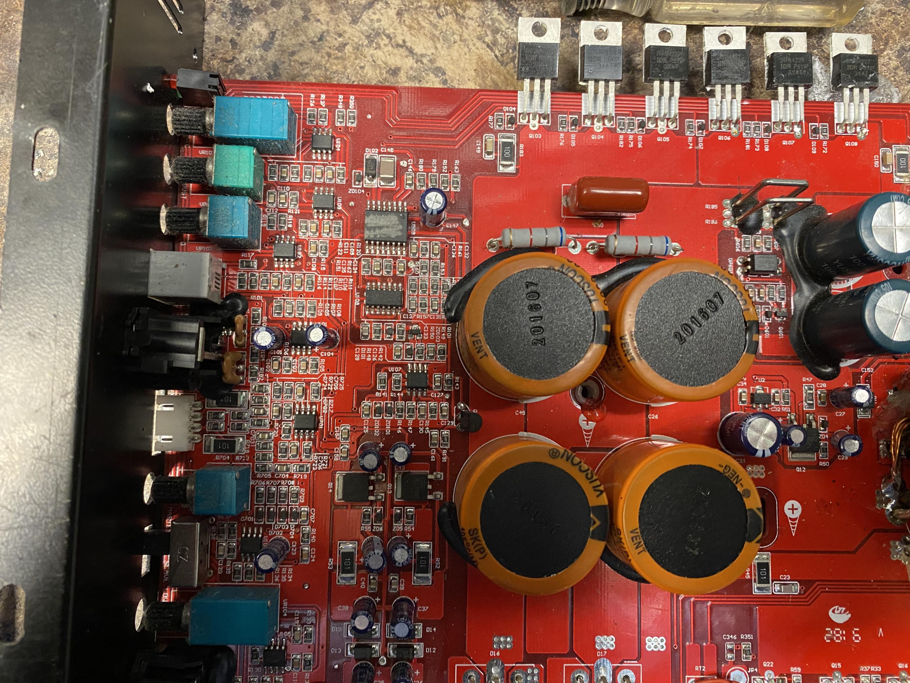

When I load the locations with fets the amp will draw excessive current as soon as the remote wire is applied .
Would it most likely be the transformer or could it be the inductor as well ?

After examining the winding that you pulled off, what convinced you that the transformer was defective?
Is there anything else I should check before pulling the transformer again ?

So I guess I will be pulling the transformer and unwinding it to see if I can find if there is a short since twisting it doesn’t change anything
Virtually 100% of the time, it's best to find the short when the transformer is in the board. Push, pull, lift, twist... When you pull it and the short miraculously clears, expect it to boomerang. If ALL else fails pull it.
I rewound the transformer I didn’t see any shorts on it at all .
Do I load a fet in each bank to see if it still draws excessive current ?
You load the FET locations with no FETs in the PS.
Did you re-wind ALL of the windings, primary, secondary, driver...?
Did you check ALL locations?
Do you have another transformer that you can drop into the amp?
It doesn't need to be close. Even just soldering in the primary windings may help you to track down the problem.

Amp powers up now and idles fine .
Amp produces + - 15 volts on opamps
Amp produces + - 61 volts of rail .
I cleaned the switches and turned the pots they entire range but amp has no output
I get no rail to rail oscillation
Any thoughts ?
Any thoughts ?
Never mind .
I found a broken solder connection .
