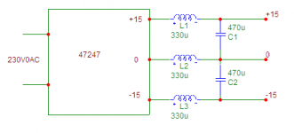

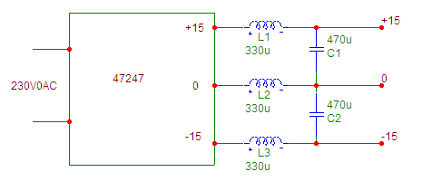

Products | Myrra , "electronic transformer", (switching PSU..) typ 47247. Connect about 330uH inductor in series with each ouptput pin (+15,-15,0V) and than 2 capacitors about 100-470u from +15 to 0V and from 0V to-15 (behind inductors). That´s all..
