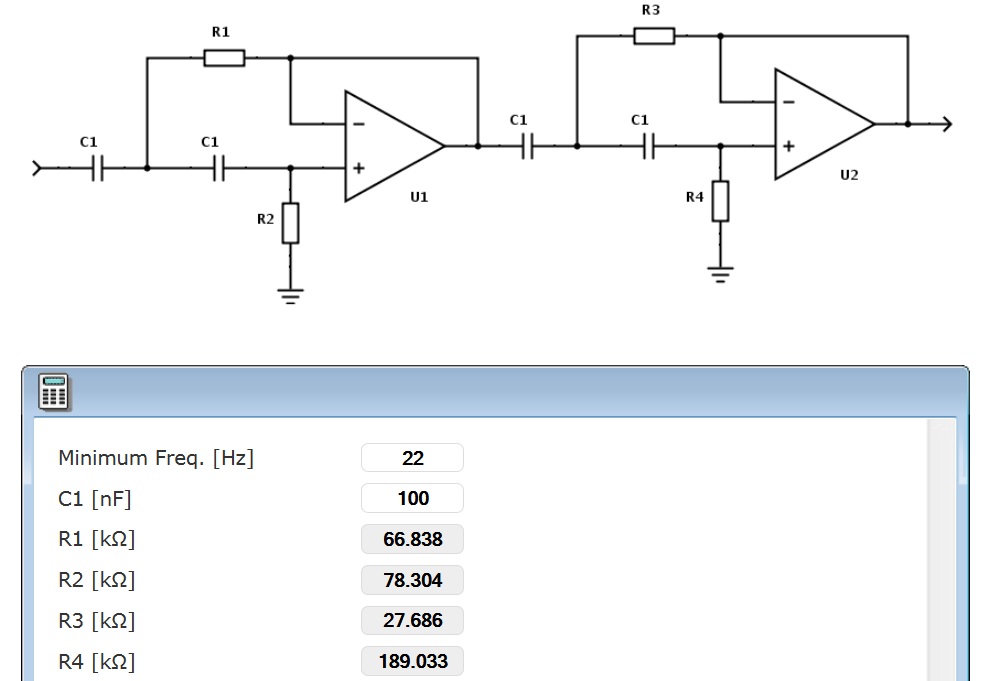

Still not tested anything as of yet but,
The crossover & HPF circuits have "GND" screws/ connections.
I lumped these to the ground in the below drawing.
You're saying PSU common should terminate and not be joined to anything else (as it does in the drawing).(?)
Also, silver plugs used for HPF (below) have grounds, wasn't sure what to connect them to so I left them ungrounded ...
cheers for any pointers,

I wish you would attach your pics.
The barrel of an RCA is the SIGNAL Return.
It must be connected to the Source and it must be connected to the Receiver.
um, I thought RCA consisted of signal and ground.............Doesn't my inexperience shine on this thread haha 😎
How do I connect the HPF filter to plugs then? I only have oine circuit cuz i only need mono...

The SIGNAL has to be connected by two wires. They BOTH connect to the source. The signal connection MUST form a CIRCUIT. What comes out of the Source MUST Return to the Source. There are no exceptions.
The two wires are signal flow and signal return. No confusion and no use of the word "ground" !!!!!!!!!!!!!!
post57 diagram helps with the confusion.
It shows a Signal Input with an in arrow.
This is the Signal Flow.
The Signal Return has been omitted.
The Signal Output is shown with an out arrow.
There are two ground symbols. These are connected to nothing. How much more confusing can the diagram get?
