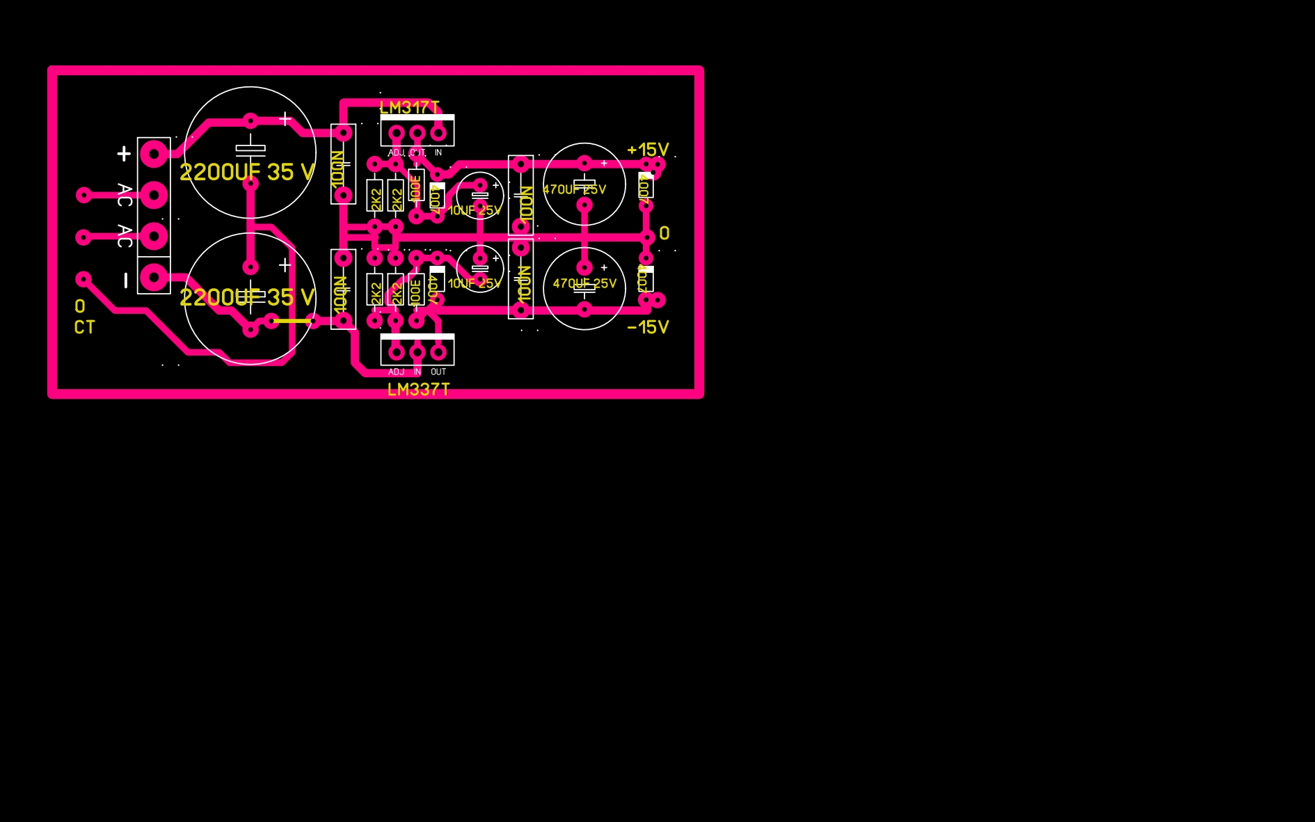

Order has arrived, just want to confirm build with a circuit diagram I pulled from the web. Is this right?
That's it.
I would definitely recommend you power it up initially with a bulb tester in series with the primary (unless you are 100% confident all is connected correctly). For something as small as this a 5-15 watt night light type bulb would be more suitable than a 60 or 100watt.
Also, some regulators need a minimum current to be drawn so don't automatically assume there could be a problem if you test and measure say -18 volts or higher from the 7915. And remember the 78 and 79 regs have different pin outs.

I wired up the 79 up wrong, I think i've fried it...
To confirm i've done this right, a few things
- Secondry legs on transformer - two in the middle, they should be joined together and I've connected common line to this - I don't see how this helps seeing as I don't have an earth plug connected to the transformer?
- I put a fuse between the outer two secondry legs, will this help protect anything? i tried a 250mA fuse but it blows upon power up... I have a 3amp in it now.
