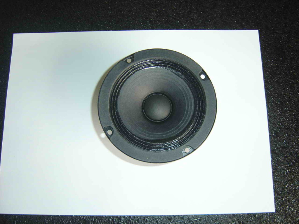

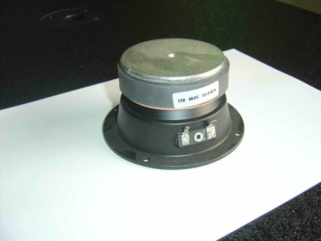

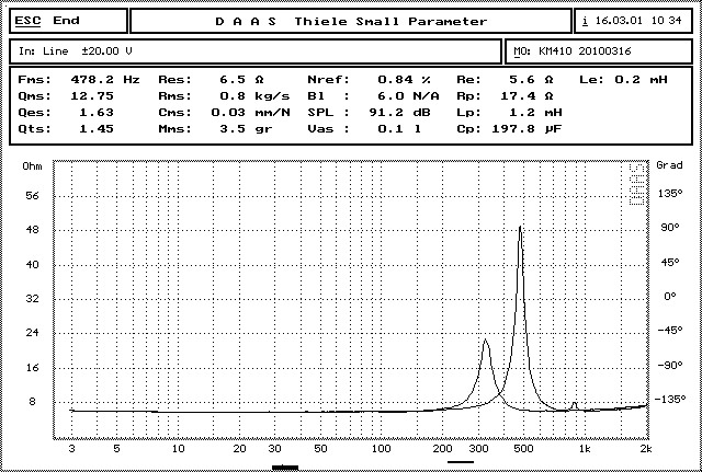

Hi!
I got a reply from FBT Audio referring to the KT410!
Unfortunately they can't support us with the TSP of this speaker, cause the have replaced it with a new one called KM410.
What do you think about it? Would it be worth a try?
gzg
