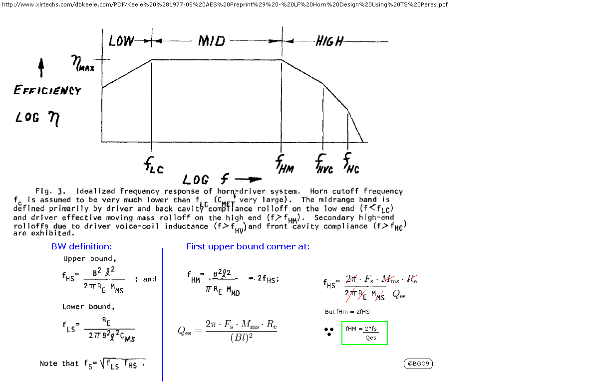

I'm curious why 532 Hz is the 'perfect score' when TD says 500 Hz, though obviously there is some wiggle room. FWIW, the ones I chose for 'M' before he scored the 'real deal' is the Fostex FF125K, which clocks in at ~533 Hz.
GM
GM

Every Unity will have a different target. To keep things simple, I decided to assign a "bullseye target" in my spreadsheet. It corresponds to John Sheerin's "perfect unity woofer", that's all.
For example, if you went with a BMS4540nd, you'd want a target that's an octave higher (1064hz). This would allow you to extend the high frequency response of the mid, taking some stress off the BMS. Of course it would also limit your low frequency extension!
If you used a monster compression driver like one of the TAD 2001s, you can get away with a target that's a full octave lower (266hz). This is because the TAD can live with a lower xover point. Of course, the $95 BMS is hard to beat in the top octave!
In a nutshell, your "target" will depend on your desired SPL level and your compression driver.
Aren't compromises a b1tch? This demonstrates that even if you spend $1000 for a compression driver, there will still be compromises. I hate to gush, but I think Danley has come up with one of the most elegant ways to mask these compromises. IMHO, a lot of newbies think that you can just throw money at the problem by purchasing the best drivers. This shows that driver selection is more important than the cost of those drivers.

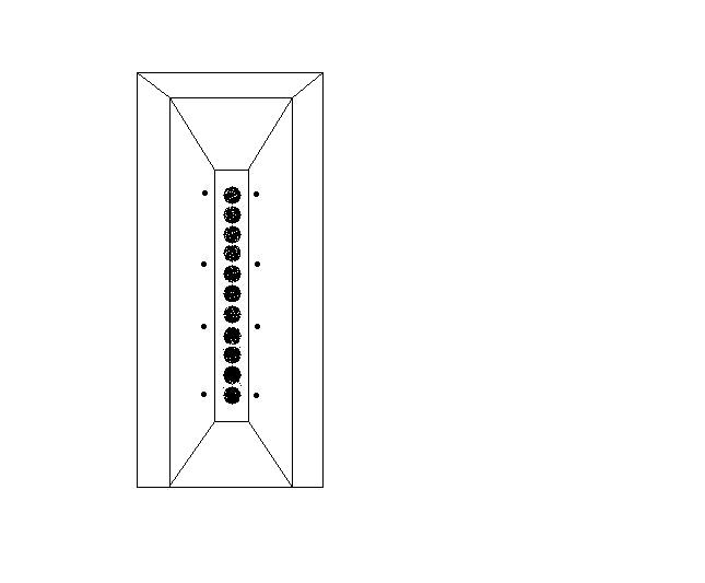

I am working towards a goal of a conically-shaped horn, but my efforts are being slowed by almost constant travel. Did you see my latest attempt: http://people.qualcomm.com/kalousek/index.htm ?
TD's prototype driver's published specs were ~2*250 Hz/0.99 = 505 Hz

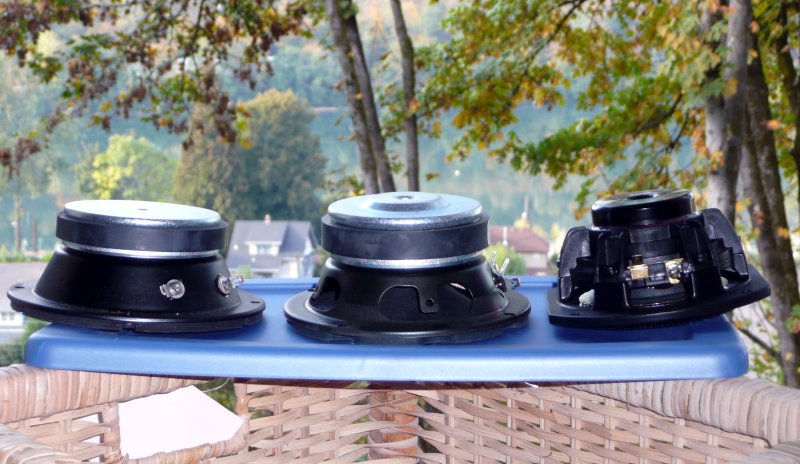

I've been messing with Unity horns for close to three years now, and I've managed to purchase a pile of midrange drivers that work on Unity horns. I have the Misco drivers which I believe were used in the Lambda Unity horns, as well as a newer driver from Misco which is as good or better.
Misco JC5RTF-B, KCN5FD and TB W4-1805S
One thing that we have ignored in this discussion is frequency response and distortion. The woofers in a Unity horn require a very VERY specific set of Thiele Small parameters. Basically it needs a VERY high FS, and a VERY low QES.
What you end up with is a woofer that has an extreeeeeemely light cone, and an accordian surround. If you add even a fraction of a gram to the cone or the surround, it drives down the FS too low, and then it doesn't work for a Unity horn! It's as simple as that - if the specs on the midrange are wrong, your Unity horn isn't going to work.
Because the Unity mids require a cone which is astonishingly light, and an accordian surround, we end up with a woofer that looks a lot like something you'd find on an old CRT TV. Basically a giant version of one of those cone tweeters you see in speakers from the 70s.
One interesting alternative is the Tang Band W4-1805S. Tang Band makes a lot of great drivers, but only TWO of them will work on a Unity horn. The reason that all the others won't work is that their cones are too heavy, which drives down the FS too low, and the QES is too high. This particular woofer is an exception. It has the right specs for a Unity horn, AND it has an underhung motor with very low distortion. I haven't measured it's distortion yet, but it's audibly cleaner than the Misco.
(That isn't a knock on the Misco; it's a MUCH less expensive driver. Misco offers exceptional performance, and the TB gives you all that and more, for an additional cost.)
Parts-Express.com:*Tang Band W4-1805S 4" Neodymium Midrange Driver | Tang Band W4-1805S 4" midrange tb speakers neodymium driver line array point source midrange home theater computer speaker center channel set tube amplifier cone mid

I've studied the Unity horn for close to a decade, and the comments that GM made in this thread were one of the "Eureka" moments when I began to understand how all these pieces fit together in a Unity.
It's not just that we need a high EBP; we need a very SPECIFIC EBP.
As GM noted, here's the formula:
2 * FS / QES = 500
GM or Danley might come in and school me, but here's how I understand this:
The EBP will dictate the upper and the lower limit of our midranges on the horn. It works out to about one octave on either side of (EBP x 2). So if we want to get the mids up to 1khz, our lower limit is about 250hz.

Here are my thoughts on the ones you suggested. I have the Galaxy Audio, and it's parameters aren't appropriate for a Unity horn. You basically can't get it to play high enough. Getting it past 800hz will be a struggle. John Sheerin evaluated the ferrite version for his Unities, and discarded them also.
The Misco JC5RTF-B is clearly the easiest one to work with, has the right parameters, and you don't have to hassle with sealing the back.
The TangBand W2 sounds a bit "cleaner" to my ears. Is it the underhung motor? I dunno. I haven't measured it's distortion, but it sounds very good. It's efficiency is much higher than you might think too; a pair of the W2s nearly match the efficiency of the Misco 5".
The TangBand W4 is clearly the cleanest sounding of the bunch. It is also the most expensive.
2 * FS / QES = 500

Take a look at the Synergy Horn patent.
Both the Unity horn and the Synergy Horn are arrays. In fact, the lab sub is an array too.
Danley is subdiving a single woofer into multiple unique parts, then arraying them on a horn. The midranges and the woofers on the Synergy, Unity, and Lab horns are arrays.
It isn't a coincidence that Danley's new designs, like the new tapped horns and the Paraline use multiple elements. Danley's commercial offerings are quietly solving the problems with conventional arrays.
..It's not just that we need a high EBP; we need a very SPECIFIC EBP..
Hi, I don't think you should mix EPB= fs/Qes with the expression 2*fs/Qes. although they are related: See the picture.
