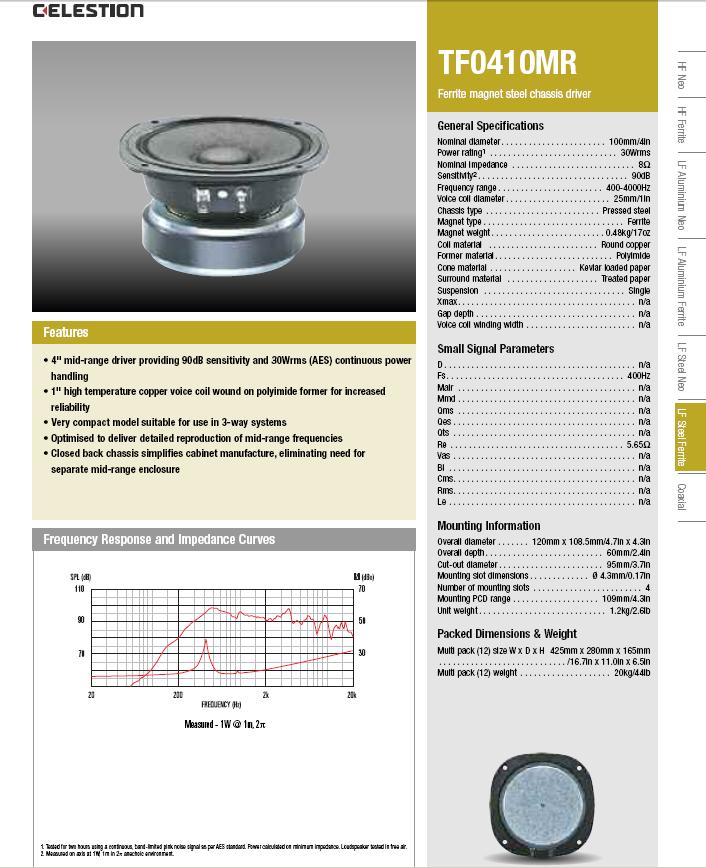

While Danley's choice of a midrange with an Fb of 500hz is a good one, I *personally* prefer one with a higher Fb. That's one of the reasons I like the TangBand W2-854SH and the Misco KC5. When you use a woofer with a higher FB, you can cross the compression driver over at a higher frequency, which reduces distortion. The downside is that you have to run the woofers higher, but it's a reasonable tradeoff.

I've messed around with a number of unity midranges over the past few years. I have what I believe are the ones from the old Lambda Unity horn, as well as good candidates from Tang Band and JBL. After listening to various models, I noticed that I prefer the Tangband over the "real" woofers. I've done distortion measurements on the "real" woofers, and the performance is rather average. Which isn't a big shock - it's an inexpensive woofer with no shorting rings, a limited xmax, and a fragile paper cone.
So this isn't a knock against the Danley design - there aren't many woofers that can take a large amount of power, and have parameters suitable for a unity horn. This thread illustrates that.

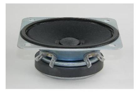

FWIW I picked up a couple of the TB W2-880SL drivers, and they're pretty cool. They look to be the same W2 frame/motor as on the 852 paper cone (although they're metal, and I thought the 852 was plastic) but with an Al/Mg cone which is similar to the one on the Aura whisper but a bit flatter. Published specs look to be very interesting for a Unity mid - Fs 160 Qes .26, Fs/Qes=615 . I don't have a measurement setup at the moment to confirm, but hopefully should have one in the not too distant future.
The slight irony is that I'm actually planning to use these as the 'tweeters' in one version of a quasi-Unity project. This is the "built into the room corner" idea I mentioned on the Unity/Summa thread. I do have a 3-way idea variant using them as mids as well, but I think construction would be significantly more complicated with little benefit. My perception of cost/benefit will obviously change if the top end on the TB's doesn't meet expectations.
I also have the Aura Whispers and a pair of the Fountek FR88-ex which all will be considered for the 'tweeter' role, although I think the TB is looking like the best option on paper at the moment. I'm thinking an xover to the mids somewhere in the 500-800 range dependent on which driver gets used. The scant 1mm xmax of the TB might suggest something closer to 800, while the other two should be OK down to 500 or lower with their 3mm xmax.

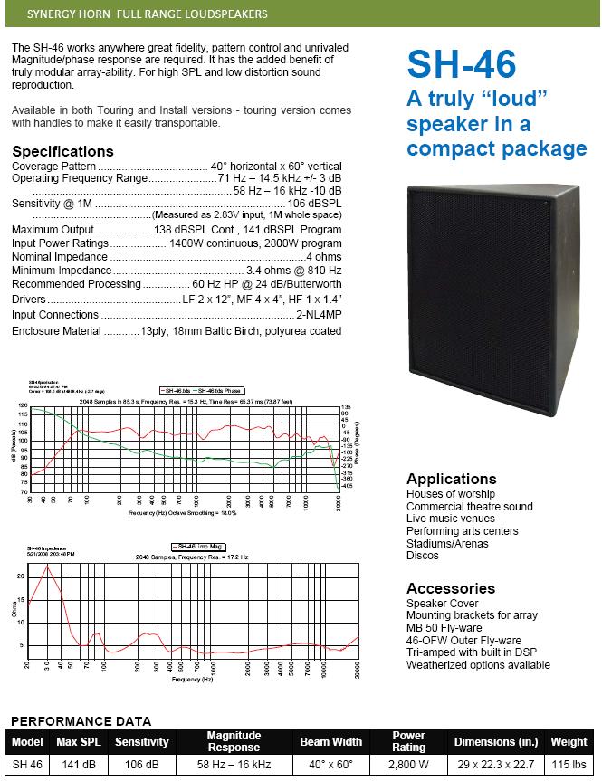

If you've followed my Unity projects, you may have noticed that I use waveguides with ellipitical mouths, and Danley uses horns with square mouths. Because of my choice, the holes on my midranges terminate on a flat surface. Because of Danley's choice, the holes on his midranges terminate at the apex of two walls.
The reason I bring this up is because there's no such thing as a simple duct. As soon as you stick a barrier in front of the midrange, you've created a coupling chamber. The only way of getting around that fact is if you remove the barrier.
But when you remove the barrier, you just ruined your point source.
Basically that's the whole reason the imaging and the articulation of the Unity horn is so re-donk-u-lous, our midranges and our tweeter are all radiating from a very small point in space.
So I'd really discourage you from using direct radiators; that takes away the magic.
Now there are a zillion things you can do to improve the bandpass response of the midranges:
A lot of this stuff seems like too much work, but you really have to dedicate some effort into those ports. If you use a conventional port it would be quite long and wide. With a compression ratio of four-to-one, an eight inch piston should have a 2" port!
So it's a ton of work, but the only way to get the Unity to work is to sort out those ports. You can't just treat it like a duct and get good results.
