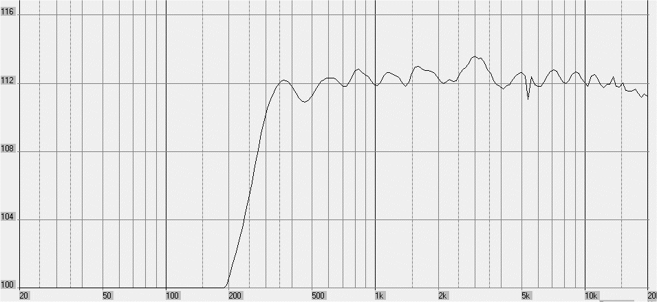

After doing some more sims, I've *never* seen anything that performs like this driver on a horn. I'm trying to 'wrap my brain' around why this thing does so well.
On a flat baffle, this paper cone driver has a massive peak at 1500hz, which is clearly seen in the impedance plot. But put it on a horn, and it practically looks like a ribbon. No impedance bump at all. The impedance plot almost looks like a resistor! If anyone can clue me in to why it's behaving like this, please chime in! I've never seen behavior like this on a horn, and I can't figure out why it's doing this.
I'm guessing this has something to do with MMS? Tom says we want to size the horn throat to 'load down the driver's impedance curve.' In a horn that's one cubic foot, we have 33.6 grams of air. Four of our Pyle midranges have 15 grams of mass, while six of our cone tweeters have a mass of 1.5 grams. That's getting into ribbon territory - my ribbon has an mms that's one eighth of that.

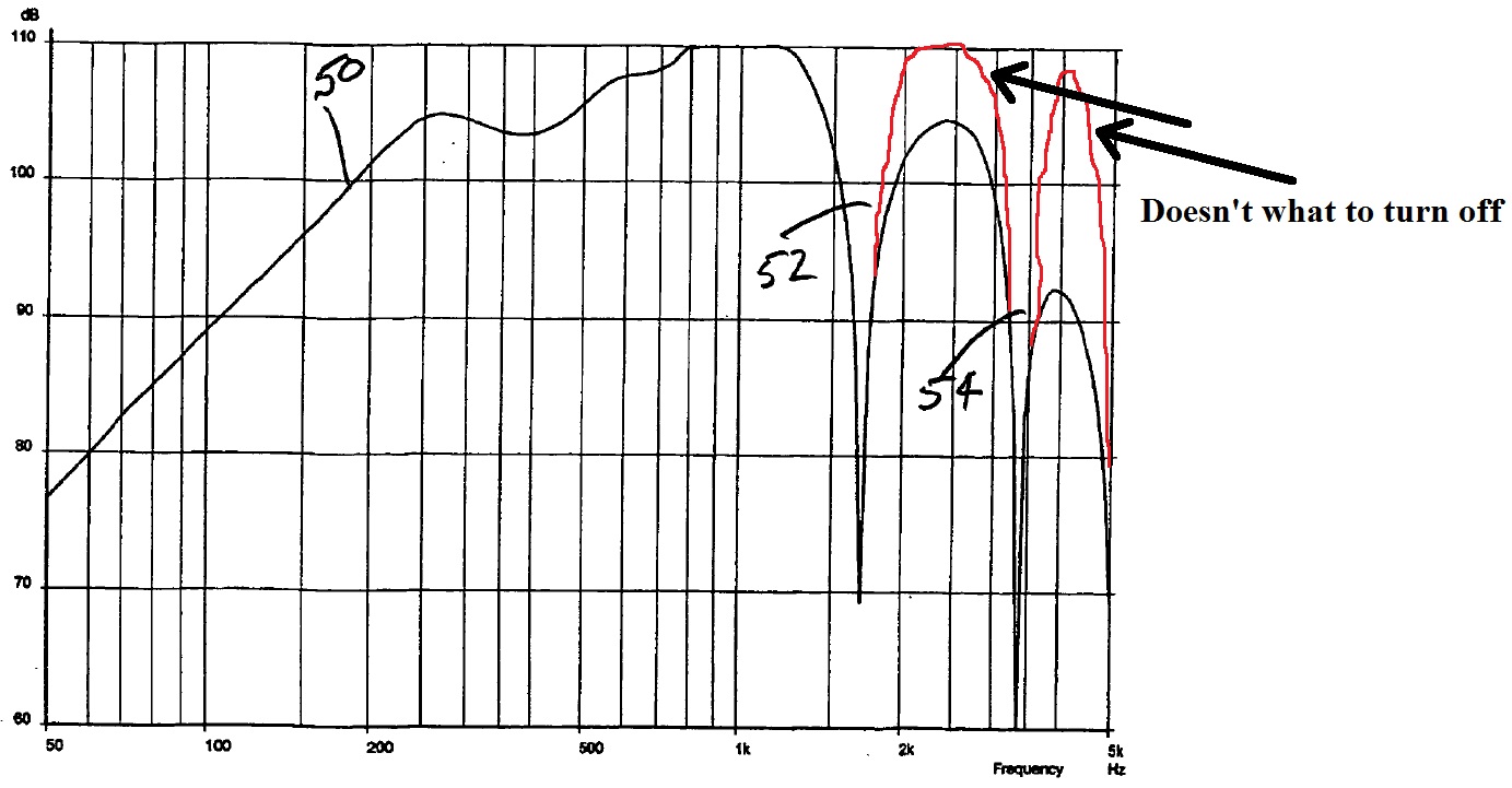

Also, if you mess around with hornresp you might notice that some very odd drivers seem to work alright. For instance, the Goldwood has a ridiculous peak in it's response on a baffle, but drop it into a horn and the response looks great.

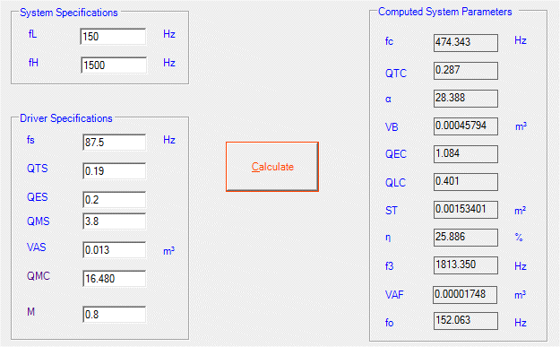

I want to fit the 8PE21 to a unity. I want to find the right passband for it (one that comes naturally), and am willing to seal the baskets if required. That (with a volume of 800mL I estimate) will give a fb of 360Hz in free air. 2*Fs/Qes=875.
I want to go higher than 700Hz, pref 1kHz and will take up to 1k5Hz. I also want to go down below 200Hz so I can cross below the schroeder frequency and hopefully reduce some room reflections in the low midrange. Top end is more important although if the low end doesn't reach I'll need a woofer.
I'm now going to get on hornresp and run it up and down a horn trying to find its outer limits. Maybe you could save me falling in a hole? ;)
