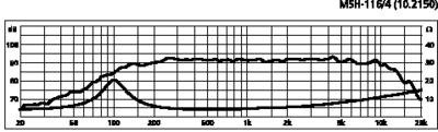

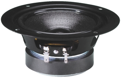

These two drivers are looking so good.. The 6" is kind of pricey, if you think you need eight of them. And I would definitely go with four per side, the lower the distortions, the better, even in a home environment..
I guess that the 4" is not available through normal retail channels though..
Pyle PDMR5 is quite a good choice, easy to get hold of and very cheap. I have not had a chance to compare it to the Misco 5" side by side, however they do seem to be reasonably comparable in sound.
The Celestion 4" requires a larger order and a group buy is a possibility. I feel the build quality is better than the Pyle and it will mount close enough to the throat to allow a higher crossover point. It does appear to sit in a nice sweet spot with good extension potential on both ends of the bandwidth. Anyone interested keep in mind that this driver may become a viable option soon at an attractive price.
