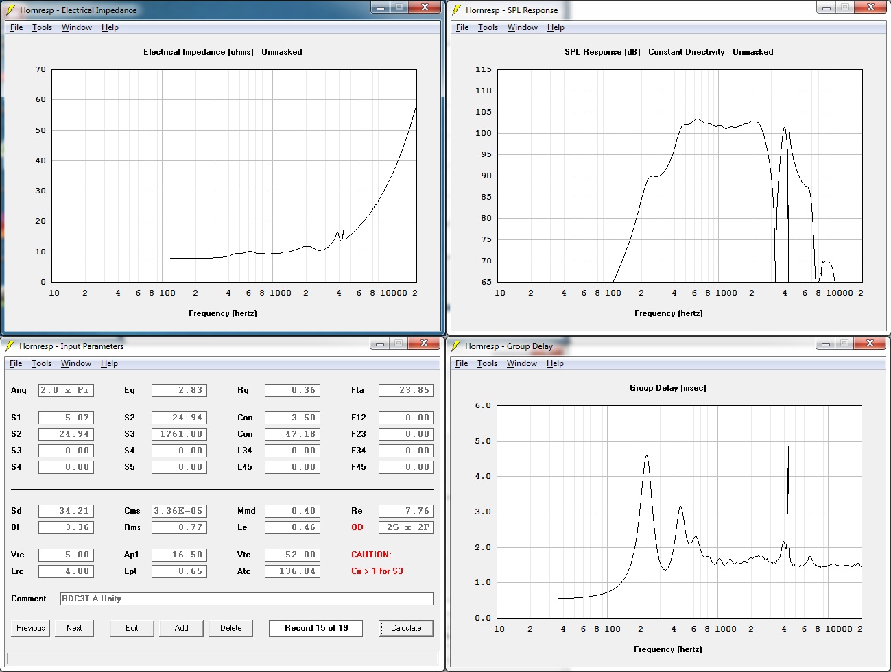

SunRa,
I do almost all my simulations with Akabak, however here is one for Horn Response.

I studied my horn math this morning, and finally 'grokked' why the points above matter in a horn. Because I didn't 'get this' until today, it invalidates some of the design decisions I made in my previous Unity horn. It also seems to indicate that the Yorkville U15 is a bit compromised.
Details here:
Audio Psychosis • View topic - Under Dash Horn Alternative
Note that my designs aren't a complete failure - just saying that it appears that the reason that I had better results from the 5cm woofers versus the 13cm woofers was because of the things he's saying here. (IE, I didn't factor what he's saying into my design decisions.)

PB, Interested in why exactly you should say this? Compared to a Synergy Horn? I know it's better than the original Unity Horn. I've owned/own both so have listened extensively (and even done some measurements ;) )
I'm glad this thread has kept things objective, because I'm afraid Paul's measurements seem to provide the 'smoking gun' in my hypothesis. (My hypothesis being "I think the Unity horn is square for a reason.")
Red Spade Audio: Synergy horn measurements
In Paul's measurements, we see a *dramatic* narrowing of directivity in the Yorkville Unity, begining at 5khz and continuing for a full octave. And if you look at the pic, you'll see the culprit:
There's something 'tripping' up the compression driver, likely at a point where the waveguide is between 6.8cm and 13.6*cm. And looks what we see in the waveguide at those dimensions? Yup, our midrange ports.
Details on the math and all my other ramblings here:
If it's any consolation, it's not just the Yorkville guys that missed this; my own waveguides are compromised too.
Also, kudos to Paul, because his measurements are excellent, and the results he's getting with his design is spectacular. I'm learning a lot from his blog.
