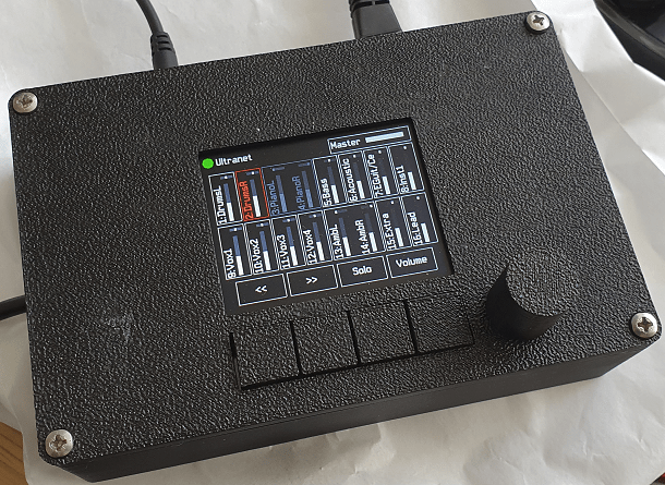

Hi, I've been working on a modification of @pcdimmer's FPGA design, my project is to make a simplified version of the P16M for personal monitor mix in our church band. We already have some P16M units but they are getting to be very expensive to buy, and are also a bit complicated (too many knobs and buttons) for some of our users.
I have passed on many thanks to @pcdimmer for doing a lot of the hard work to get the basic blocks working, on top of his design I have added a simple user interface using a 320x240 LCD screen, 4 buttons and a rotary encoder. This just runs off some spare pins on the Arduino Vidor board. The audio is output using a UDA1334 stereo codec board. I 3d-printed a box for my prototype version.
I have made some modifications to the FPGA configuration to give basic audio metering on each of the 16 channels as this is useful for initial line checks. Also I have added a sync line from the incoming ultranet to the output codec as I was getting some crackling which I think was caused by the output free running vs the input.
It all works great, except one weird problem. Using an XR-18 mixer, the 16 channels are in the correct order. On an X32 mixer, ultranet channels 3-8 appear on my unit as channels 1-6, then ultranet 1-2 appears at channels 7-8, Same for 9-16. So the X32 obviously does something different in the frame encoding, but I can't work out what it is yet.
The RP2040 approach also sounds very interesting as the main drawback of the Arduino Vidor board is it's quite expensive at around £70-£80. I'd be interested to see the code for that. My fork of the original code is at
https://github.com/congoblue/UltranetReceiver
