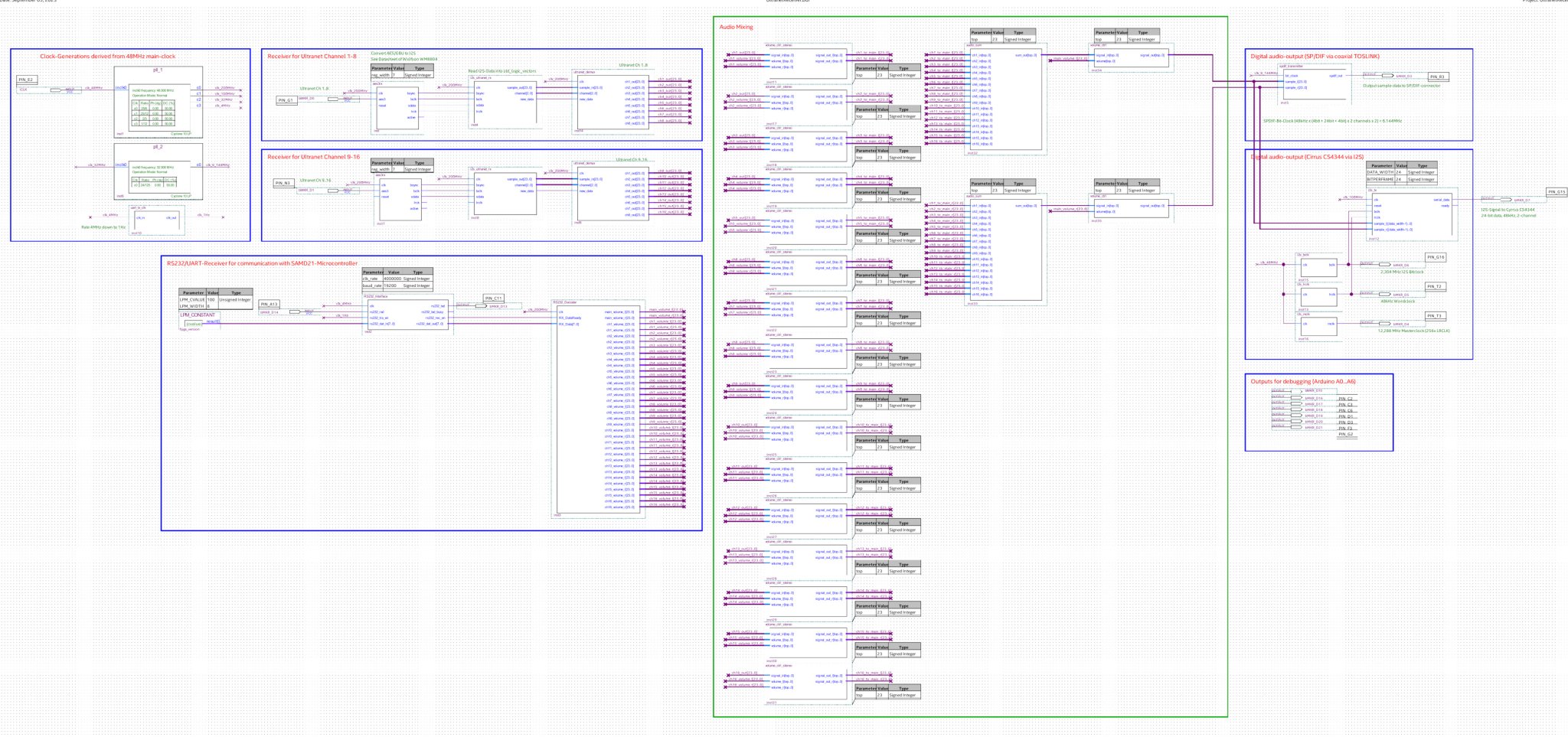

I'm working on a FPGA-based audio-mixer using the UltraNet-protocol. Goal is to create a simple audio-mixer to control via Arduino. I'm using the Arduino MKR Vidor 4000-platform with an Intel Cyclone 10LP. Here are my first steps on GitHub: https://github.com/xn--nding-jua/UltranetReceiver. Maybe someone has interests to come on board?
This is my work up to now:
So I'm receiving the UltraNet-Data using a MagJack SI-52008-F, feeding the data to an AM26LV32CD and then bringing the data to the Intel Cyclone 10LP FPGA on the Vidor 4000. Here the UltraNet data (8-channel AES/EBU) is received, converted to I2S, then put into 8 individual std_logic_vectors and from then on I can do everything I like. At the moment, the received samples are sent straight to a CS4344 Audio-DAC via another I2S and to a Stereo-SP/DIF (TOSLINK) adapter.
I'm in a very early state and up to now it is not tested yet. Is anyone interested in participating?

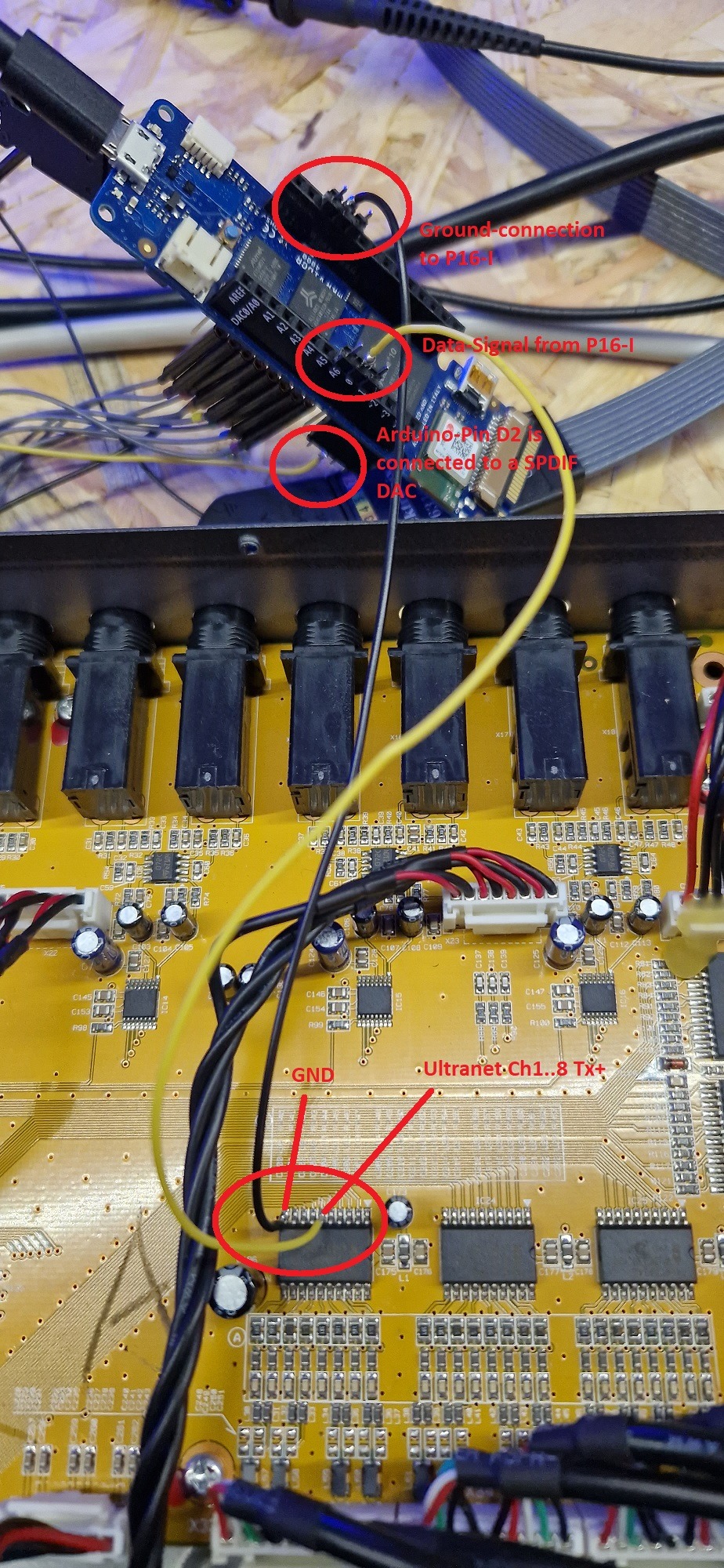

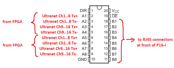

yesterday I tested my VHDL-code and it worked! I had a P16-I for testing and soldered the Arduino MKR Vidor 4000 to the PCB directly for testing. Behringer is using a SN74LVC245AD Octal-Buffer between their Onboard-FPGA and the RJ45-Interface. So I connected my Arduino to Pin 6 (labeled "A5") of the first SN74LVC245AD and connected a P16-M to the first RJ45-connector to enable the output (green LED at the front turns on).
Then I had to increase my FPGA to 200MHz to decode the 192kHz bitstream without noises - 100MHz is working, but I had some noise there, So the code is working and I can decode all 16 channels to 16 individual std_logic_vectors. I still have some problems with the risetime of the signal when connected to the Arduino-board. Maybe I need an additional buffer here to increase signal-strength but for now it is fine for testing.

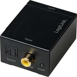

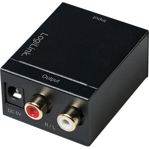

To test the signals I connected a simple and cheap TOSLINK/SPDIF-converter with coaxial-input to the arduino directly without any converter or buffer:
Two of the 16 std_logic_vectors are fed into the input of the SPDIF-tx-vhdl-block and I got clean audio at the analog-connectors.

the system is now running and I've uploaded everything to Github. If you own an Arduino MKR Vidor 4000, you can start without installing any additional software.
Some bulletpoints on what this thing is doing:
  • FPGA contains working decoder for two Ultranet-Streams with each 8 channels of 24-bit audio-data
  • FPGA has a 16-channel audio-mixer with left/right- and volume-control sending to a stereo-main-bus
  • FPGA receives volume-control-commands from microcontroller
  • Microcontroller can be controlled with simple ASCII-commands via USB (or ethernet if you hook-up an Ethernet-chip). I included MQTT-support as well.
  • The FPGA-bitstream is included in Arduino-Sketch (bitstream.h) and will be uploaded to FPGA on each start of the microcontroller via a JTAG-emulation

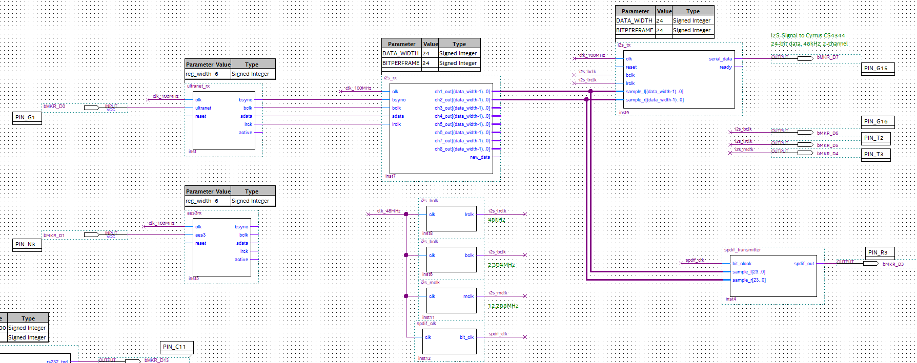

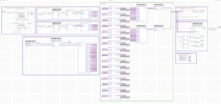

The control-commands and more information can be found on the Github-project-page. I've attached a picure, how I connected a P16-I to the Arduino MKR Vidor 4000 - its very easy if you have a non-working P16-device at home 🙂. On my P16-I the RJ45-connectors are not working anymore. So now I have a second-life for this device.
The second attachment shows the FPGA-part. After receiving the Ultranet and decoding into 24-bit-std_logic_vectors I'm doing some simple audio-mixing and perform the output to the SPDIF-interface. The Cyrrus CS4344 via I2S-output is not tested, yet.
If you have any idea, what can be done with this, feel free to let me know. For me it was more of an exercise to see if I could read the data at all ;-)
So you ended up bypassing the RJ45? Please check the small (51 ohms or so) SMD resistors in the outputs of the buffers. It's common failure probably caused by people thinking the outputs are for usual ethernet connection, I've got a second hand unit with some burned resistors, too.
