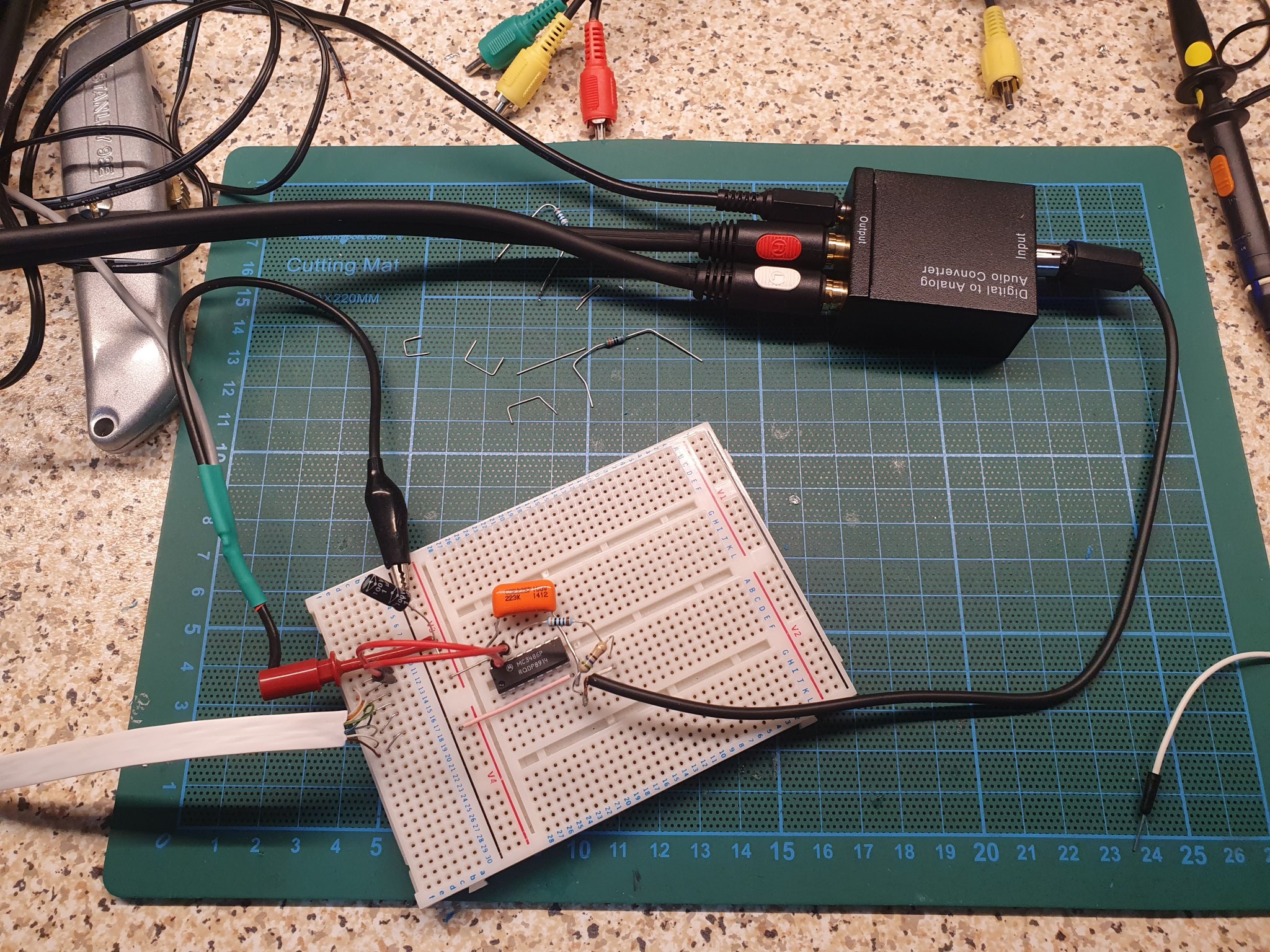

Hi, I've just had some success in decoding Ultranet into analog audio, using cheap S/PDIF devices as found on amaz... etc. My objective is to run Ultranet digital cabling to remote speakers, to save using long analog cable runs.
I used a commonly available RS485 differential decoder IC (MC3486) to convert the Ultranet signal into a single-ended stream, then a simple resistor divider to drop the 5v ttl output from the receiver buffer to 0.5v for the S/PDIF input of the DAC. What came out was clear audio!! The resistor divider is simply a 300ohm series and 56ohm parallel, to drop the voltage sufficiently. The DAC I used was the cheapest I could find - around £5 (I didn't want to risk expense in case it didn't work, and I figured the cheap units wouldn't be too fussy about the encoded datastream).
The only drawback with the device I used is that it ignored the difference between frame headers and the packet header. The Ultranet PCM data stream has 8 channel frames in a packet, but the DAC summed all the even and all the odd frames into the L and R outputs. So in order to get clean L and R analog audio out, I needed to set the routing in the mixer to connect the L source channel to Ultranet channels 1,3,5,7 and the right source channel to Ultranet channels 2,4,6,8. So I needed to dedicate 4 ultranet channels to each analog output. This would work for me, but is a waste of Ultranet channels if I also wanted to use P16 monitors. So my next experiment is to use more expensive S/PDIF DACs (around £11) and a 5.1 surround DAC, with 6 outputs (around £30). This unit is already separating the frame and packet headers, so it may enable me to isolate a single Ultranet channel for each speaker (I'll need two of these systems; one for each remote speaker).
These new devices are on order, so I'll let you know whether they work!

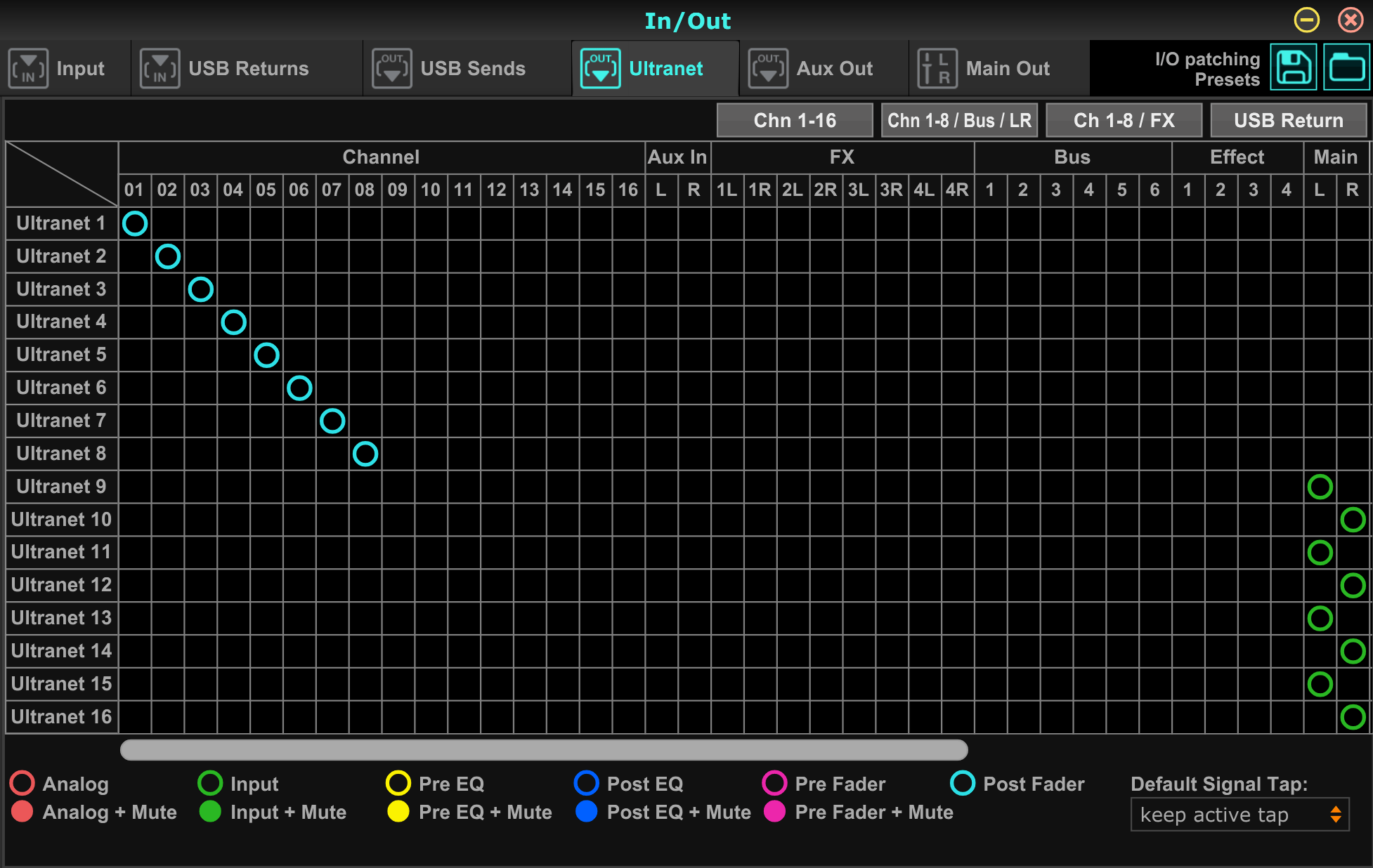

Further to the above, here's the mixer routing page (In this example I'm using my XR18) showing how to get the main L/R outputs onto the second twisted pair of the Ultranet port. As we know from the above thread, the Ultranet cable is Cat5(,e,6 etc) in which the first two twisted pairs are two groups of 8 channels, and the second two are power and ground. BTW, the power supplied by my XR18 was 5v, but at very low current - not sufficient even to power the MC3486 chip (which needed around 50mA).
