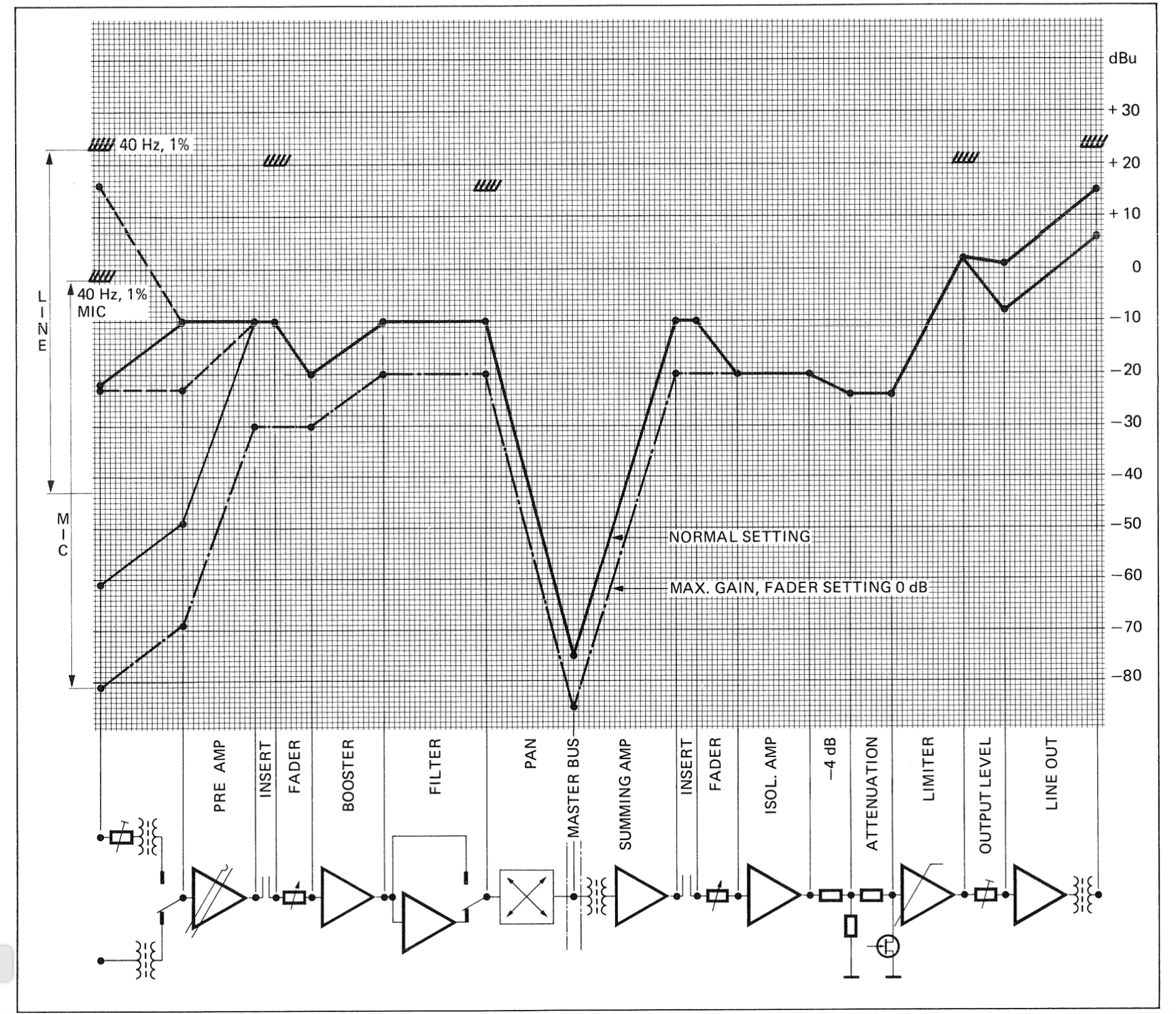

A gain structure diagram shows all the gains and losses in a mixer. I have one in a service manual here, if I get time I’ll scan and post it so you can see what I’m talking about.
  • Thank You
Reactions: roboDNA
Here's a gain diagram for a Studer 169 desk. It happens to be a manual I have on hand, having rebuilt one of these. To read, pick a point on the line, and read to the right (signal flow is left to right). Note the difference in level between two points, the difference in dB indicates the amount of gain or loss in that stage. Unity gain is represented by a horizontal line. You will see horizontal lines at insert points (send and return are at the same level unless a device is inserted), and at faders on the maximum gain plot (because they're all the way up), and at an isolation amp. The horizontal gain line at the filter is a little misleading because if you use any EQ, it's no longer flat, but is here shown with no EQ applied. Note that the gain/loss is up and down through the entire signal path. If it were truely "unity gain", that would have been a level horizontal line from left to right.
I realize this isn't your mixer, and mixers vary, but they all do something similar. None would ever plot a straight horizontal line in a gain plot.
  • Thank You
Reactions: roboDNA
