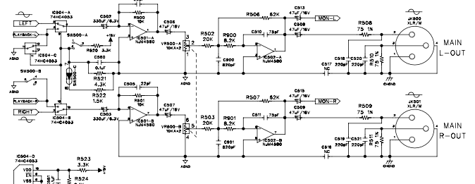

Soundcraft max output: +21dBu = 8.7Vrms. Make it so that its maximum output level is 4Vrms/2Vrms (depending if you use XLR or convert to RCA) and you have solved your fear.
Not familiar with pads and pro stuff but please note the output impedance and drive capability of that mixer are both pretty good. Anything added behind it will not make things simpler and better but worse. Don't add, just solve stuff a good way for your custom situation. You created this by wanting a normal amplifier connected to pro gear. You can't bake a cake without breaking eggs.
Now please calculate R506 and R507 for 4Vrms/2Vrms output. Homework 🙂

RoboDNA, please confirm:
1. the fear that the F5m will be defective by exceeding its absolute maximum 3Vrms input level.
2. also that the F5m is connected directly to the 8.7Vrms mixers outputs without having its own volume control.
Apparently my reading skills are not pro and I want to improve that. If the answers to items 1 and 2 are both "yes" then the 2 resistor change is the cheapest and most effective solution. If insecure you may even solder resistors over the existing ones. Easily modified back to pro levels.

There is a final gain stage that can output 9Vrms connected with a straight line to a device that does only tolerate till 3Vrms. Reduce the gain of the final stage while keeping its now low Z outputs and all is good. A simple test to prove I am a total idiot or not is to solder 62kOhm resistors over the existing R506/R507 ones.

^^ I have not had time to implement the solution just yet... I'll be adding a couple of PAD resistors for each channel inside my case. I'll hard-wire them in without a switch for now until I decide on other things like maybe building a couple of new monoblock amps ( F5mX ) I also like the idea of getting the Mackie mixer with differential balance AND monitor RCA outs which I would use for the F5m amp without the need of the PAD. I may build the monoblocks with differential balanced XLR cable inputs for 4dBU level and a RCS inputs for -10dBV level. ( no need for a switch )
@jean-paul I'm curious, what would you suggest the best solution would be? ( if it's not the same as what I'm considering ) Other than replacing the equipment or adding the pad, is there something I've not considered that you know about? ( sorry if you already mentioned it... )
If your suggestion is to modify the mixer's 2 resistors, I do like that idea but think I may need the mixer for pro audio level uses in the future. I see what you mean about fixing the 'source' of the problem which is the mixer. The Mackie mixer does pro and consumer levels and has differential balanced XLR which my soundraft does not. That is the best solution I think, and if I did not already have the soundraft, I would have pulled the trigger on a Mackie mixer. My Mackie MR-8 studio monitors ( Class A-B ) sound amazing and they really thump, so I'm happy with Mackie..
