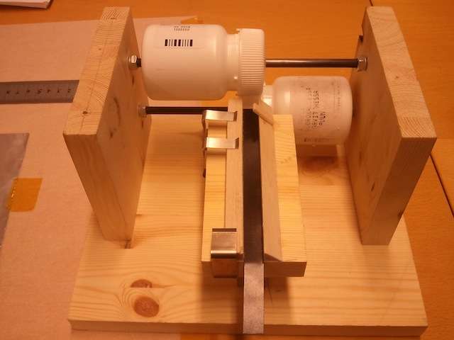

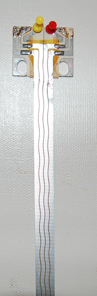

For my 1"x45" ribbons some years ago, I experimented with several foil patterns...plain flat foil, corrugated, foil pressed with patterns (window screen & fabric patterns). The main difference was that corrugated ribbons did not "twist in the gap" as much as the others when driven with strong LF signals...so corrugated was selected.
For resonance control, the ribbons were suspended from wool felt pads at the ends and at the 1/3 length points.

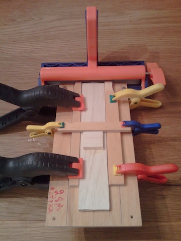

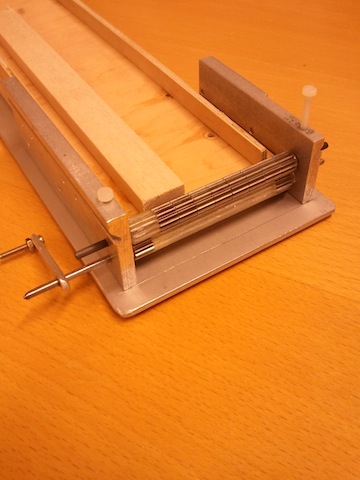

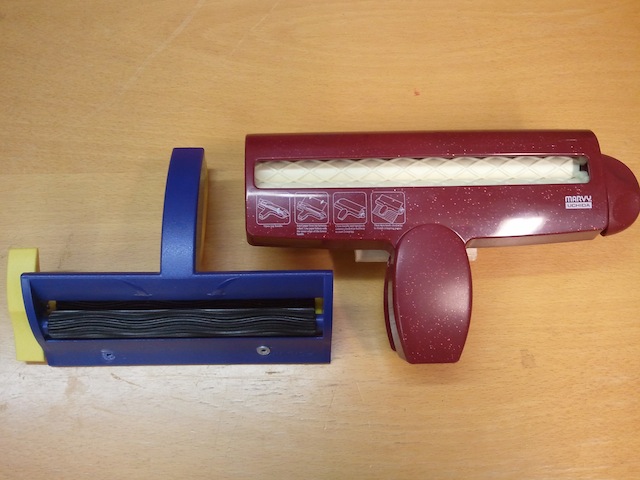

Here's my contribution to the corrugator show.
Never guess which one was my first?
I would very much like to find a finer pitch corrugator roller.
None of mine can produce the fine pitch of Apogee Scintilla midrange.
Well, I can always make one e.g. by 3D printing..

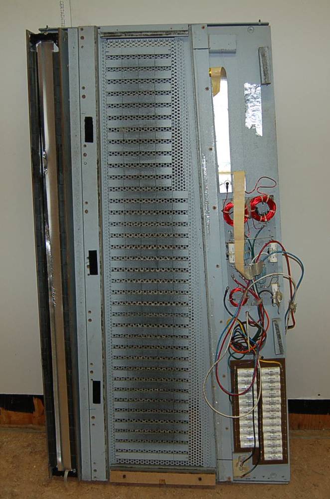

Exactly right. The one on eBay is the only one I've seen that looks right for the corrugations for the MR and TW. I've looked at quite a few of the paper crimpers, and they all have quite wide corrugations, not even close to the Apogee. Those dough rollers posted a few above look promising. I'll search that out a bit
DahlbergAudioDesign site has great info for ribbon builder. He has a fine pitch corrugator:
http://www.dahlbergaudiodesign.se/del3/images/korrvals.jpg
Thanks AudioquestM-40 for the corrugator ebay link. Well, it doesn't look like a fine pitch corrugator but I can always ask it from the seller.

I have couple questions about arranging magnets when constructing ribbon tweeter.
Here's a link http://www.saunalahti.fi/~hellmann/index_files/DiskanttiProto.PDF to a 3D pdf-file.
Is that correct way to arrange magnets?
And the other question is how do you manage put the magnets to rows so that they're touching each other without using glue? Does it have something to do with shape or are the polarities flipped?
This is the way you are supposed to mount them if you are going for two rows.
They absolutly do not want to sit like this so it's quite a struggle to mount them.
They will repell (with significant force since there are a lot of them) sideways
and be attracted by the ones on the other steelbar.
If you are unlucky they can actually flip and jump to the nearest magnet and sometimes
breaks when doing so as well (buy a few extras).
I used to use a rubber strip squeezed in between the magnets to prevent them
from rotating in place, they need to be able to rotate to flip so.....
Now I'm gluing all magnets with slow hardening 2-comp epoxy since I came to
the conclusion that I would never remount any magnetsystems.
