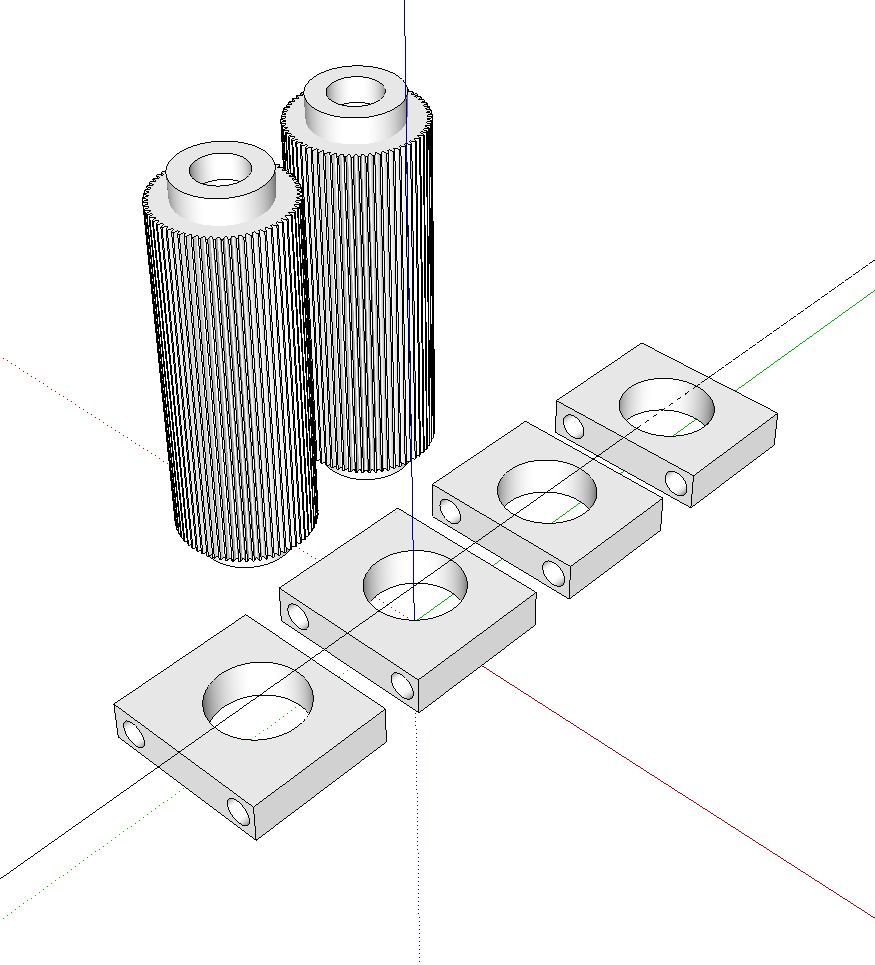

I used Sketchup for modelling the corrugator. A gear drawing plugin is available on the web.
Trimble SketchUp
Shapeways material called "Frosted ultra detail" is good for fine detail printing.
3D Printing in Frosted Detail Plastic on Shapeways

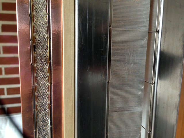

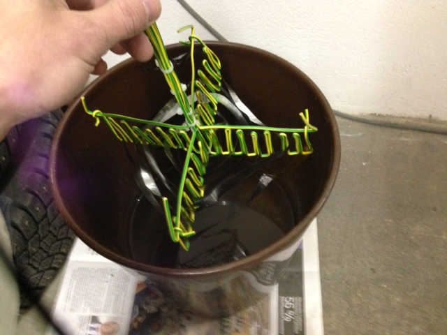

Hi all,
I haven't had any luck in finding thinner than 6.5um foil.
so I started thinning down my foil with simple etching process (I used a strong alkali solution). See pic..
The results are as expected. Thinner foil has less resonances in 2 - 8kHz range.
Regardless of foil thickness, embossing seems to be more effective way of killing 2 - 8kHz resonances in pure alu tweeter ribbon than corrugation.
I wouldn't like to repeat the etching, and I woudn't recommend anyone to try it.
So a hint or a tip of thinner foil source would be very welcome, thanks.
