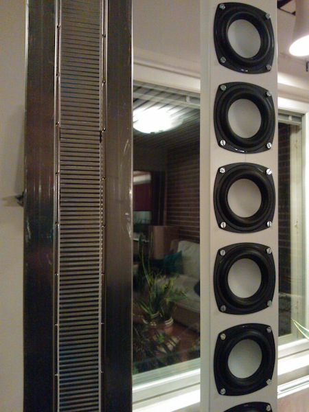

I have attached a picture of my 40mm wide / 11um thick ribbons that seem closer to Soulsonic corrugation style. They also have resonances that can be heard with pink noise test and seen in measured frequency response.
Any tips where to get 40mm wide and about 8um thick alu foil?
My foil/film capacitors that have 8um foil are only 10mm wide.

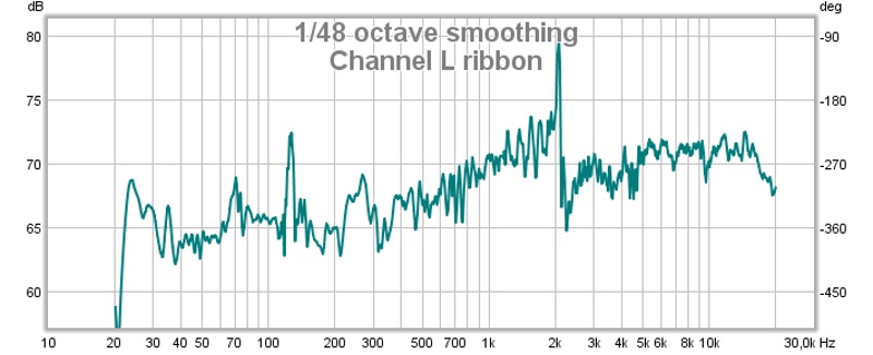

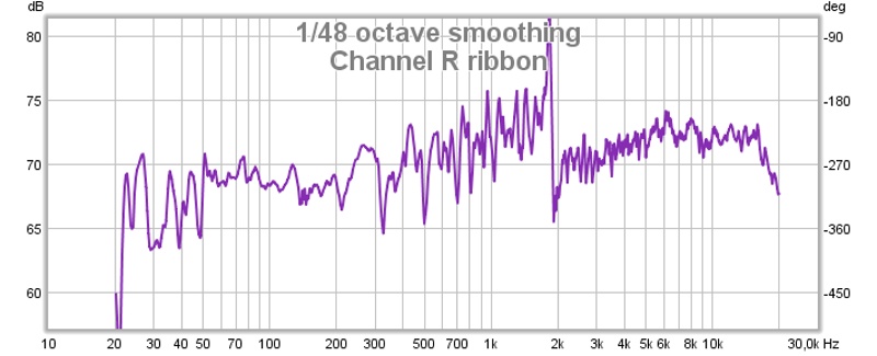

While waiting for the book to arrive, I took frequency response measurements from left and right channel ribbons. Below are unequalized ribbon responses.
The measurement mic was 10cm distance from ribbon.
Anyone care to comment about the ~2kHz resonance?
My differently corrugated ribbons all have this kind of high Q resonance. Only the frequency and amplitude varies. Ribbon tension affects to the resonance frequency and amplitude.
I think the resonance is caused by the cavity between the two rows of magnets. It is very much like the cavity resonance of the Carver ribbon drivers (that are not true ribbons). The Carver's resonate at a higher frequency 7-8 kHz as the slot is narrower.
How did you measure the frequency response? It seems to be made at a low SPL. Are they really going that low in the bass? That will require very large excursions of the ribbon at higher SPL and probably "polute" higher frequencies.

I tend to agree with Roger but I'm surprised that the frequency shifts when the ribbon characteristics are changed if the resonance is a characteristic of the magnet gap. How much does it change? Small shifts might be explicable in terms of changes in the cavity but if it shifts by KHz I may have to rethink my assertion that the magnet cavity is the culprit.

The measurements are made with Room EQ Wizard software and the microphone is according to instructions at Linkwitzlab. Such a great site!
The measurements were performed with low volume, mic was 10cm away from ribbon surface.
I have learned that narrow ribbon without a baffle can't produce the needed SPL at bass frequencies, so the equalized acoustic response is first order high pass filter at 200Hz. (I have also a steep high pass filter at 80Hz to remove the ribbon excursion)
I can make and post frequency response measurements with different corrugation styles.
That should tell if my problems are caused by cavity resonances or ribbon resonances

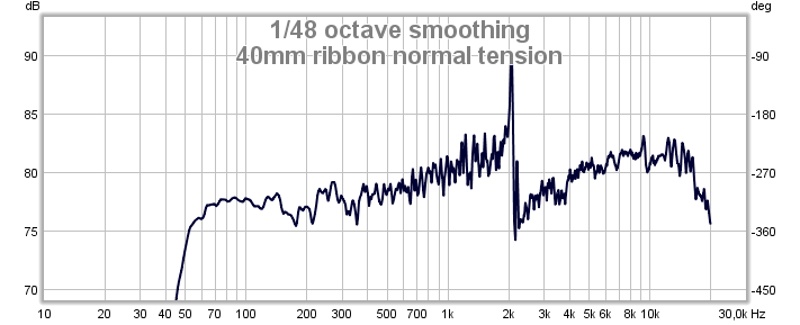

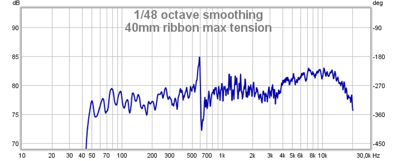

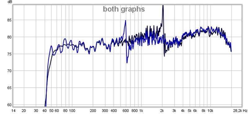

So here are two measurements (high pass filter used, measurement distance was 10cm). No other changes except ribbon tension is increased.
The normal tension measurement is performed with the pink noise test tuned ribbon tension.
And the max tension measurement is performed with even more increased tension so that the corrugations flatten out almost to a flat foil.
So it seems that the about 2KHz resonance is due to corrugation, not due to cavity resonances.
Another fact that supports this theory is that my ribbon headphones have exactly same phenomenon even though they have totally different construction and different materials.
Hopefully the book arrives soon and I will learn more..

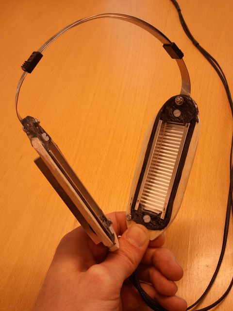

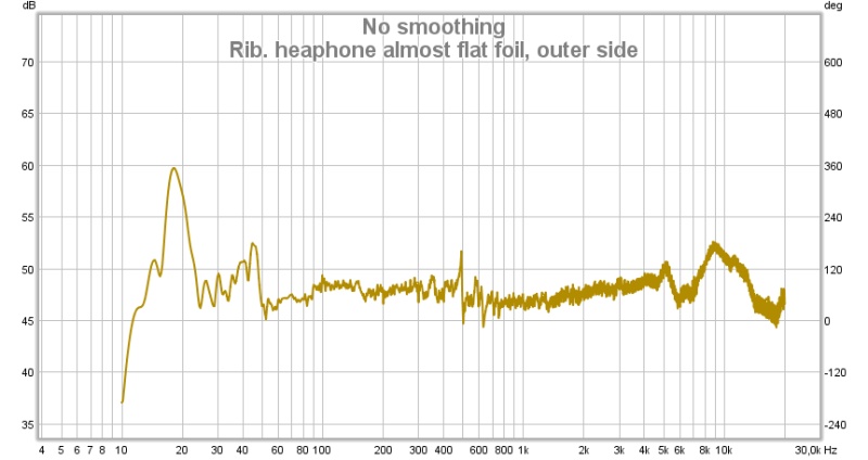

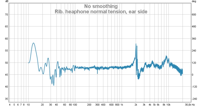

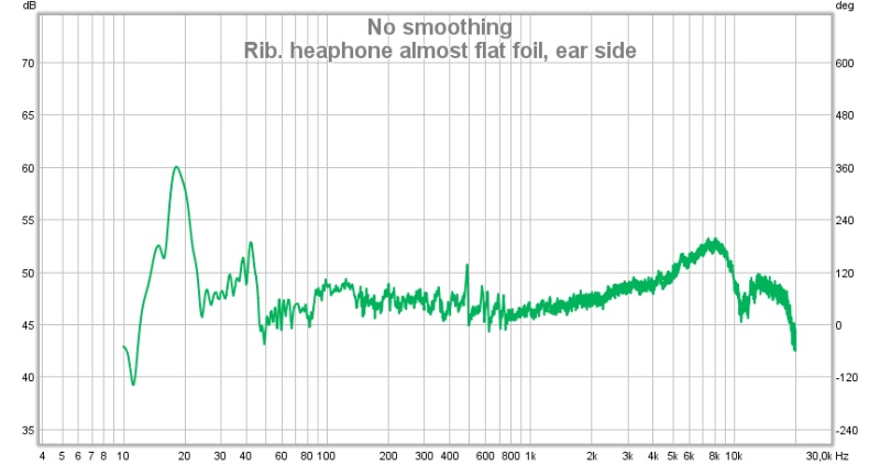

Here are some more measurements. These are from my ribbon headphones with 6um thick capacitor foil.
Measurement distance is 1cm away from ribbon surface.
Measurement graphs show the same phenomenon as my previous post. The more ribbon tension is increased, the more corrugations will be flattened and the resonance diminishes.
Graphs also show the ribbon fundamental resonance frequency that is under 20Hz.
I guess this proves that the resonance is due to corrugation?
