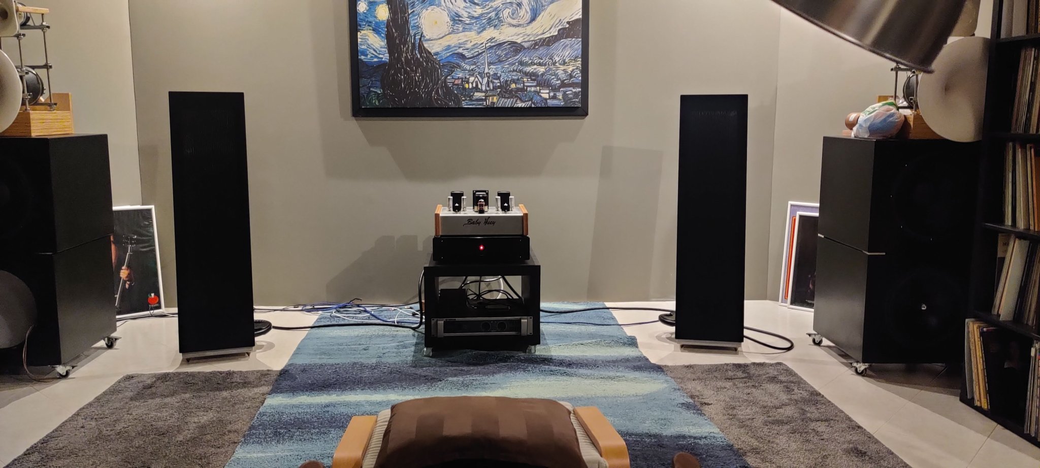

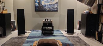

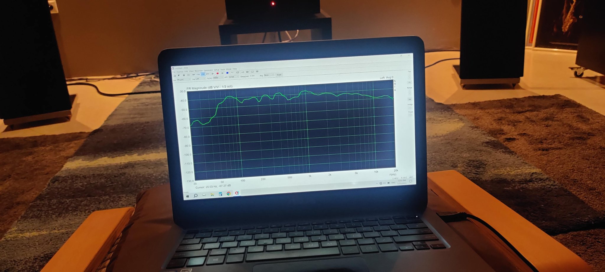

I recently bought a pair of LRS+, just to try some panel speakers. Had that itch for a long time, as my first serious speakers, 33 years ago, were ribbon planars.
At first listen, I thought that I was listening to a midrange! After some break in (they need some more) and messing with speaker and listening position, I manage to make them sound decent on their own. They now sit 80 cm from the back wall and 3 meters from me. Tweeters on the outside. Of course they need some help on the bass and I have plans to make an open baffle bass,to be used as a stand for the speaker too. Some sort of SLOB from the Pass forum. I have a few 12 and 15 inch to try. I am also waiting a Schiit Vidar 2 amplifier from a friend to try, to see if the low end will get any better first. I also have a Yamaha p3500s that I will try soon.

The LRS+ is a very small speaker. A much larger bass panel is needed to get any good bass output, so just adding a second LRS+ will not be enough.
I did this thing with my far larger 3.7's, where I added two 1.6's as additional bass panels. Even so, I cross over at 100 Hz to my subwoofer system....
I know it will not give much under 50hz. But some people are ok with that. And if they dont want active/dsp, it could do the trick. But agree I could not live with that . My next project will with 12, 12'' , and have seen your attemts at ob bass Holly Molly.

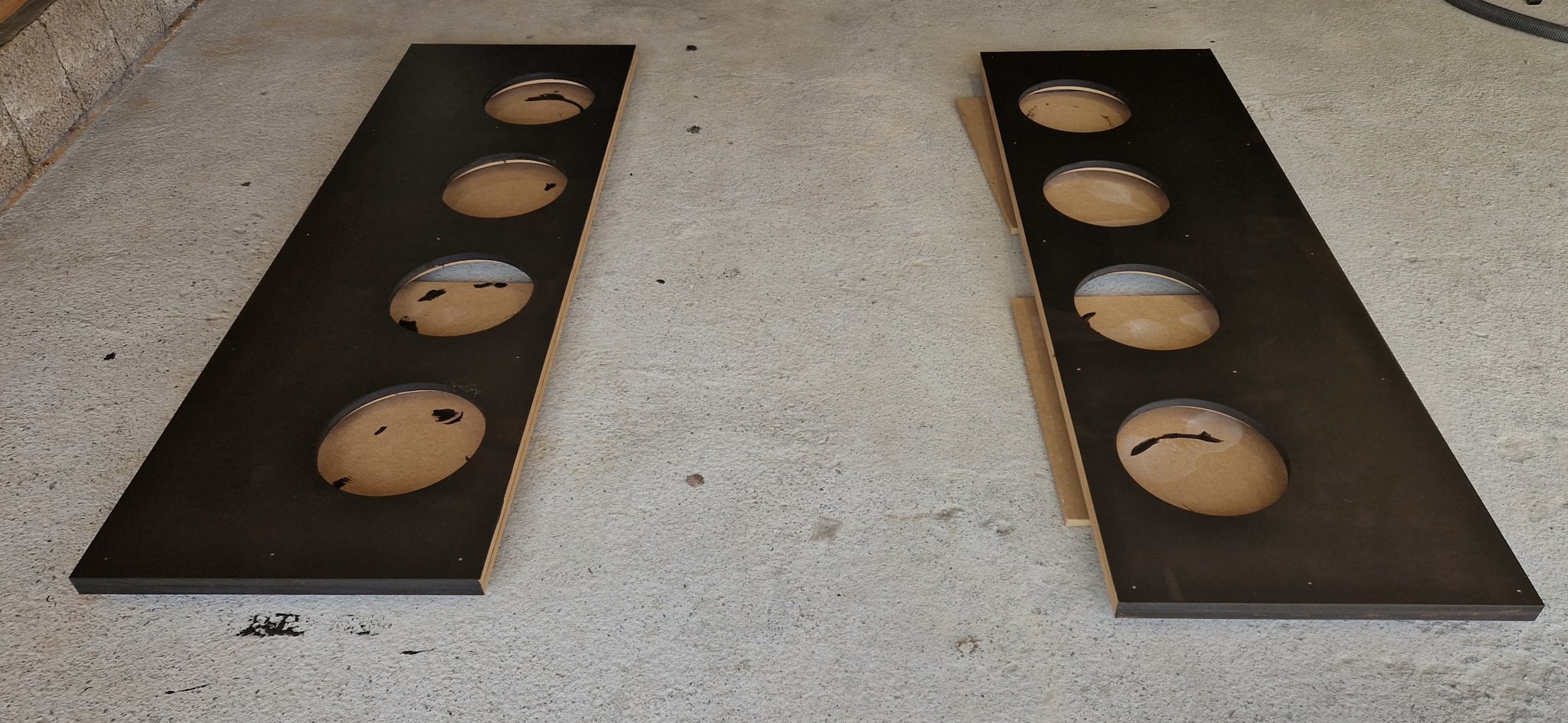

I’m working on a dipole midbass system for my Magnepan 3.7’s. I’ve found that the 3.7’s perform exceptionally well above 300Hz, but not below. They have limited SPL and distort quite a lot. The native frequency response of the bass panel also drops off below 300 Hz.
My midbass system is the same size as the 3.7, and is intended to sit right next to the 3.7 with the midbass drivers towards the 3.7. The same solution can of course the used with smaller Magnepans.
Here’s a pic of the baffles….
I've made an interesting choice - Eminence Delta 12B. They are really cheap drivers, but have one interesting feature - low Mms of 32 grams. In comparison, the higher end / high power 12" woofers typically exceed 100 grams.
Ok found the same problem. So been looking at a lot of drivers. Offcource AE but their price with shipping/told . Then their is sb acoustics ob12 ?. And maybe many sb20frpc30-8 where I can cut the whizzer off. This one looks ok to 60 Hz. I guess you plan too cross to a subwoofer?.
Four 12" in OB will not be a subwoofer anyhow, so this is midbass only. I plan to XO somewhere around 350 Hz to the maggies, and probably at 80 Hz to my large Double Bass Array.

I listen to Martin Logan CLS Z2 and they have a response similar to your posted response. What I have found that works well for me is a Martin Logan Depth I placed against the back wall and in my case centered between the 2 speakers. I run the Z2 full range and add in the sub around 45hz. I also like an older down facing Audio Concepts Saturn sub in that same position but it is big. I have heard various OB subs and IMHO they are really tough to place right and speed wise do not keep up with the panels.
