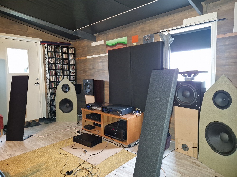

Yesterday I assisted in setting up a somewhat odd bass solution for those LRS+ speakers - a 15" Eminence Alpha in OB and a 12" ScanSpeak in bass-reflex as subwoofer. We used a MiniDsp 2x4 HD and a Crown amp with DSP to do XO and EQ. It was quite easy to tie it all together. XO points 250 and 45 Hz. And what difference it all made! I'd have to say that the LRS+ with this bass system is one of the best speaker systems I've ever heard. 🙂

Yes, of course everything was measured, and appropriate EQ and delay applied to all speakers in the system.
Below a pic of the actual setup. As you can see, the maggies are located far into the room, and delayed 4 ms relative to the woofers.
The woofers are 15" Eminence Alpha that used to be part of a dipole speaker, and its Visaton B200 fullrange is still there above the woofer. The passive XO is of course removed, so the woofer is connected directly to its amp. The subs are ScanSpeak 26W/4558T00 in bass-refleks boxes. It looks like DIY, and it is..... stuff like this warms my heart 🙂 And it sounds absolutely amazing!
The room is very well tuned with absorption. The decay is quite short over the entire frequency range, even in the the low bass.
Amps:
Parasound (might be A21, not sure) for the maggies
DIY ICEpower 1000ASP for the woofers
Crown XLS 1502 for the subwoofers
DSP:
For the maggies and woofers - MiniDSP 2x4 HD
For the subs - in the Crown power amp
