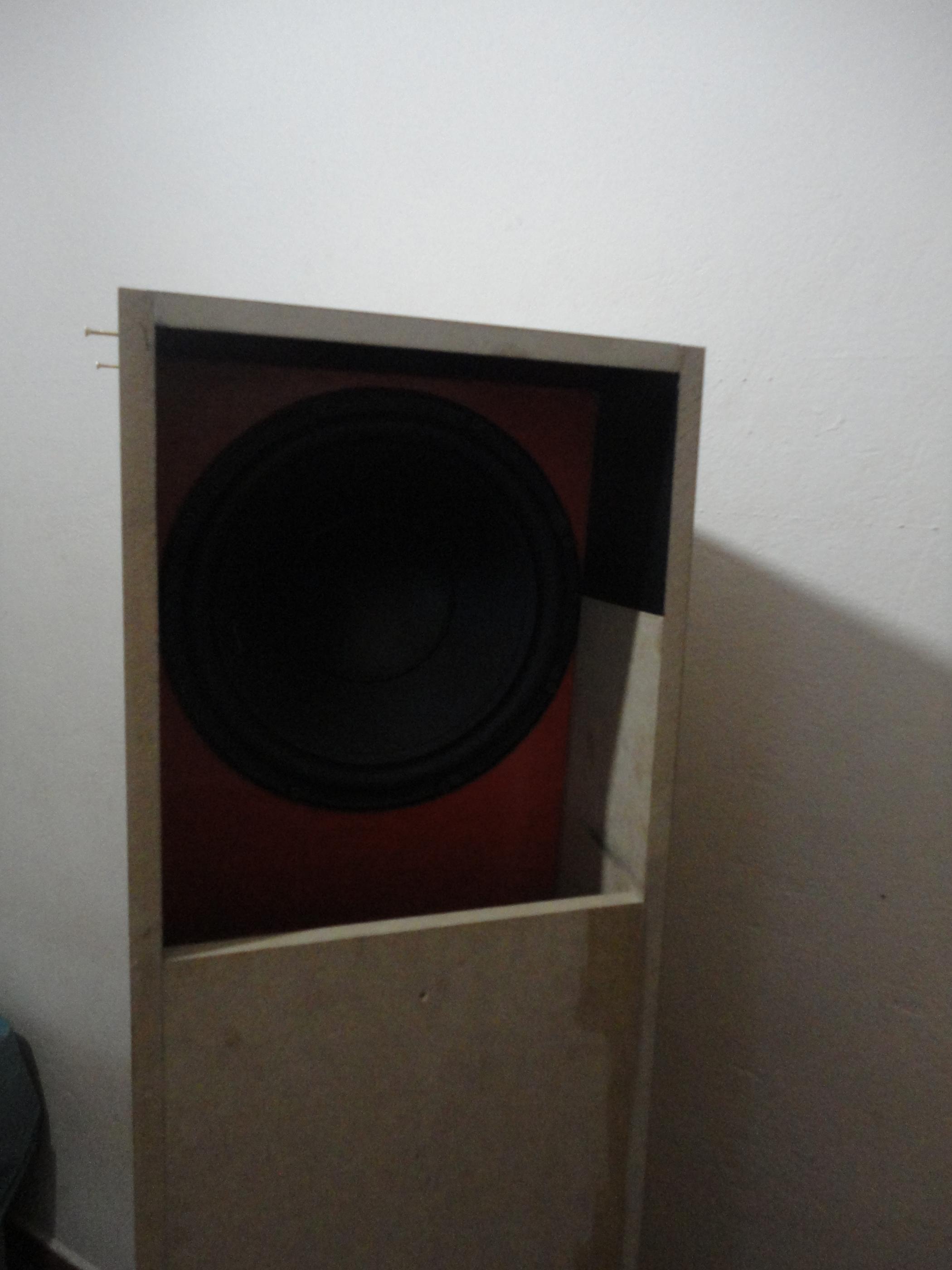

I'll do an experiment:
glass wool in parallel, and in between, blanket synthetic.
Perfect lining using felt..
..But it looks like your 'synthetic blanket' is folded(shouldn't as the bend will be too dense, thus attenuating to much also if the 'blanket' is compressed) and is filling up the entire left out volume in the picture: DSC02895.jpg,~50% is enough.
The Glass-wool looks also denser than necessary:You may have to remove this if the box becomes over-damped.
Prior to gluing the box-panels air-tight:
Use wood-clamps and do a listening test(or perform a measurement) to find out the sonic impact, if necessary to adjust the filling.
b :)
b :)

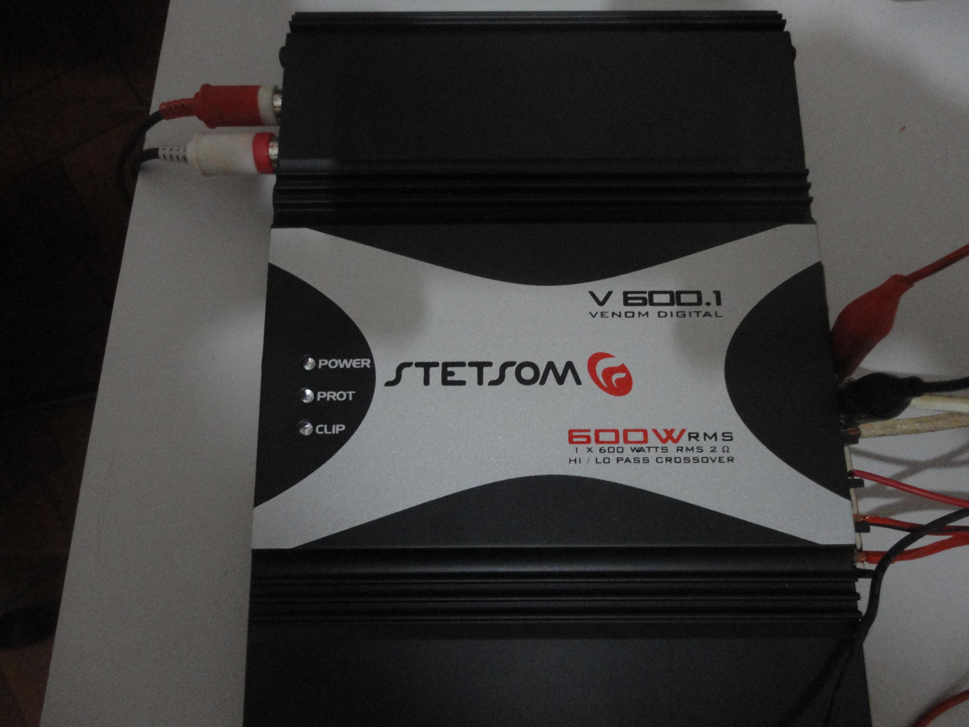

Well, it's hard to find an amplifier with output of 3 ohms, I'm considering getting a automotive module as this model below. Considering also the value is low. Here in Brazil U.S. 110.00.
http://www.stetsom.com.br/eng/DetalhesProduto.aspx?c=8364&cat=4639
Well, in this case, I will have to acquire a source of 12v to 14v with 50 amps.
I thought this fountain, where the seller assured me that will supply the amplifier.
http://www.aliexpress.com/item/600W...y-for-LED-Strip-light-AC-to-DC/621228646.html

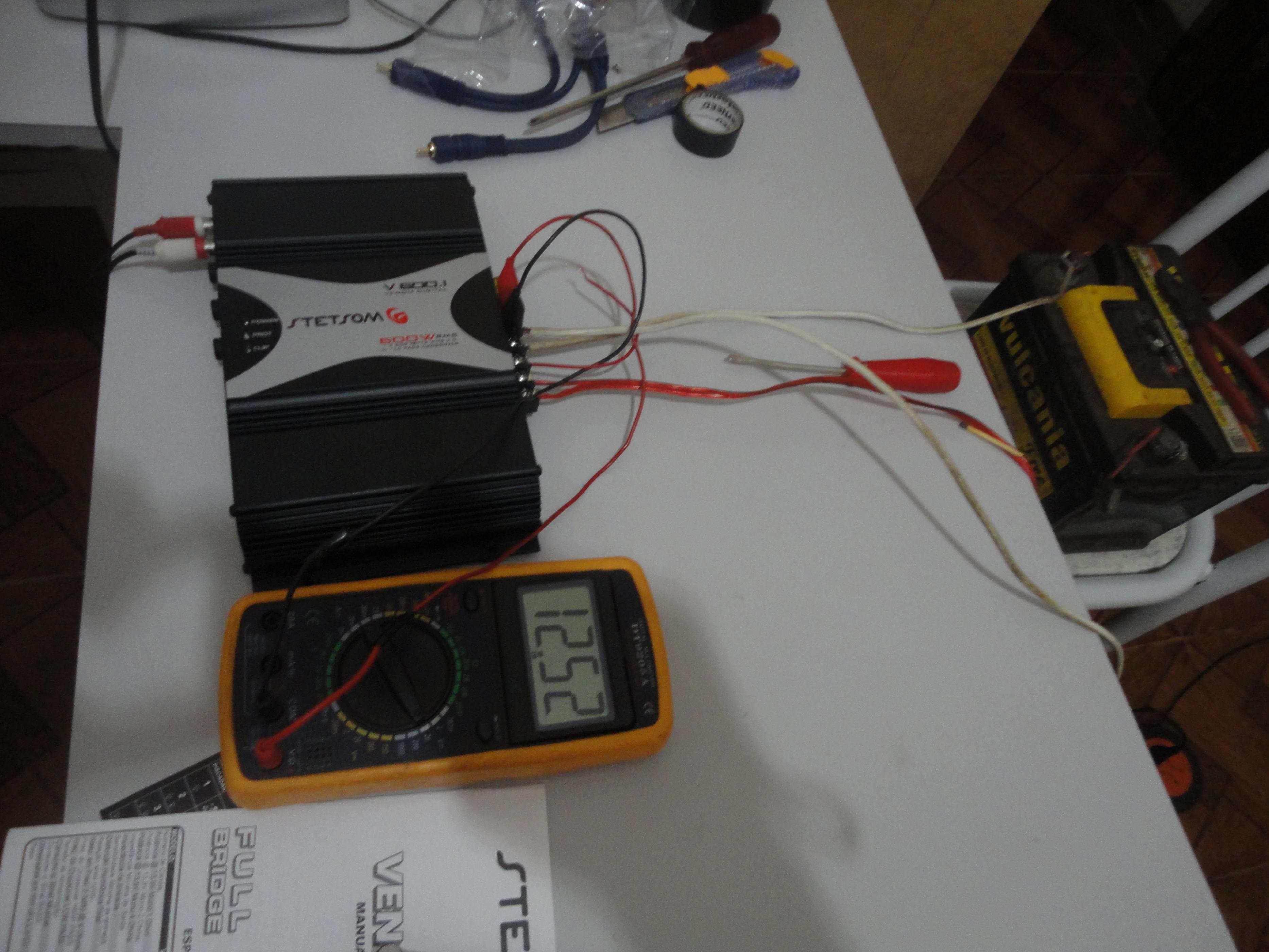

As I was anxious, I called the module in a car battery yourself, of course, with a safety fuse.
The source was not from that link posted above, but this one below:
Wholesale Product Snapshot Product name is Free shipping,New 600W 12V50A Switching Power Supply For LED Strip light,220V/110V AC input,12V output +more DHL Free shipping
Below is the photo of the tests.

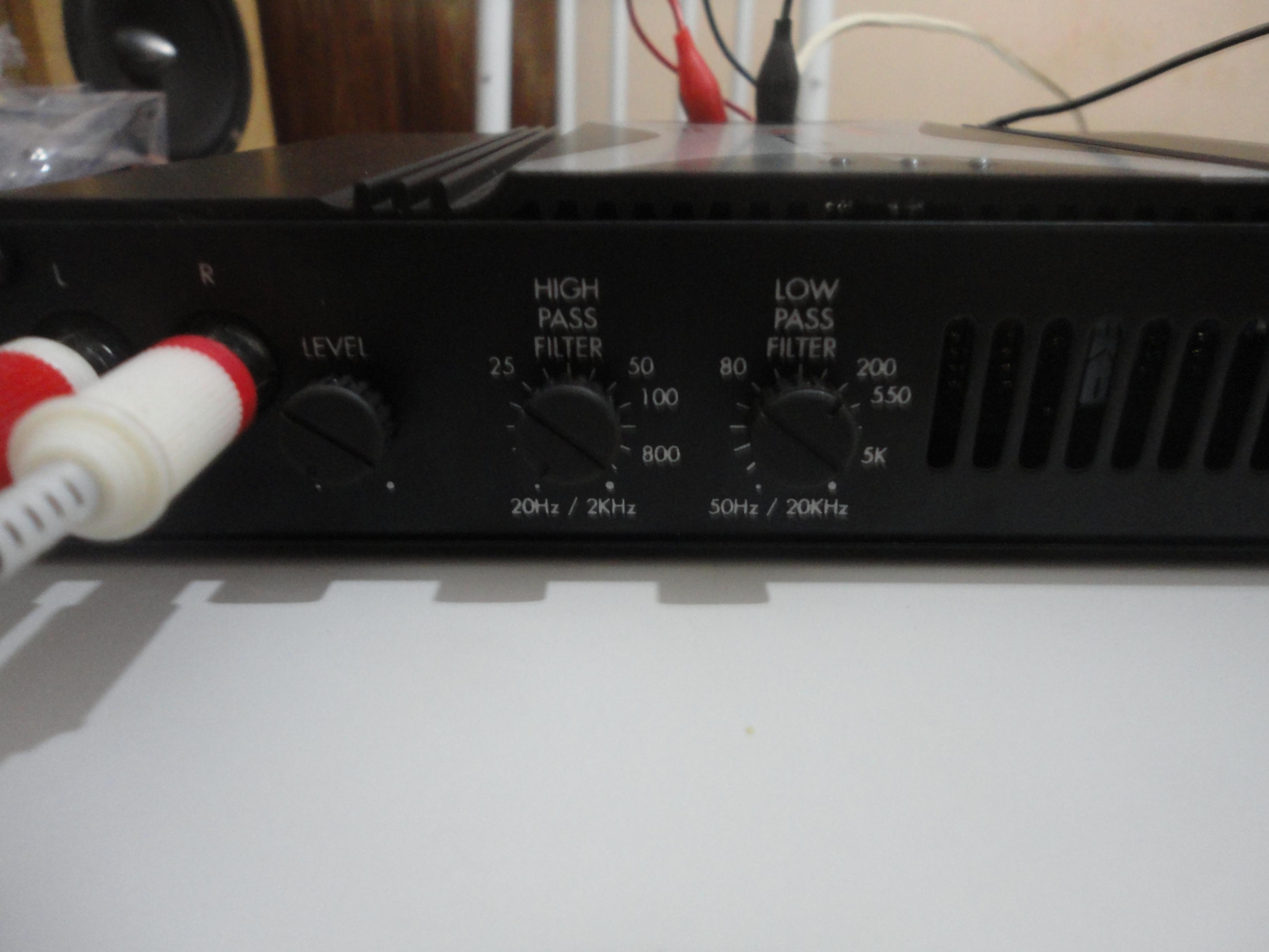

reminding the specifications of the subwoofer:
POTÊNCIA RMS: 300-400watts
IMPÊDANCIA: 6+6ohms
SENSIBILIDADE: 88db
Revc=2.300 Ohm
Levc=889.758u H
Fo=28.582 Hz
Sd=53.093m M²
Md=44.000 g
BL=9.648 T·M
Qms= 6.989
Qes= 0.532
Qts= 0.494
No= 0.440 %
SPLo= 88.5 dB
Vas=103.554 Ltr
Cms=258.705u M/N
Mms=119.852 g
Mmd=105.783m Kg
Xmax= 13mm
* Based on the specifications of the subwoofer, which would cut the correct settings on the amplifier STETSOM venom v.600 2ohms?
High pass filter?
Low pass filter?

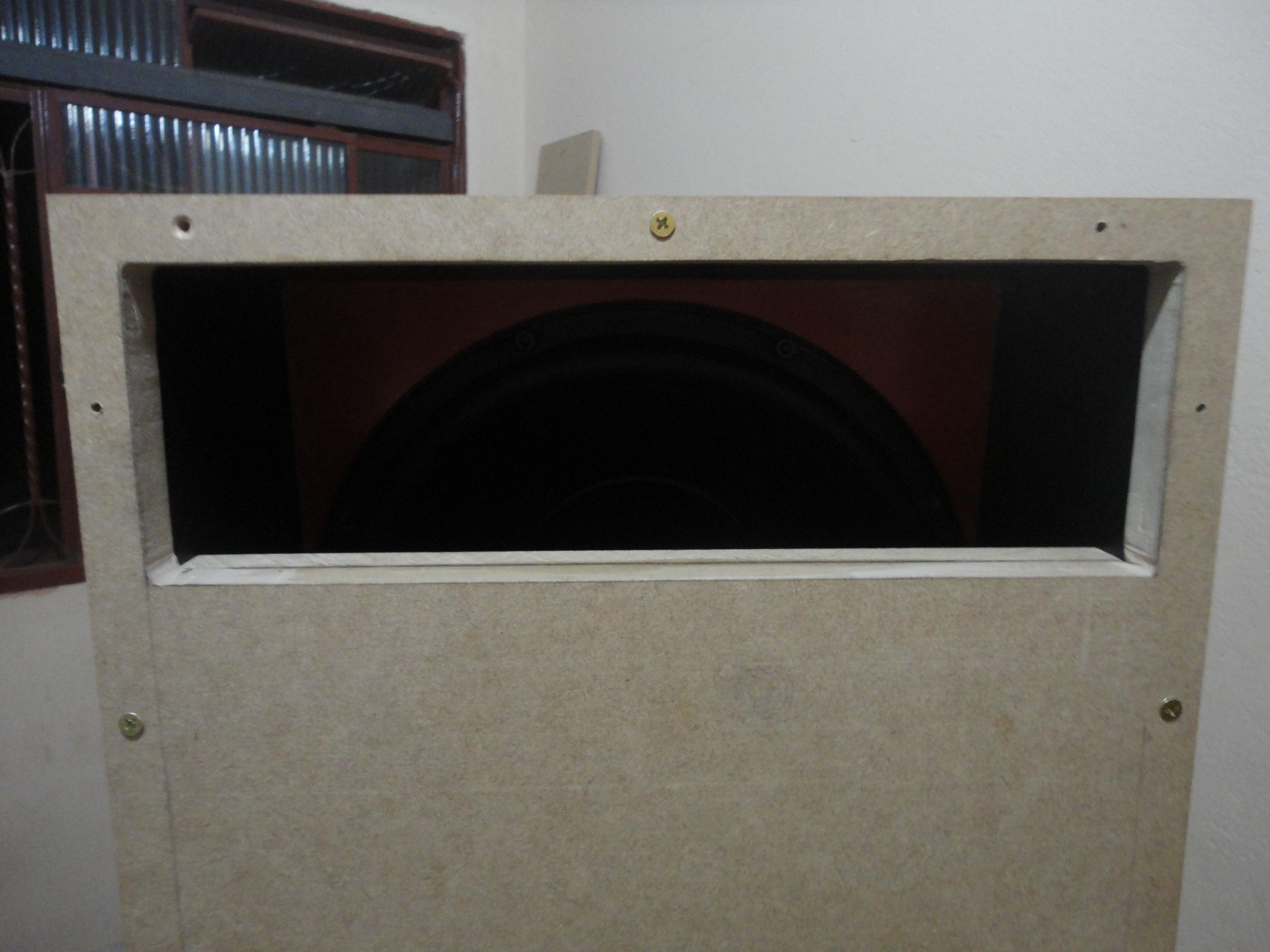

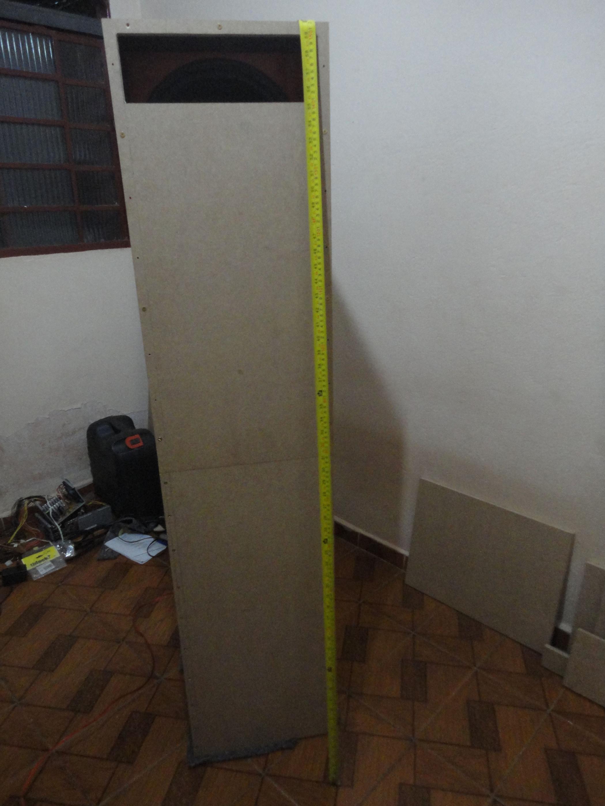

Okay, now finished internally. Have pasted everything.
Missing only external painting
As for playing, is playing extremely well.
It took work to do, gave!
But it was rewarding.
Nothing is paid for a job you do the same, especially with affection and with much care.
I thank you all, and a special thanks to Björnö!
