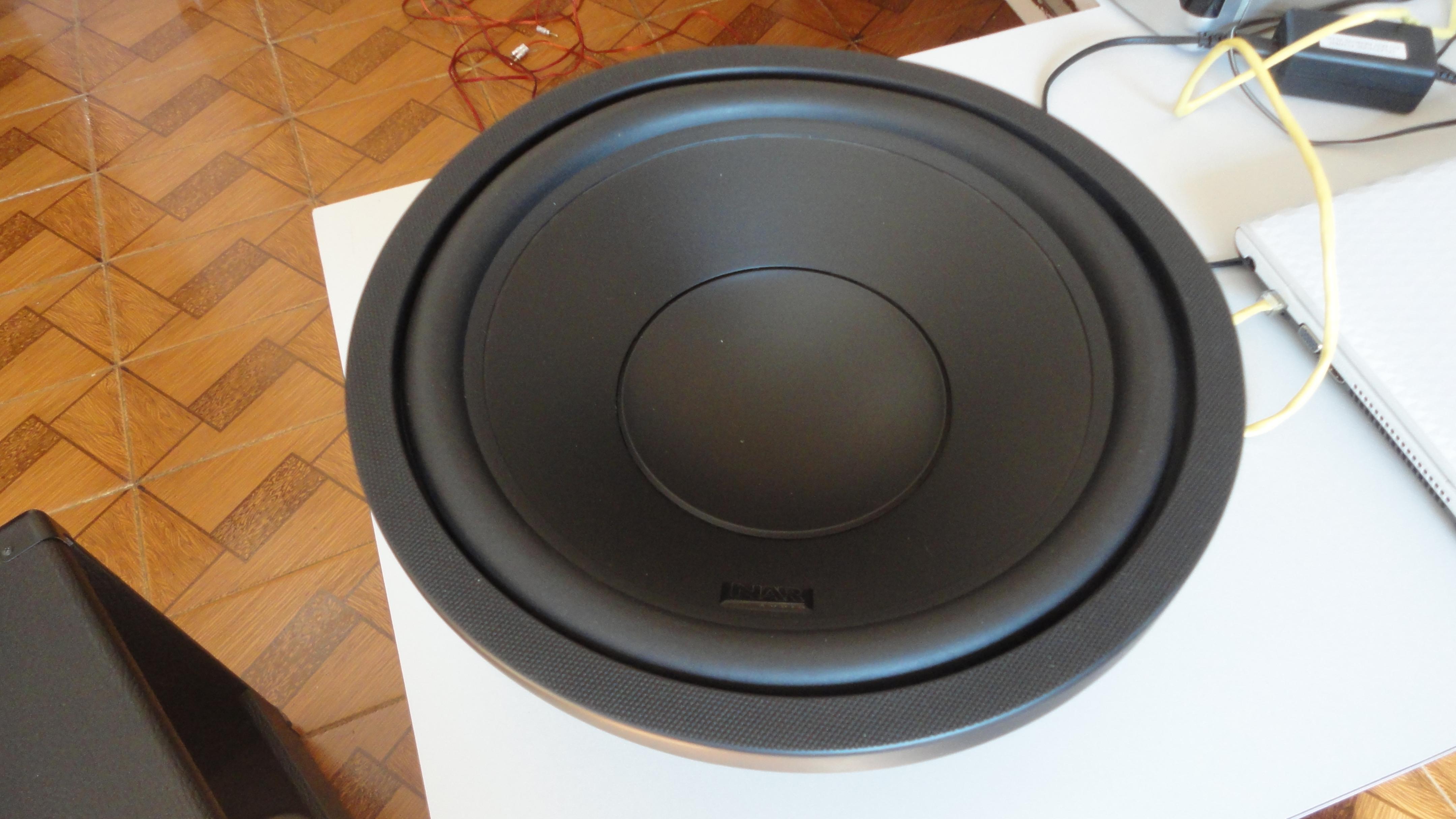

new driver NAR
Bjorno when he finally managed to keep all the cash to make the subwoofer, the speaker makes the NAR, is no longer manufacturing. Moved to this model, as follows:
Not wanting to abuse you, and considering that I broke the head to get the new calculations, I did not get anywhere.
You could calculate for me?
Below the model and specifications:

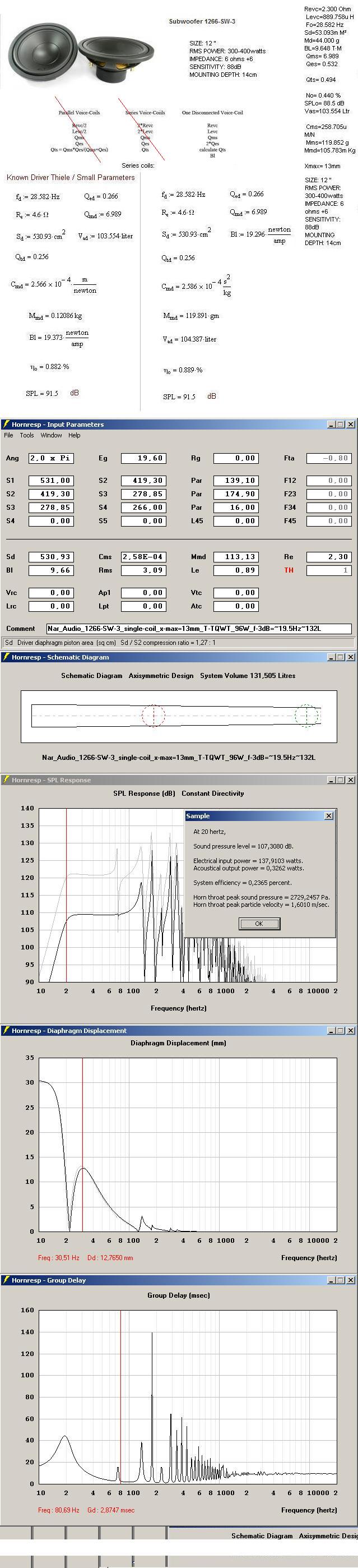

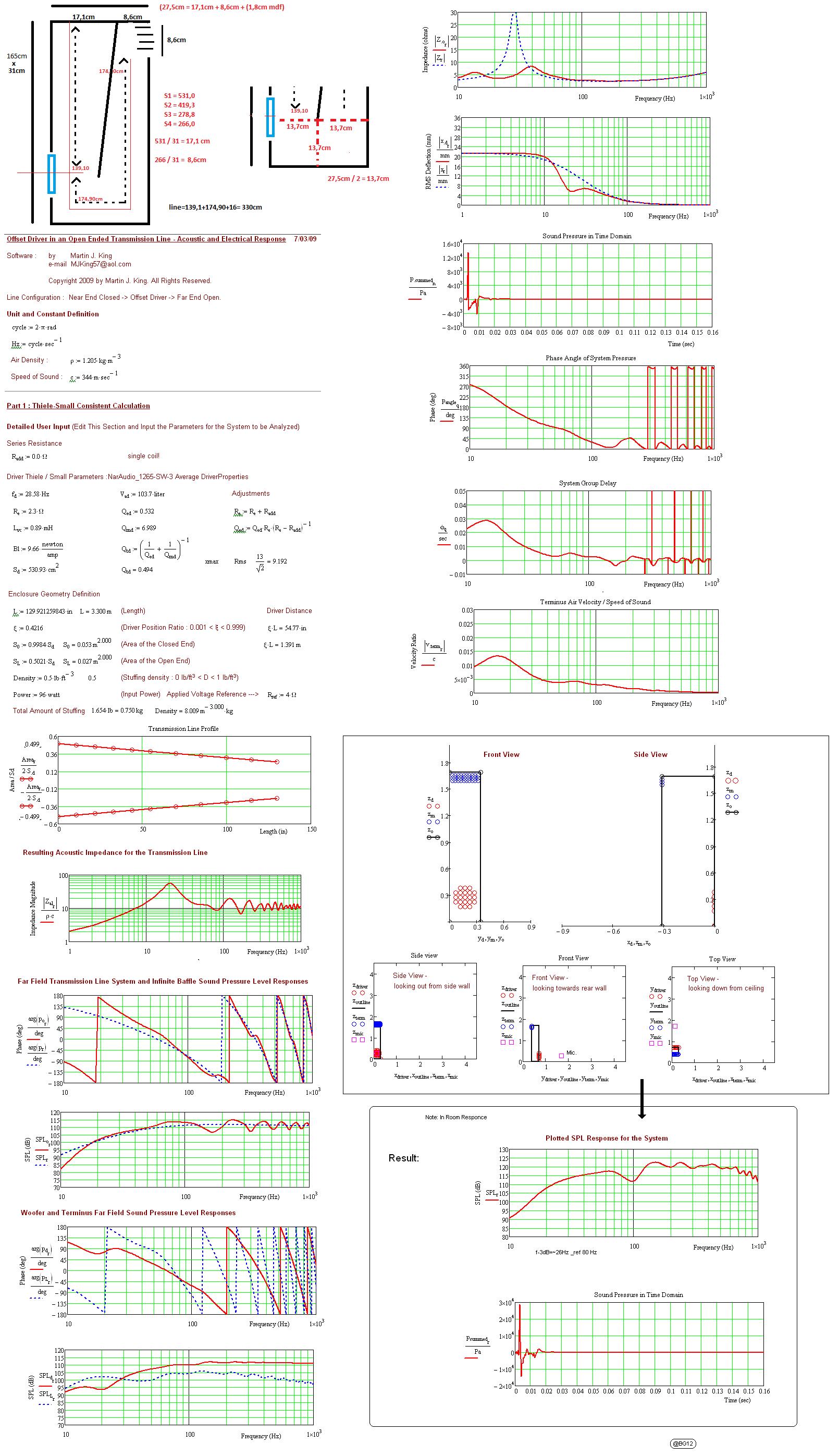

Hi nelnar,
Here is an attempt using the new driver:
b🙂

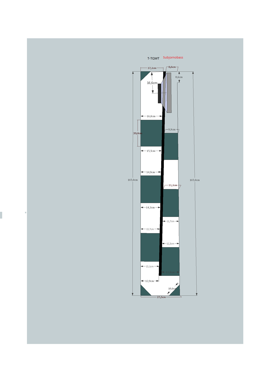

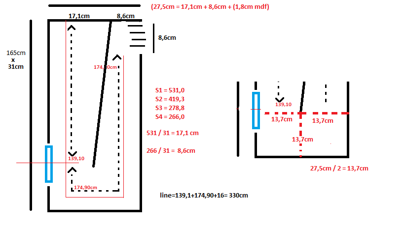

Thank you my friend.
Now let's see if I've learned!
The following measures of the subwoofer, as I understood your project.
Note: You like to do I suffer! (kkkkkkk, just kidding)
For now thank you very much my friend!
You are a very special person.

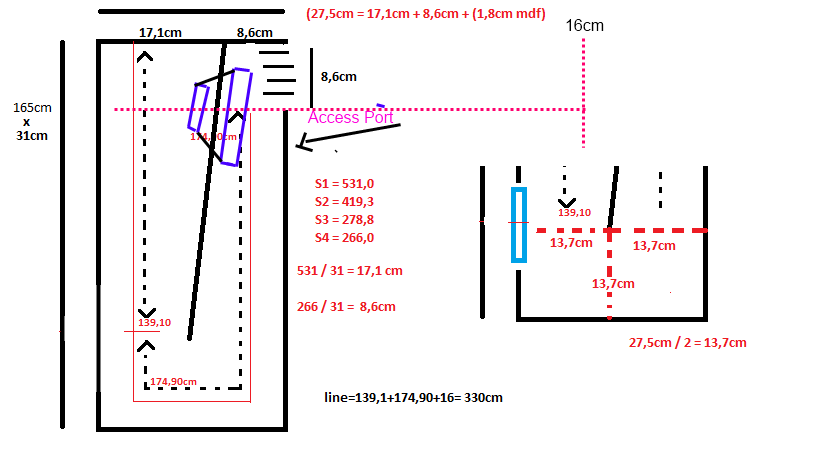

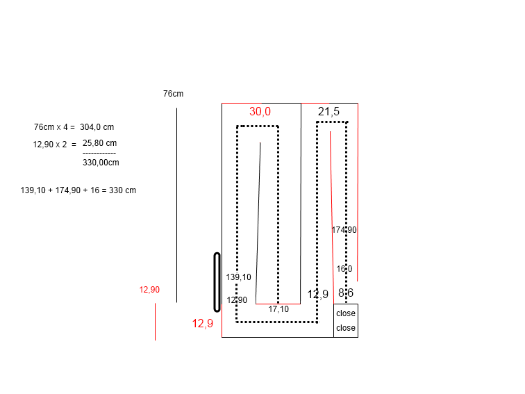

Björnö. Please friend. Respond if the design is correct!
And what would be the fill area?
Hi Nelnar,
You have designed a TL using my numbers for a T-TQWT that of-course can be morphed into an OD-TL.
For this case and for your rear terminus TL, I would decrease the line length to 310-320 cm in order to tune just below the Driver fs, that is :
The internal height would be 155-160 cm.. all other dimensions unchanged.
I rec. you to do so too with your TL as the FR will almost be unchanged.
b🙂
But I wanted the T-TQWT same.
Once the measures are certain to T-TQWT, what is wrong?
is the position of the speaker?
I even design more cameras for this project!
For a TTQWT, the speaker must be inside, on the divider, and not on the outside of the box.

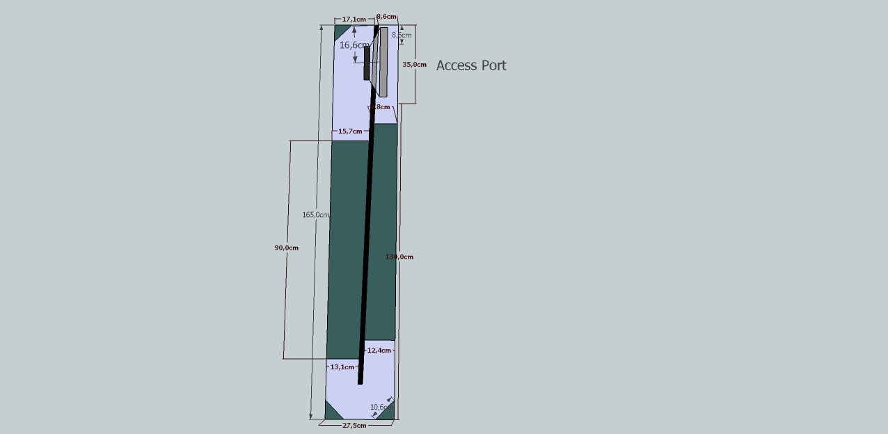

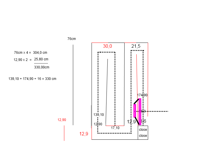

Björnö.
This decrease in line 330 for 310-320 is only for OD-TL, or also T-TQWT?
NOTE: The first image above is wrong. Sorry. (please disregard).
Please make sure it is correct for t-tqwt?

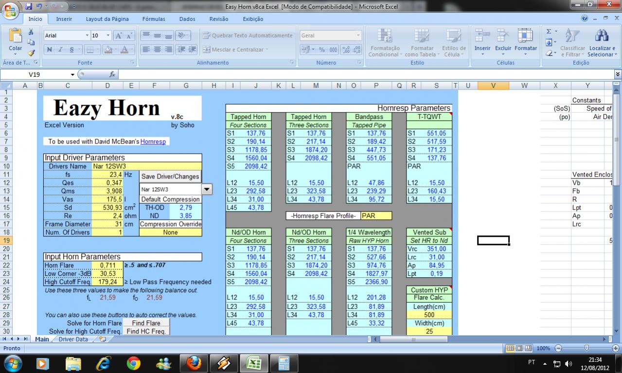

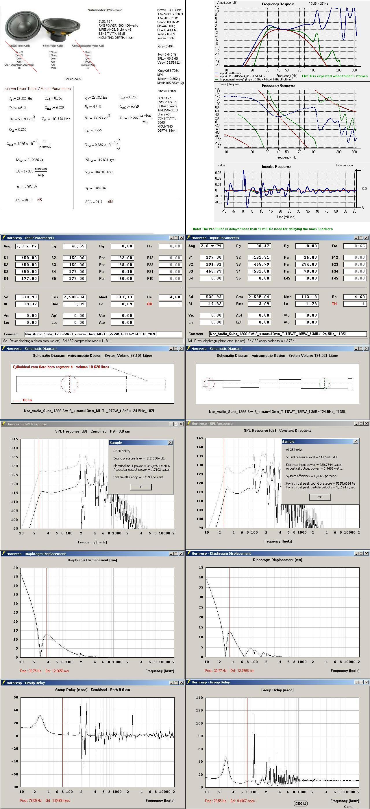

Hi nelnar,
Which HR input screen did you use for the layout.
b🙂
