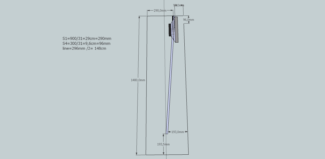

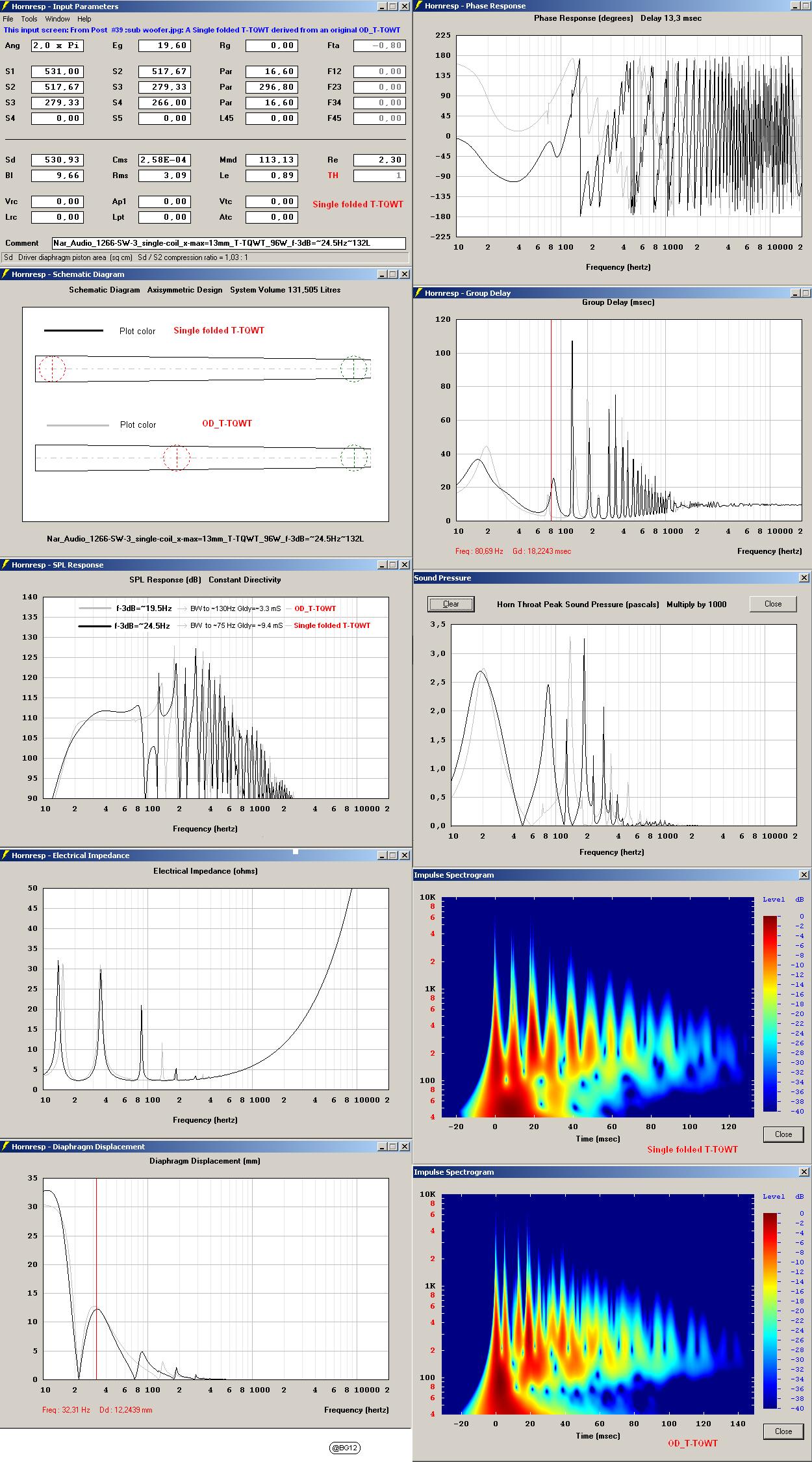

Ok,but this simulation show a T-TQWT that best would be folded at least two times and not one time as your last layout depicts.I will test if the given numbers would work in a 2-fold, my time tomorrow..
b 🙂
3 o'clock in the morning:Time to get some sleep. 😴
Again, I thank you!
Good sleeps!

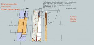

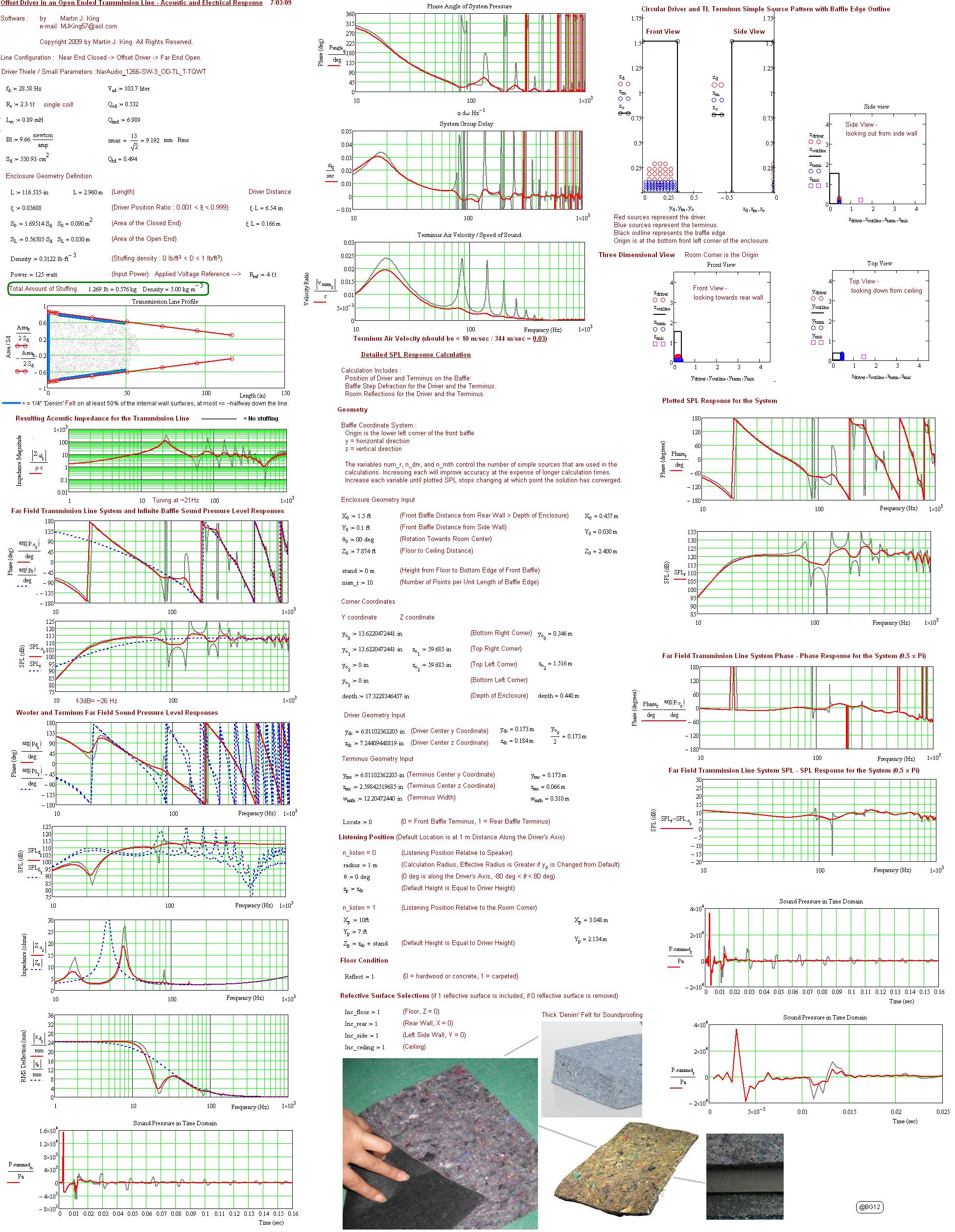

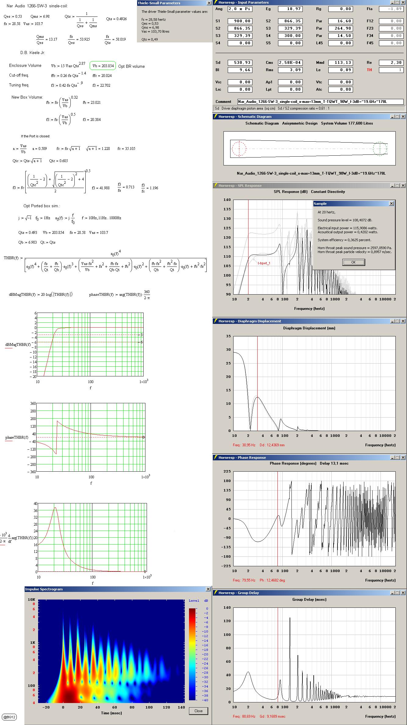

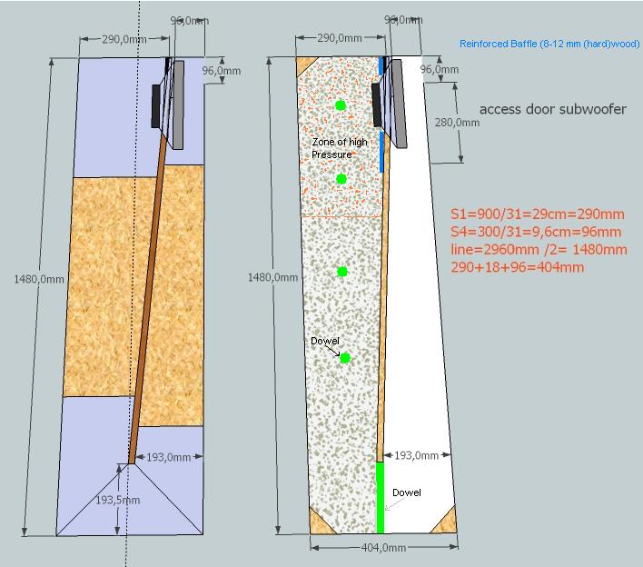

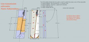

Here are two pictures again: 😉
The first is the consequences of turning my suggested ODT-TQWT into a single-folded T-TQWT,the second is an optimisation of the latter using an optimal BR box as the starting point.
b🙂

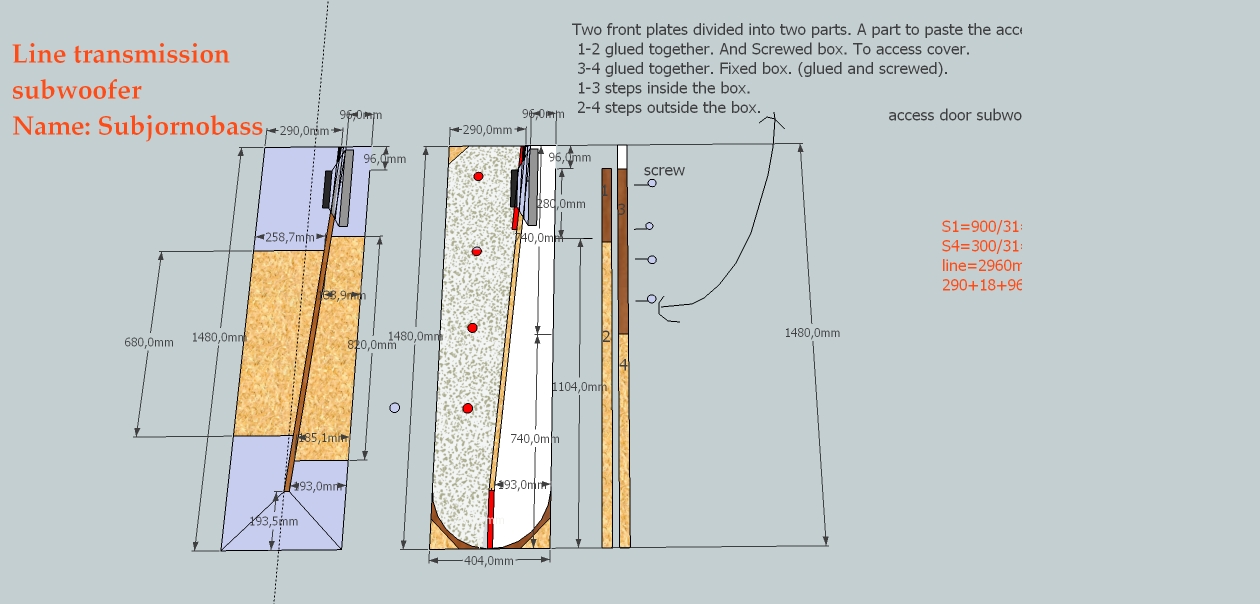

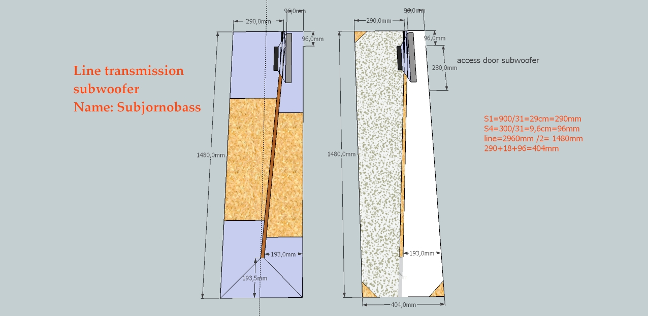

considering what you gave me, I think it would be equal to models 1 and 2.
You are a great person. Very grateful.
And thanks again for your news tips!

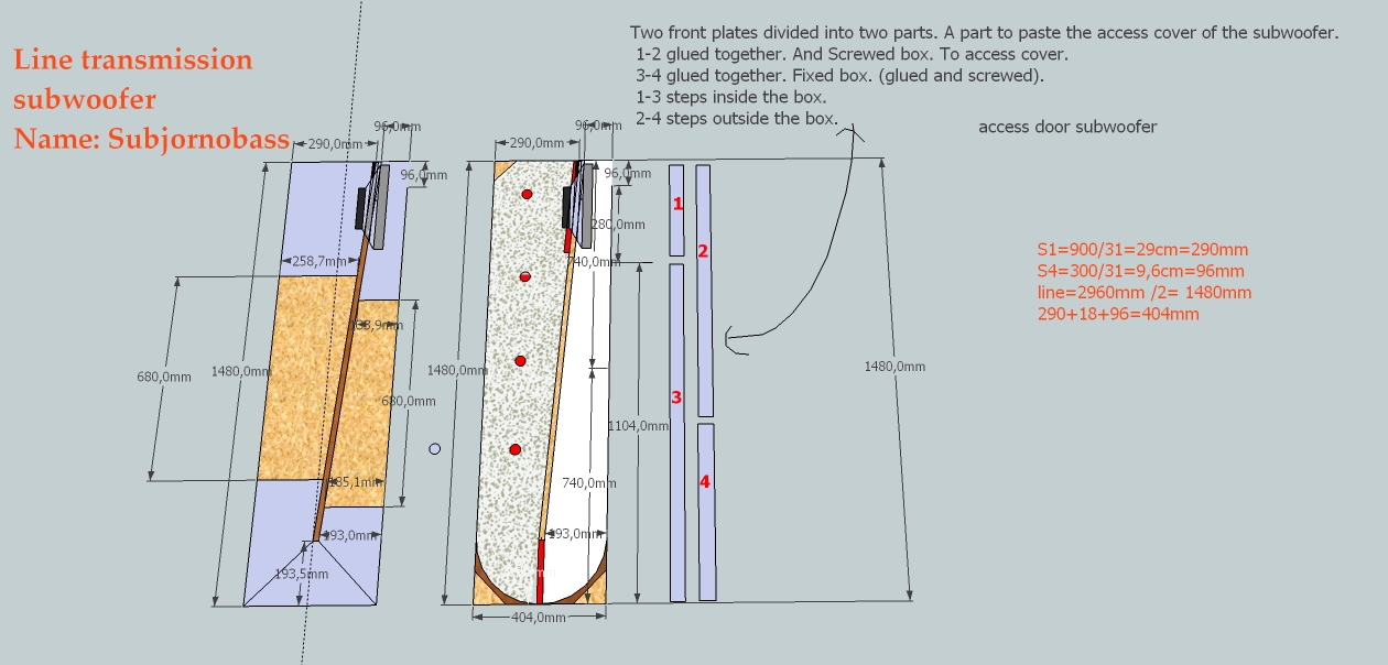

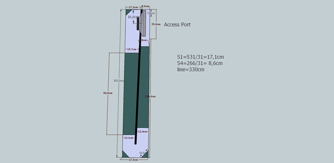

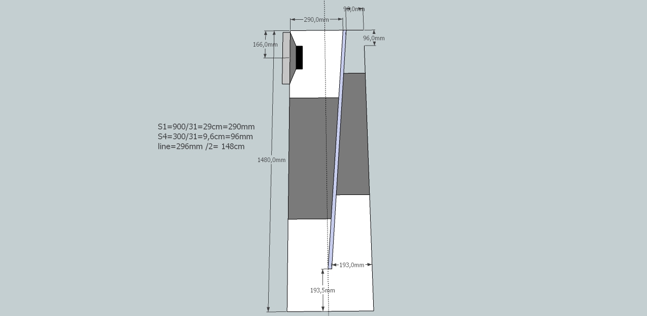

I thought about making a curve to guide the best air in the tunnel (like in the picture), you think that improves response, or no need?

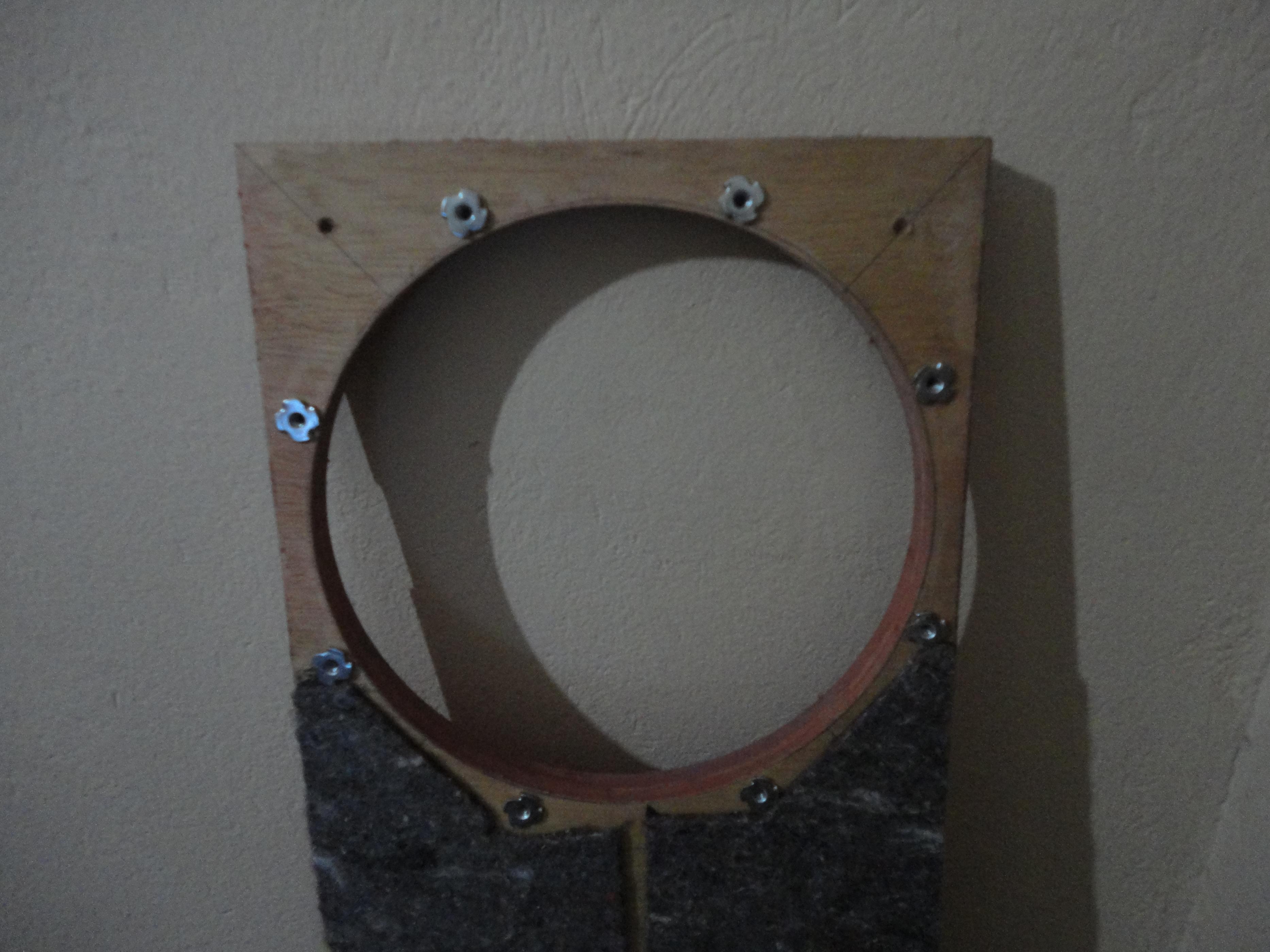

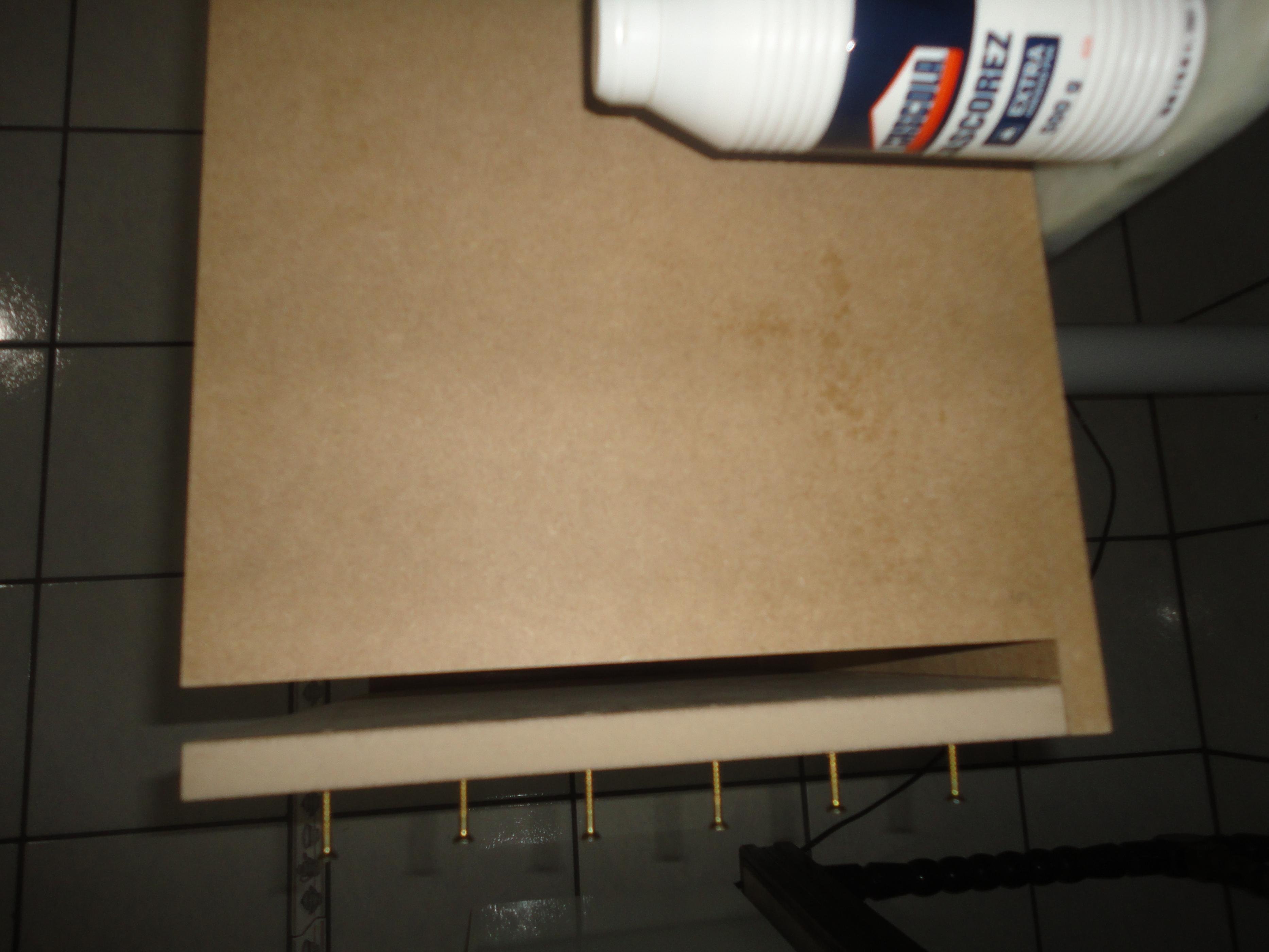

some idea of the foam padding?

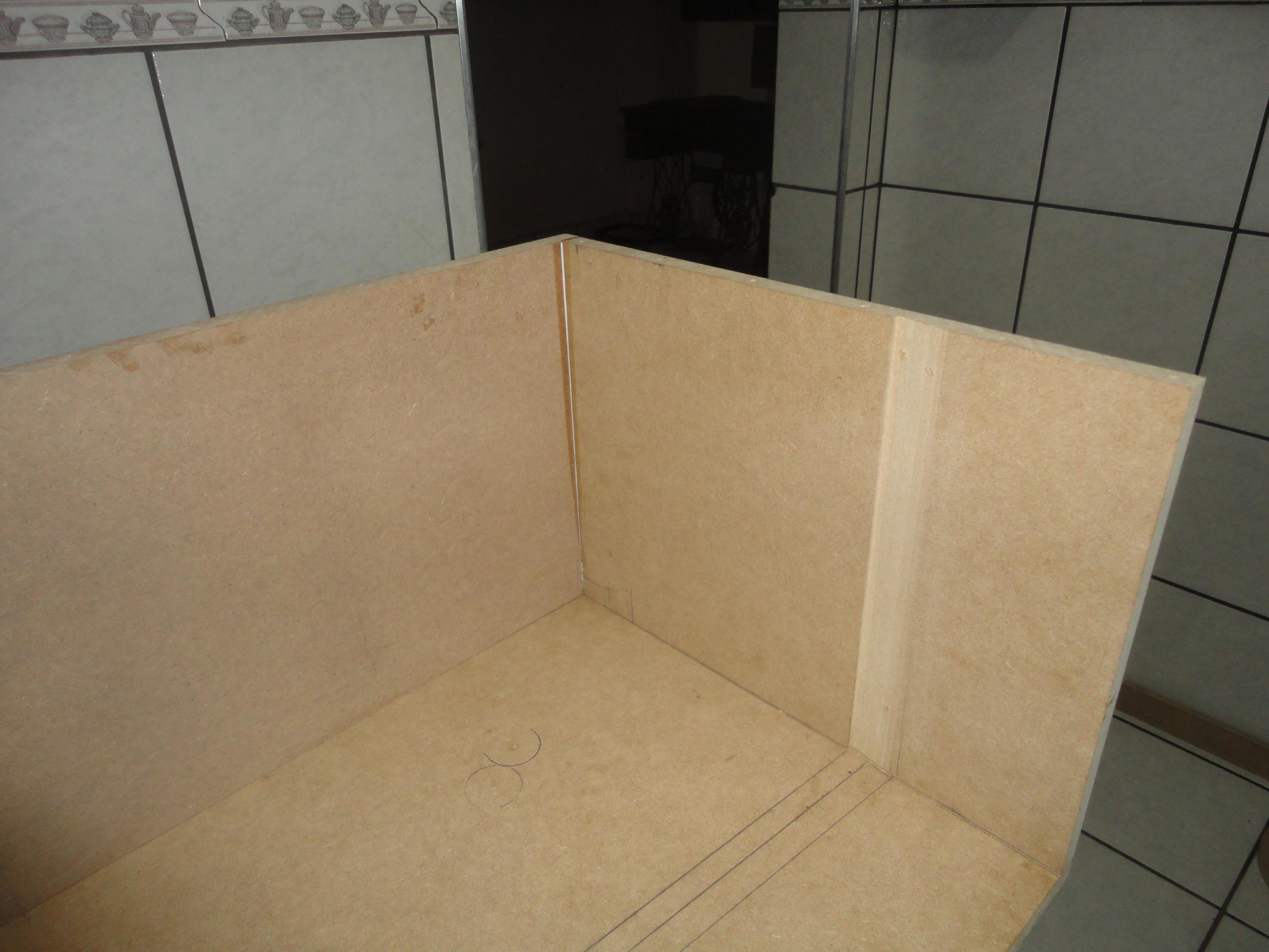

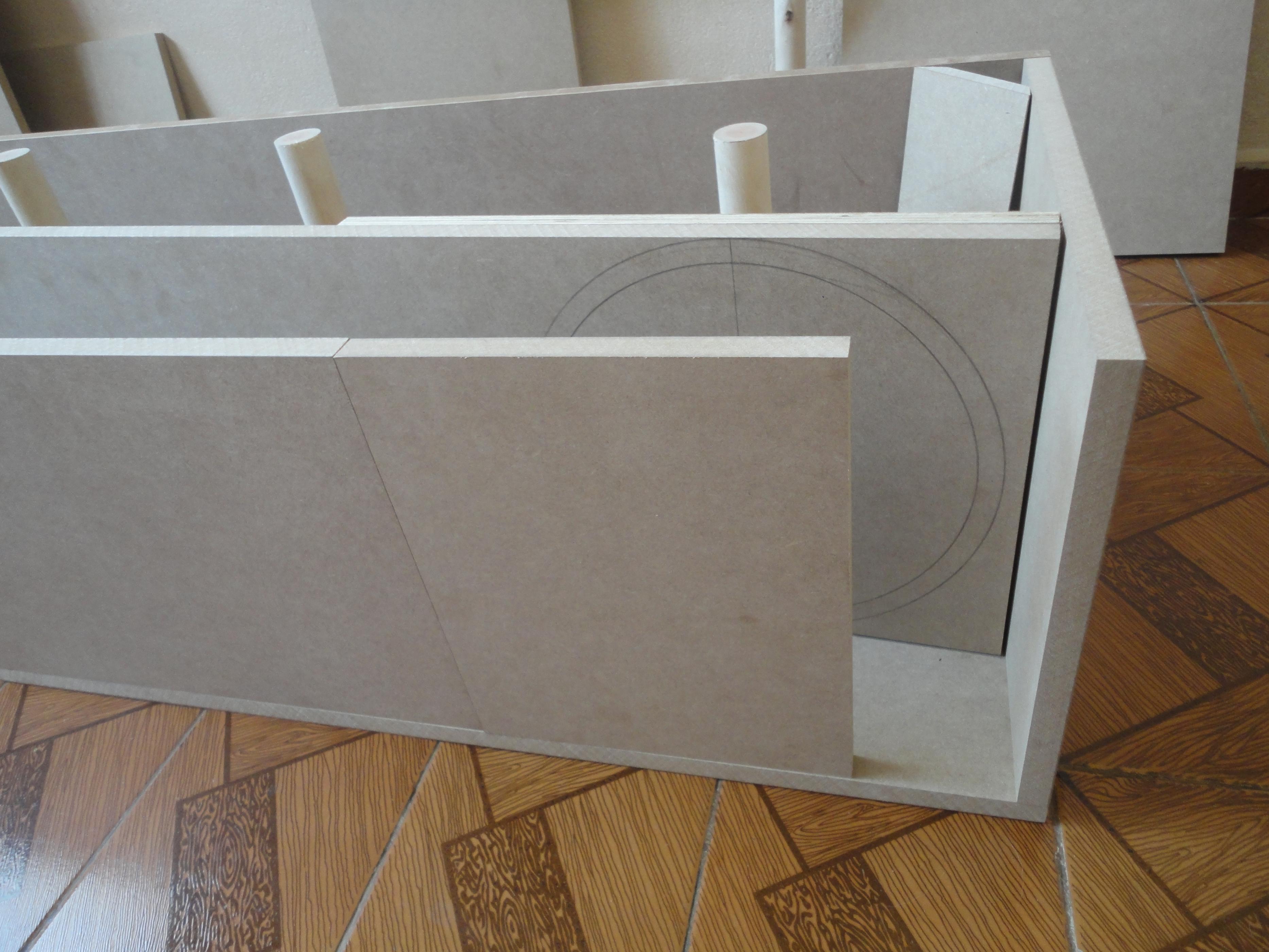

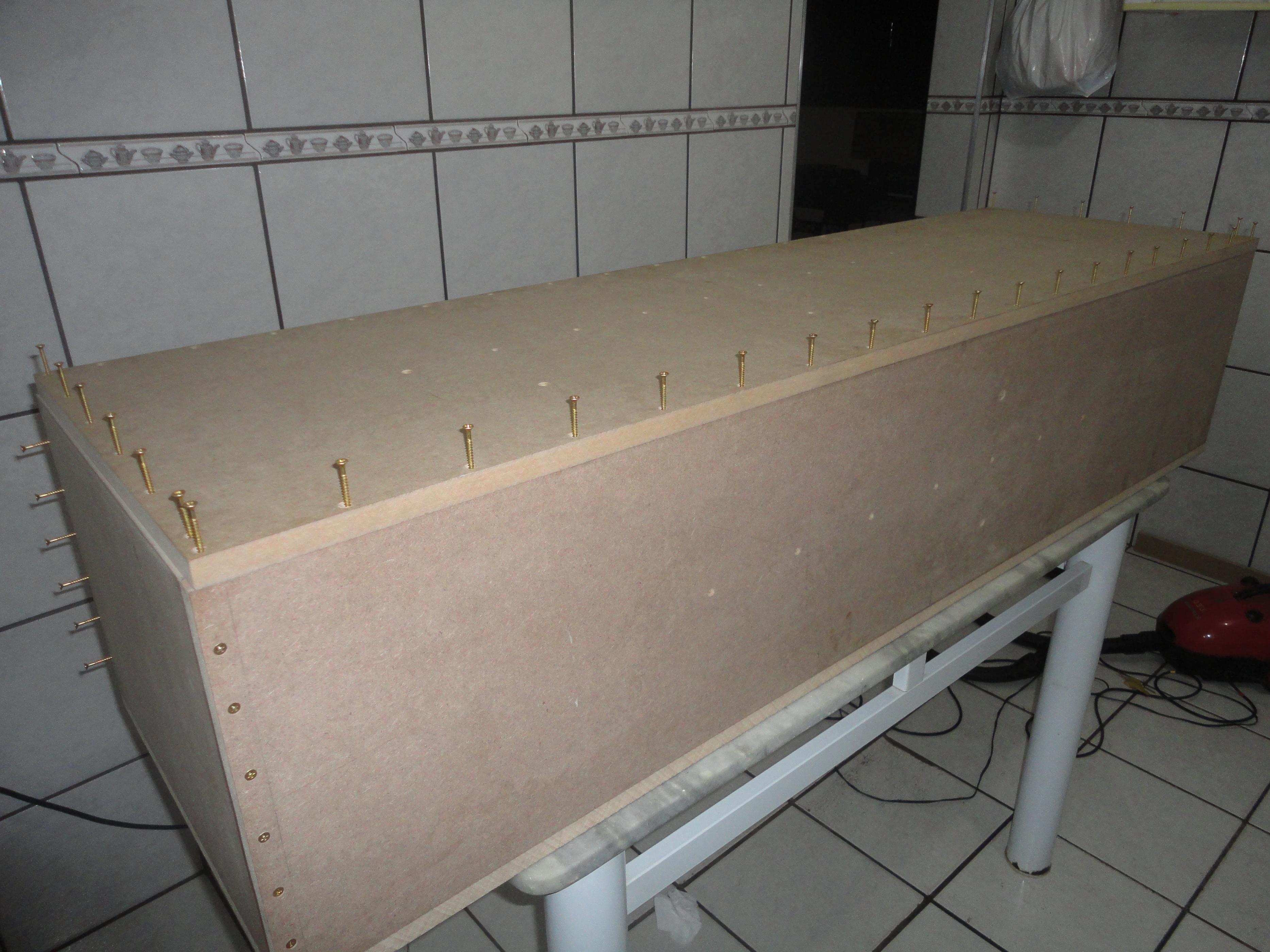

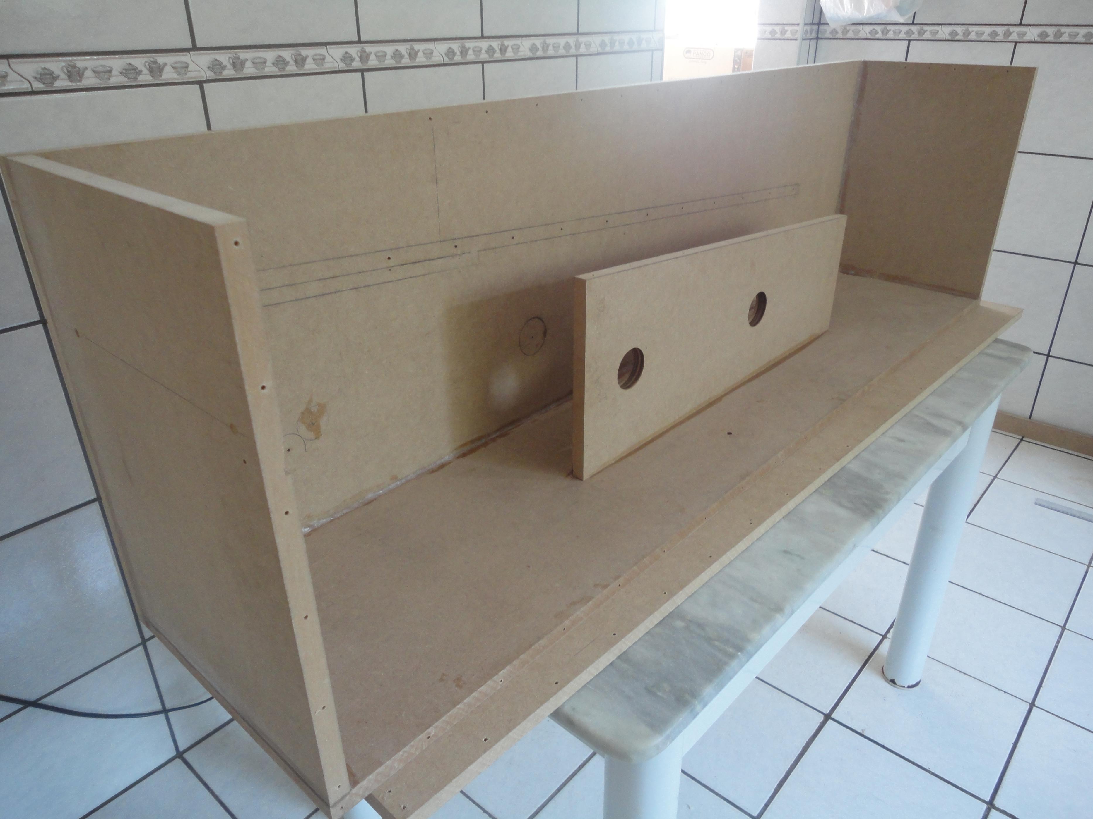

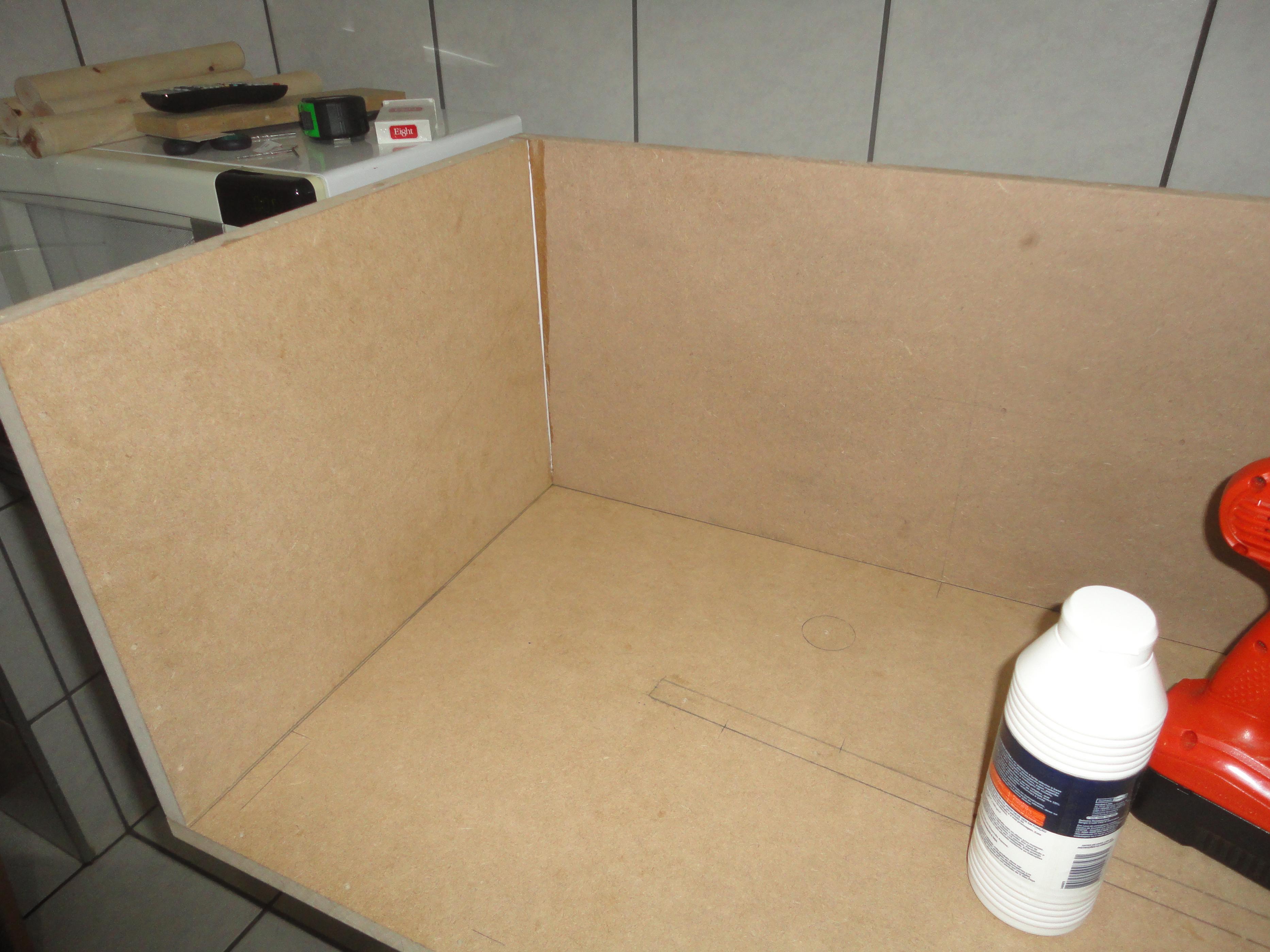

following updated photos.

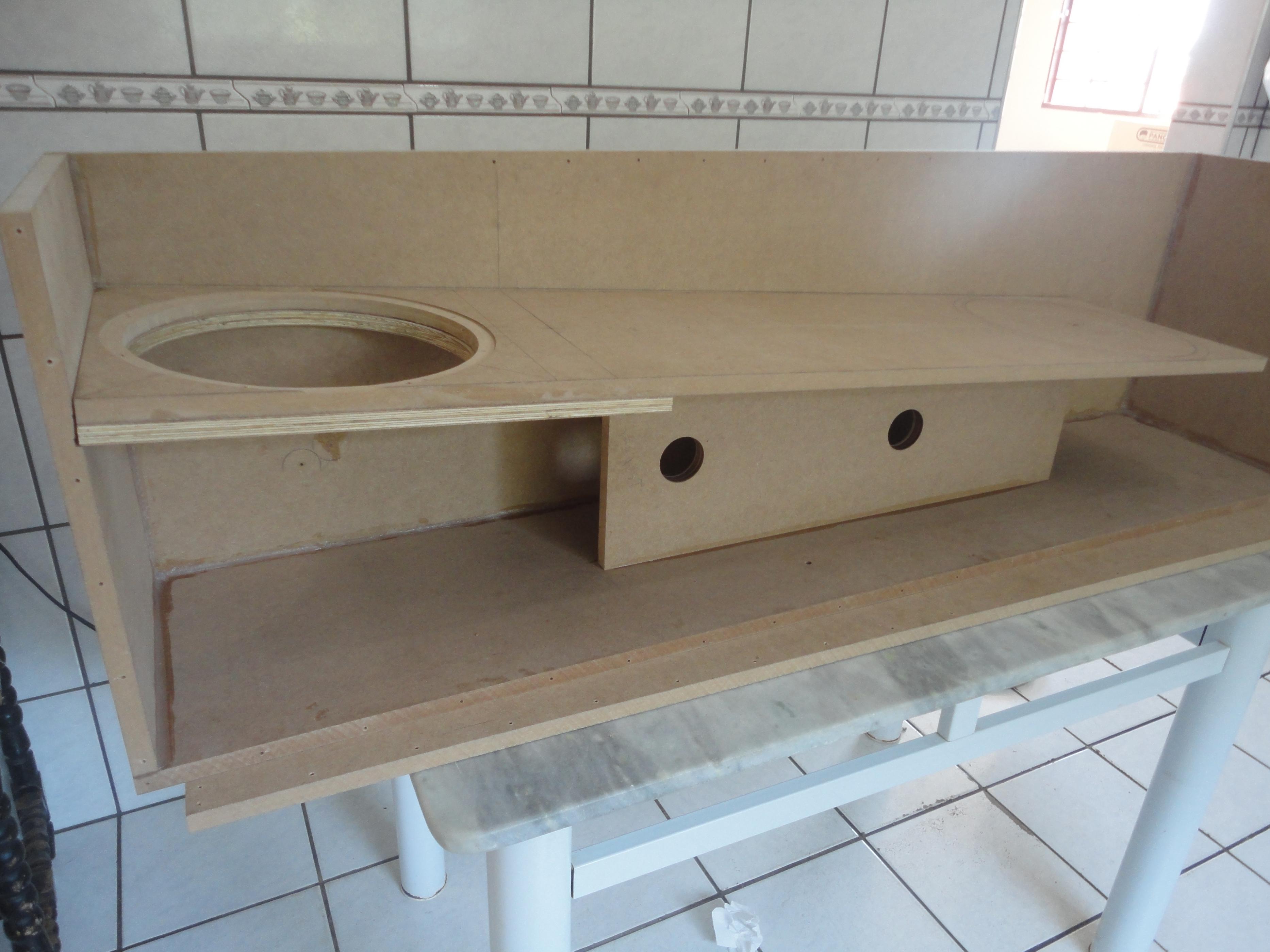

more photos
It is not easy!
A week working right, that measures be exact.
But it is very rewarding.
Björnö.

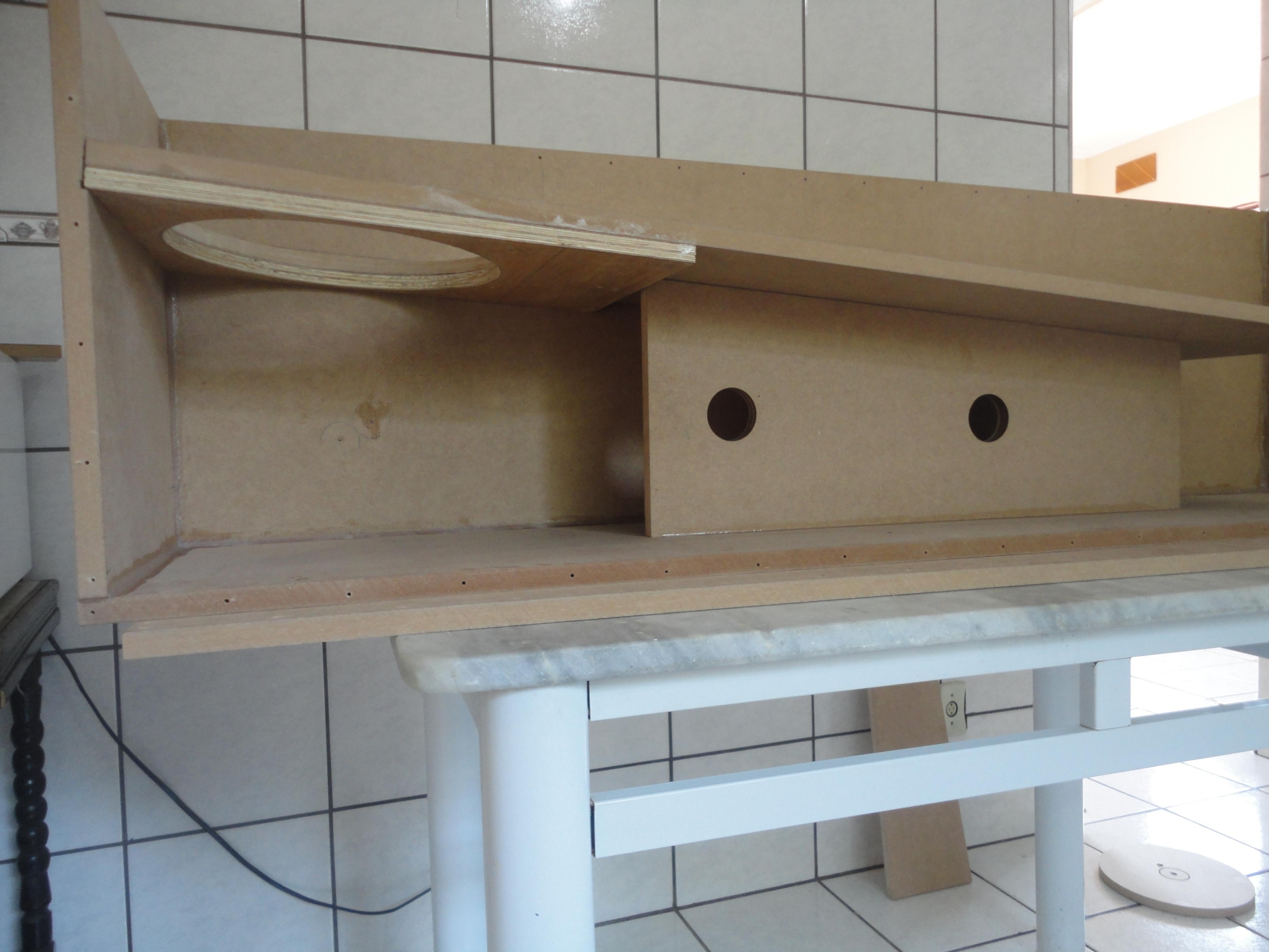

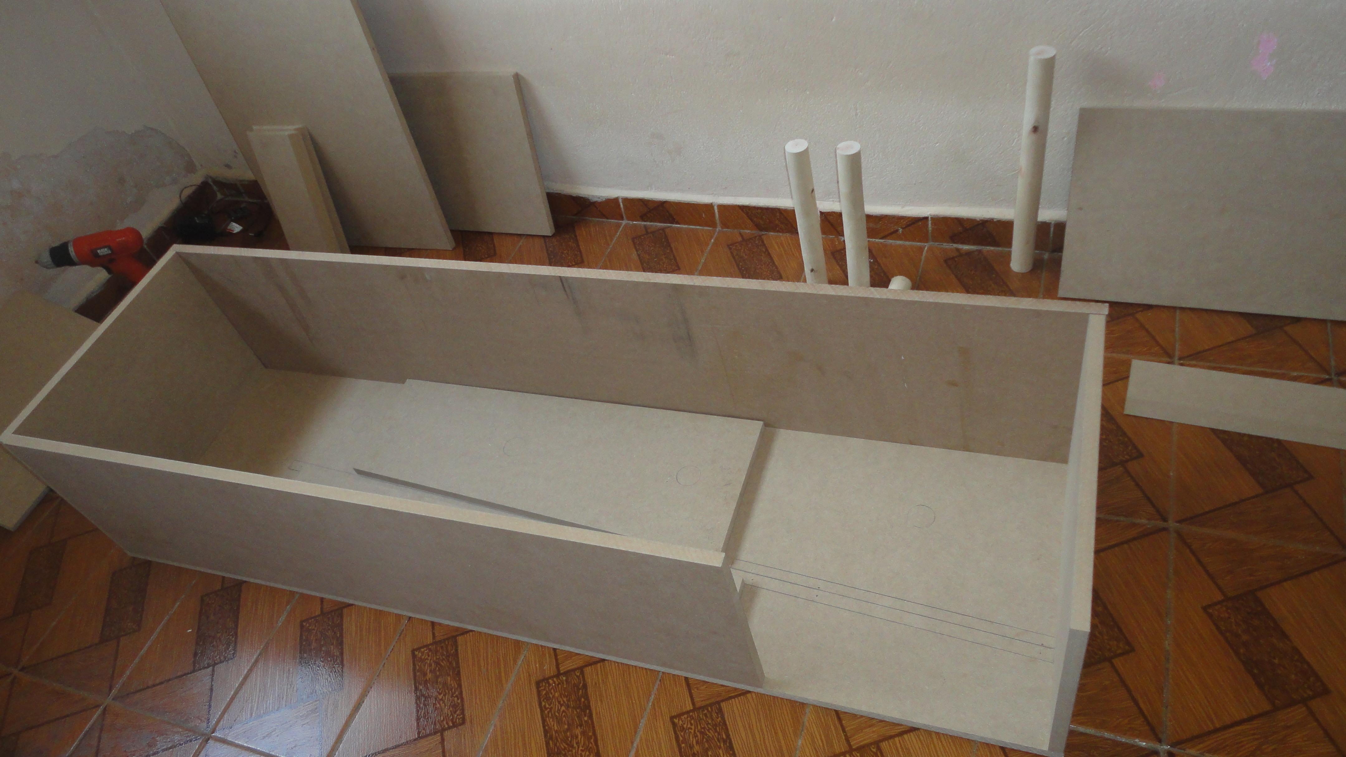

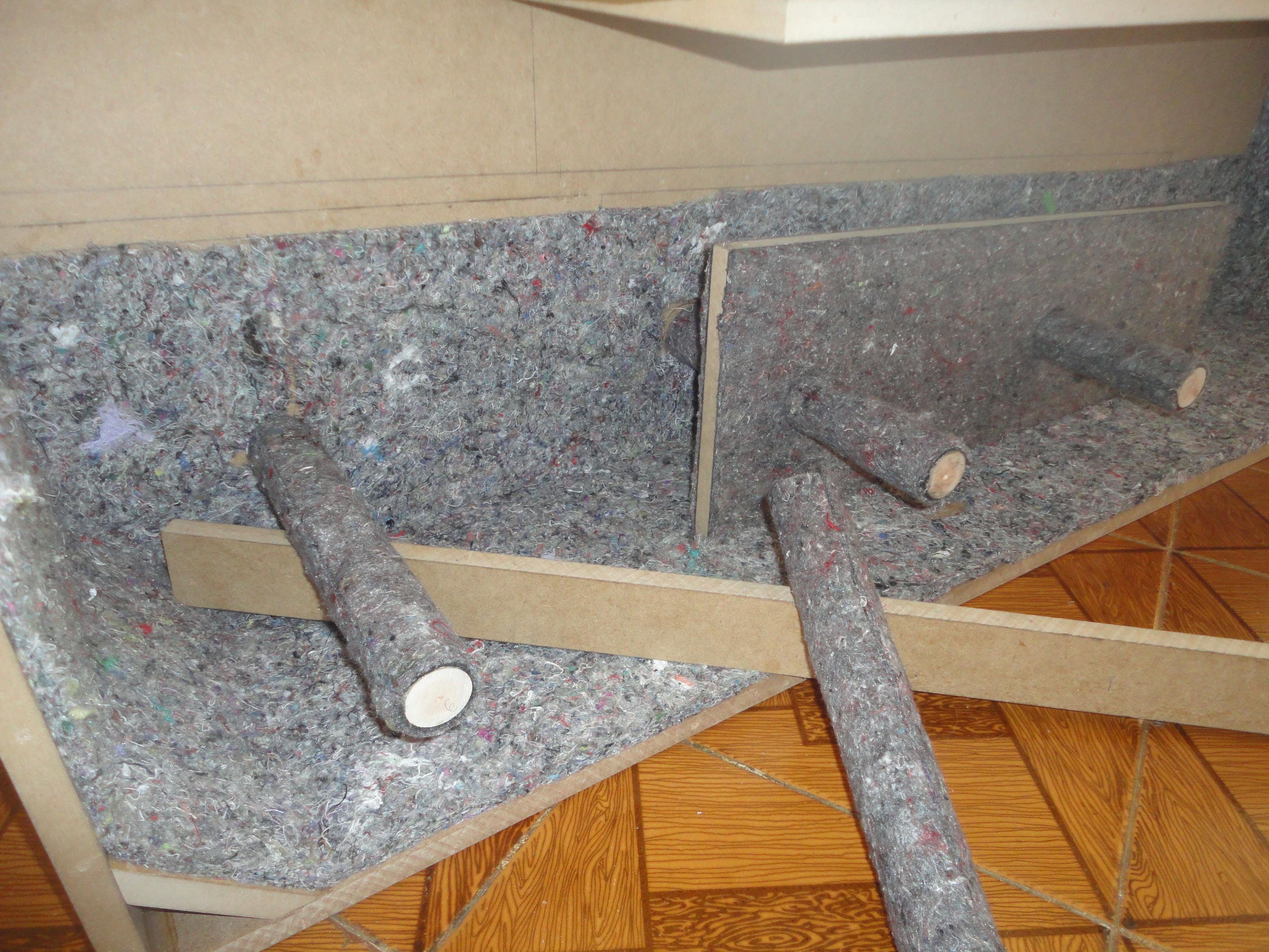

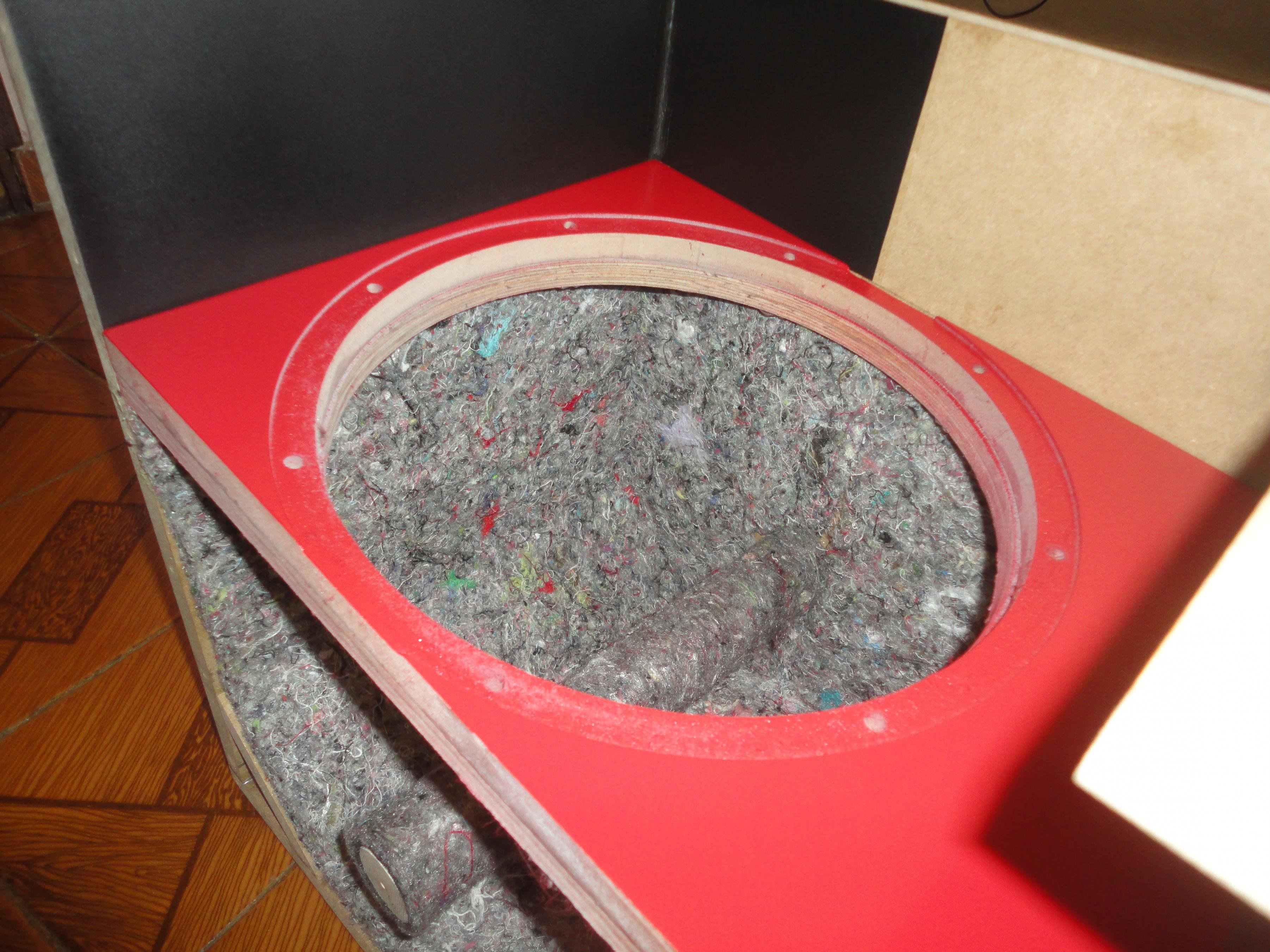

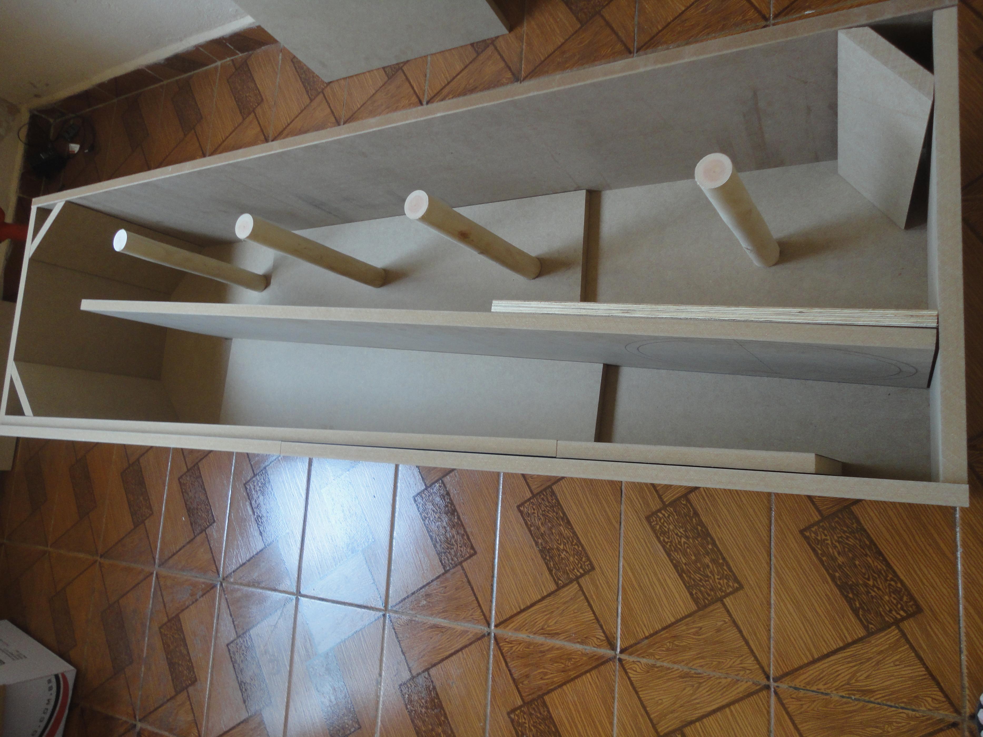

I just wanted an idea of the position of foams.
It is not easy!
Björnö.
Good work Nelnar!
I never use foams to lime the walls in a TL but instead different felt= dense types up to an inch of thickness. The given material for damping the enclosure should be of ordinary polyester type that can be adjusted to different densities.
b🙂
It is very gratifying a compliment coming from you.
Thank you!
But, you are responsible for my success.

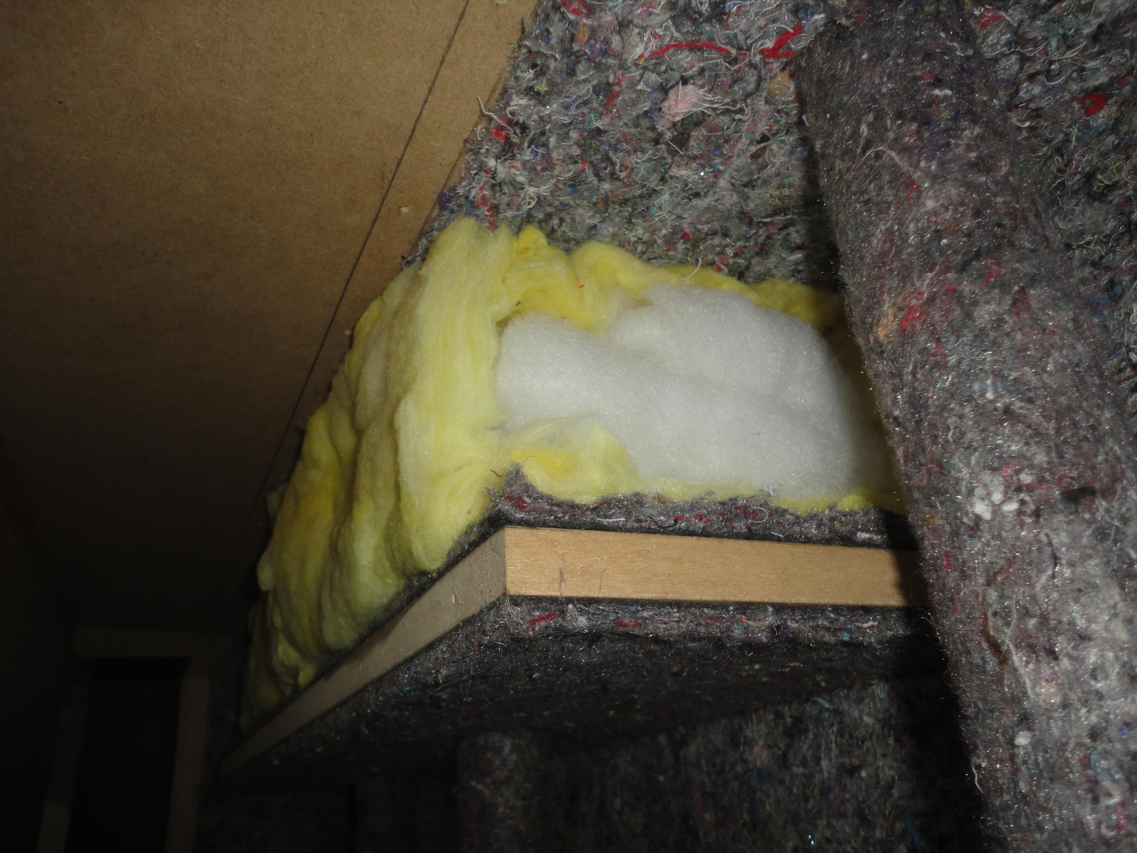

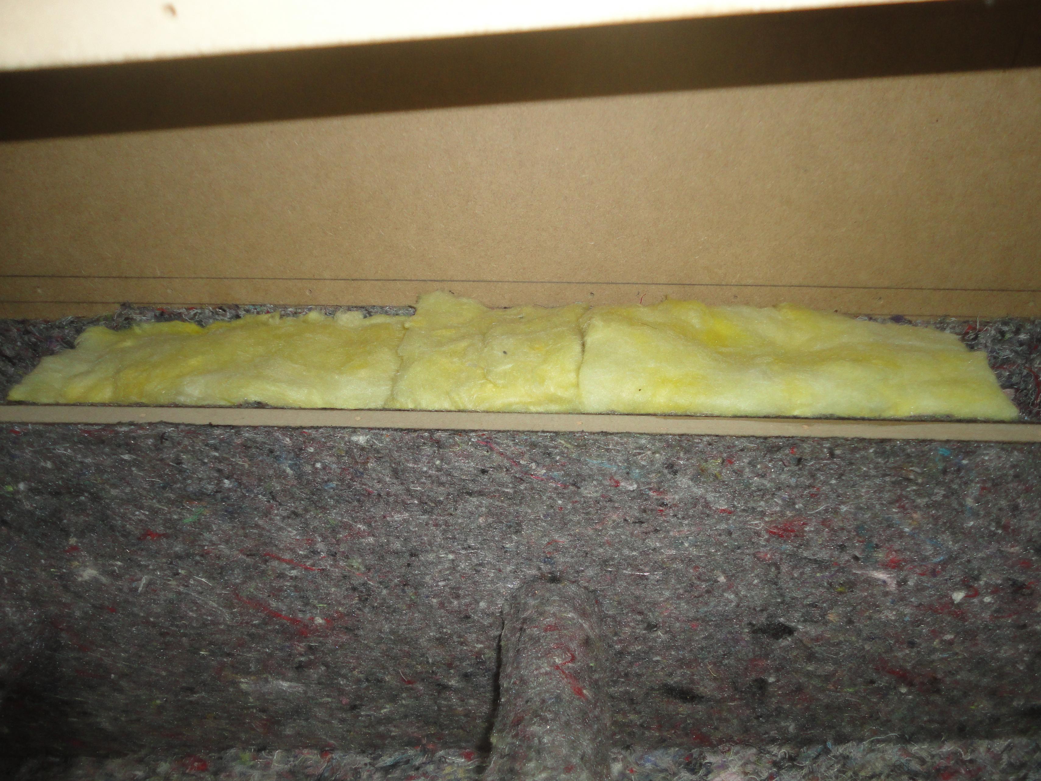

Then take half of the TL, what do you think of fiberglass filler?
Fiberglass will work too. but when used for bulk volume stuffing, leave at least 25-50 % of this volume without, i.e. e.g.:Use 2inch battens in parallel with a 1-2 inch free air passage until paralleled with more battens.The arrangement should look like an soundproofed ventilation air duct.
b🙂
PS: I my previous post I wrote: ' never use foams to lime the walls'. Should be: I never use foams glued to the walls.

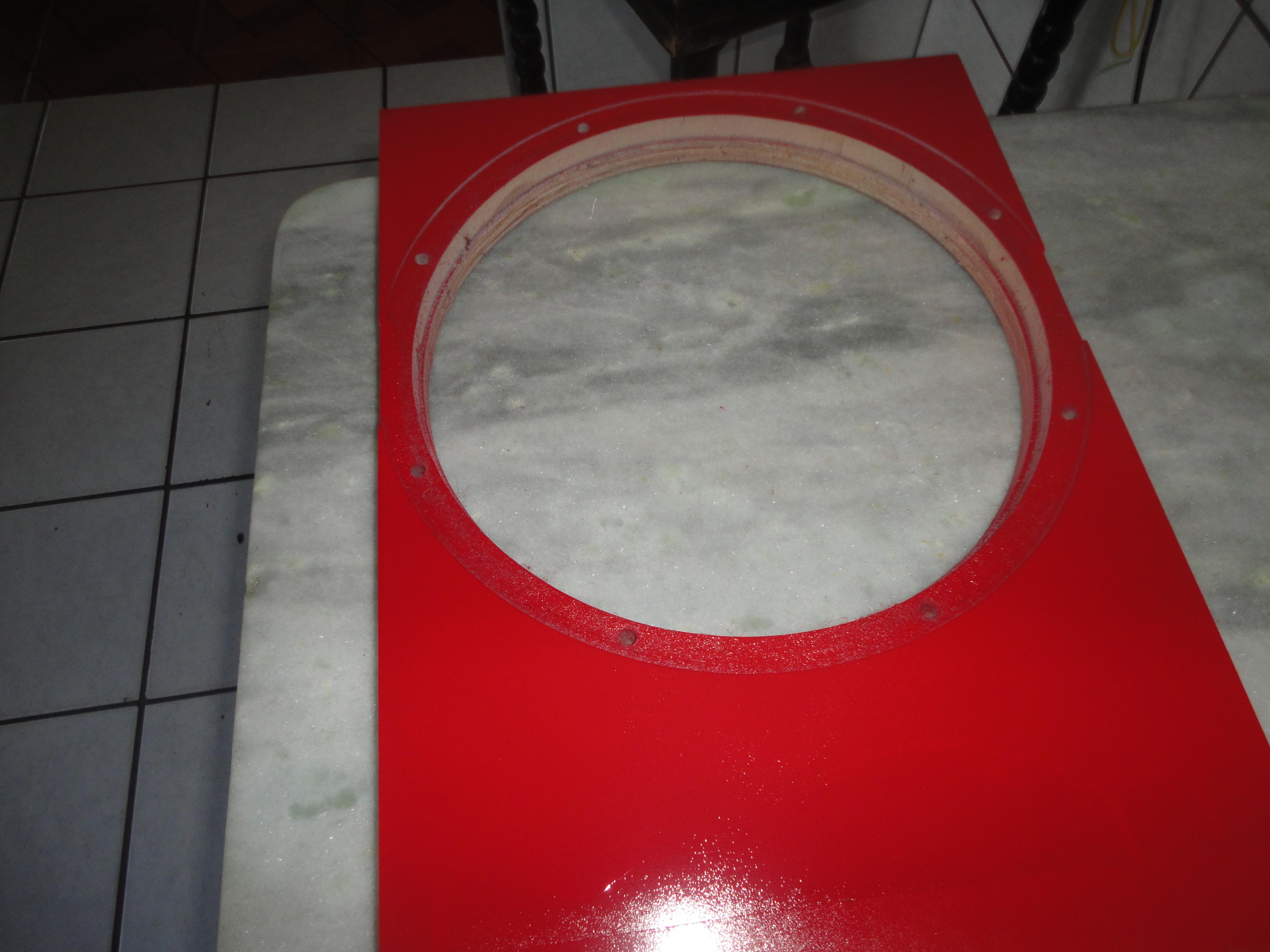

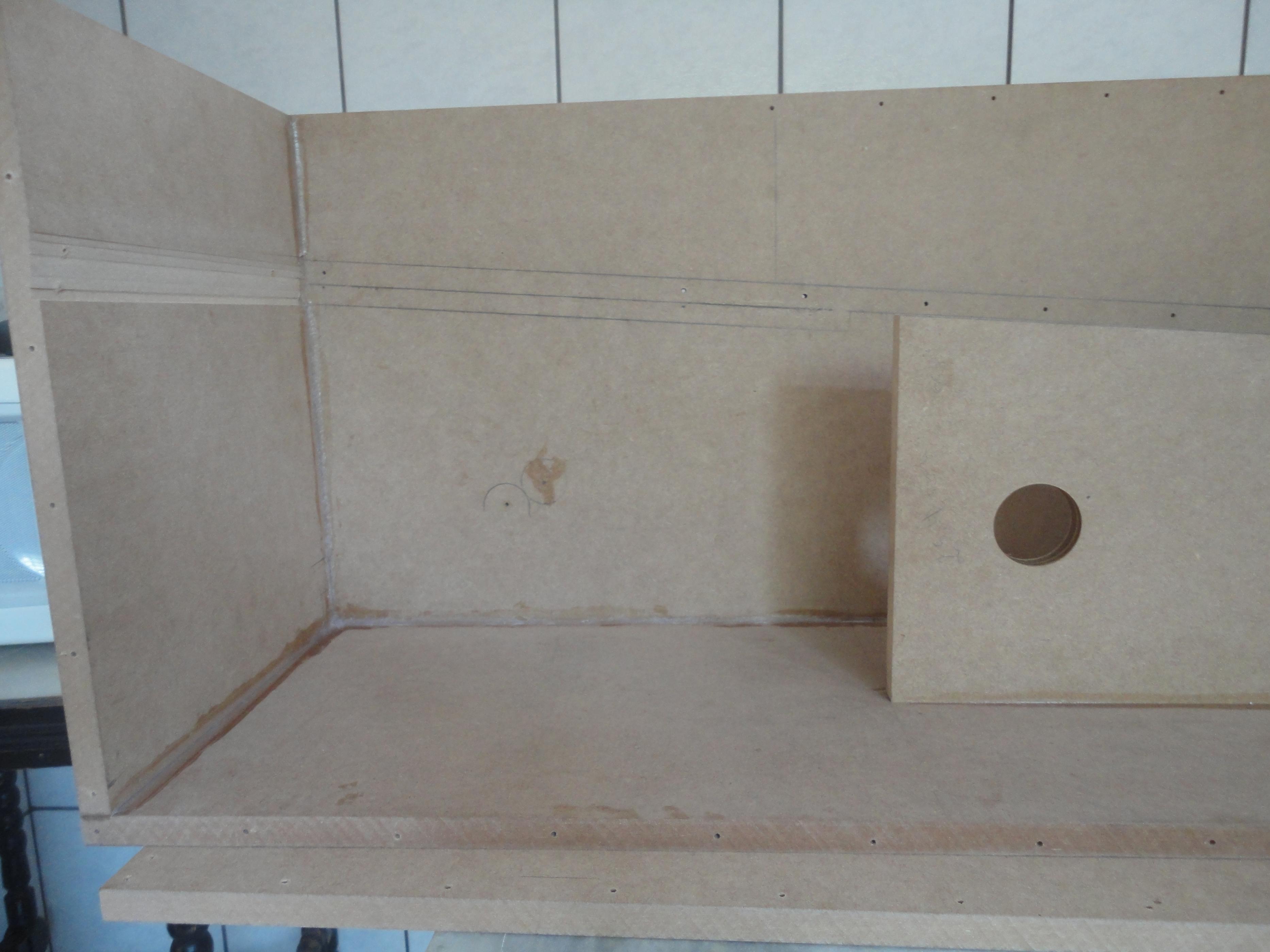

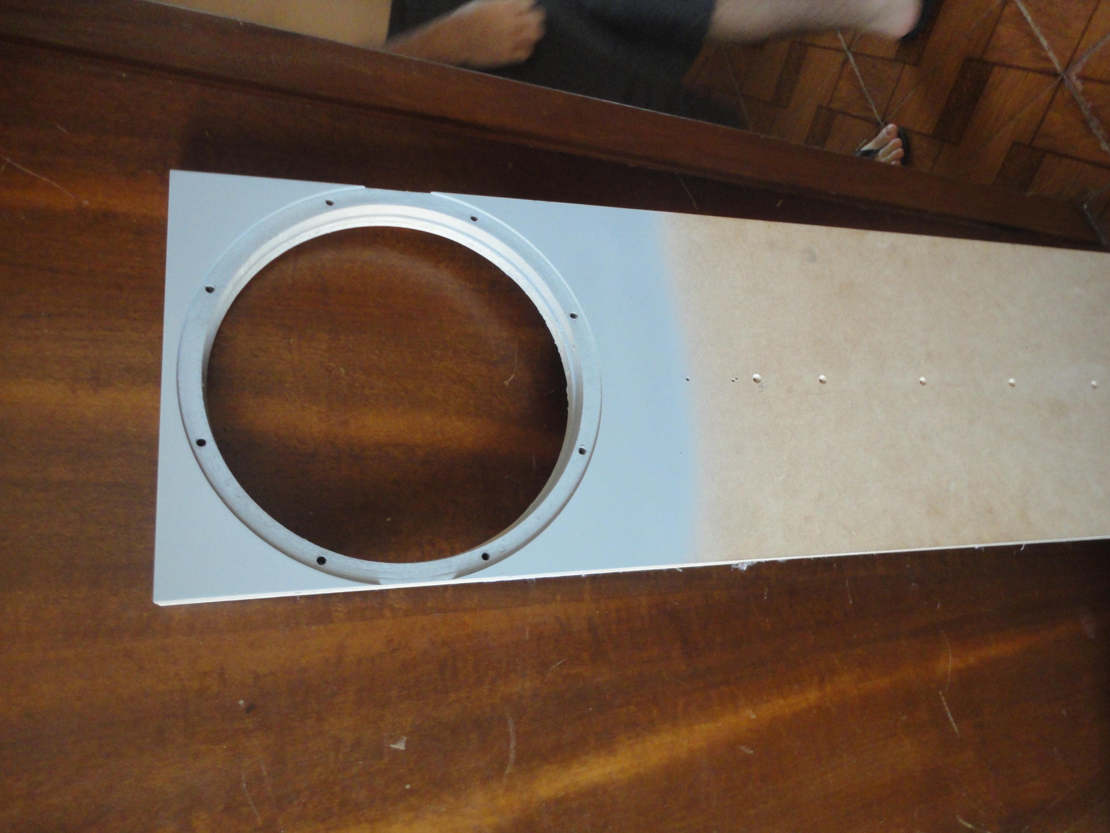

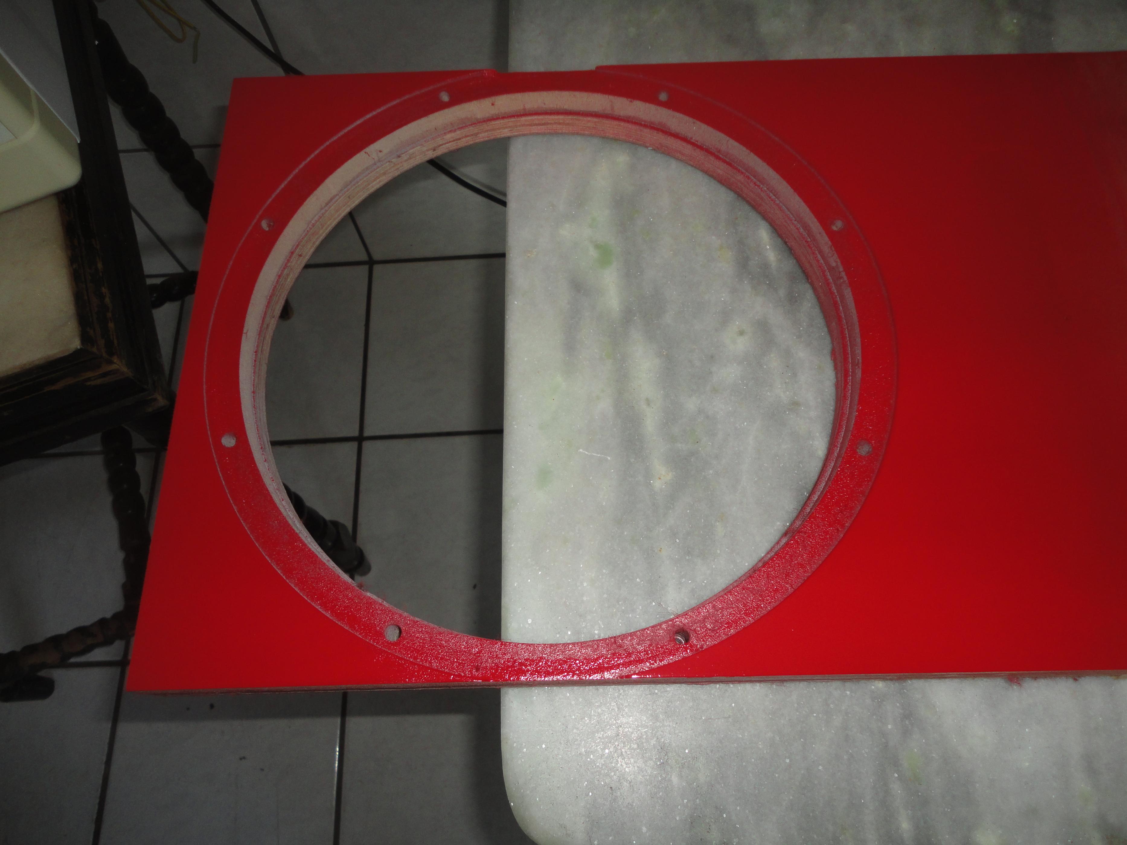

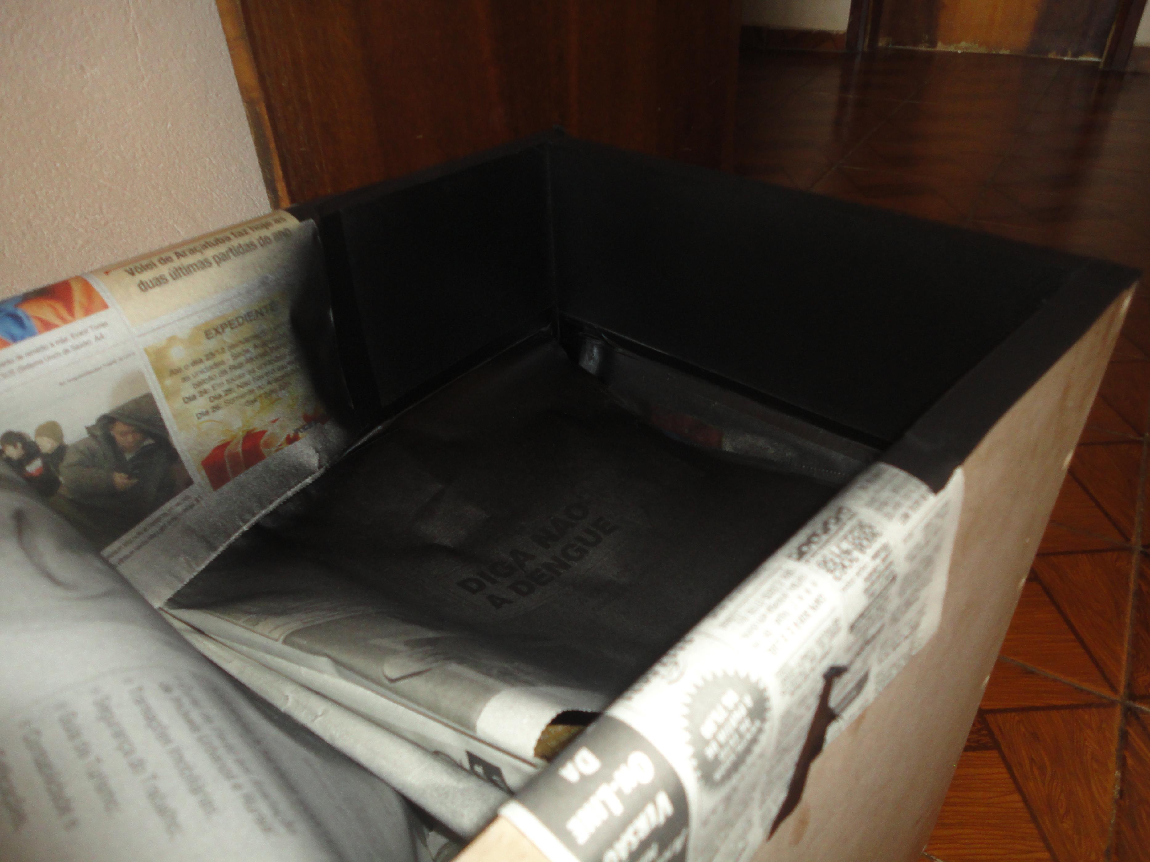

more photos!!
almost done.
interior finishing and coating.
