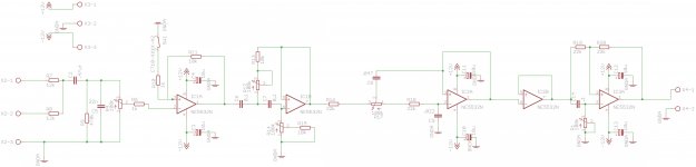

Hi Ostripper,
I am planning to make sub xover based on lars clausen design. However I am stuck in the values passives and connections of the schematic. attached is my attempt of the schematic. I know its pathetic but still in learning phase. can u have a look and suggest changes if possible?

Make it bigger/darker - can barely see it.
From what I can see , 12/oct very simple filters.
Our posted one is way better.

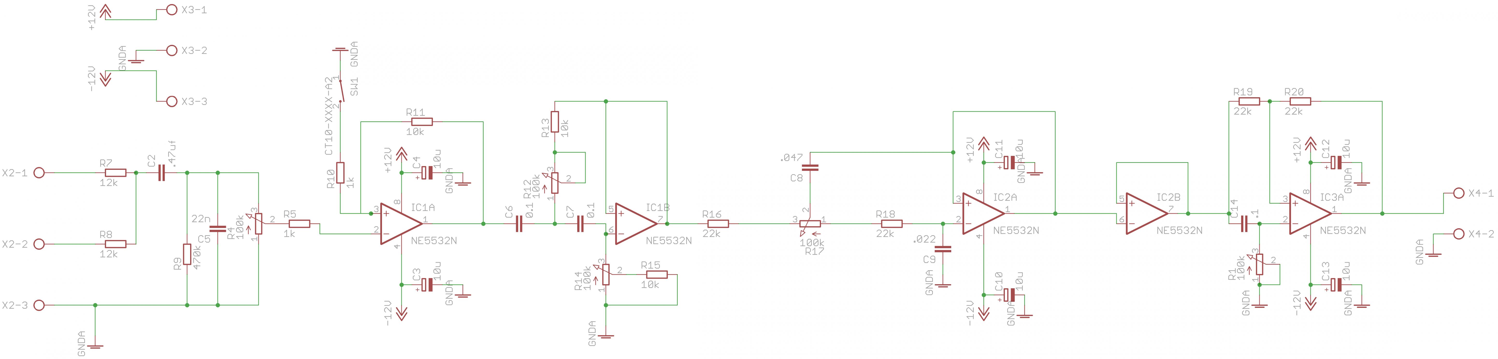

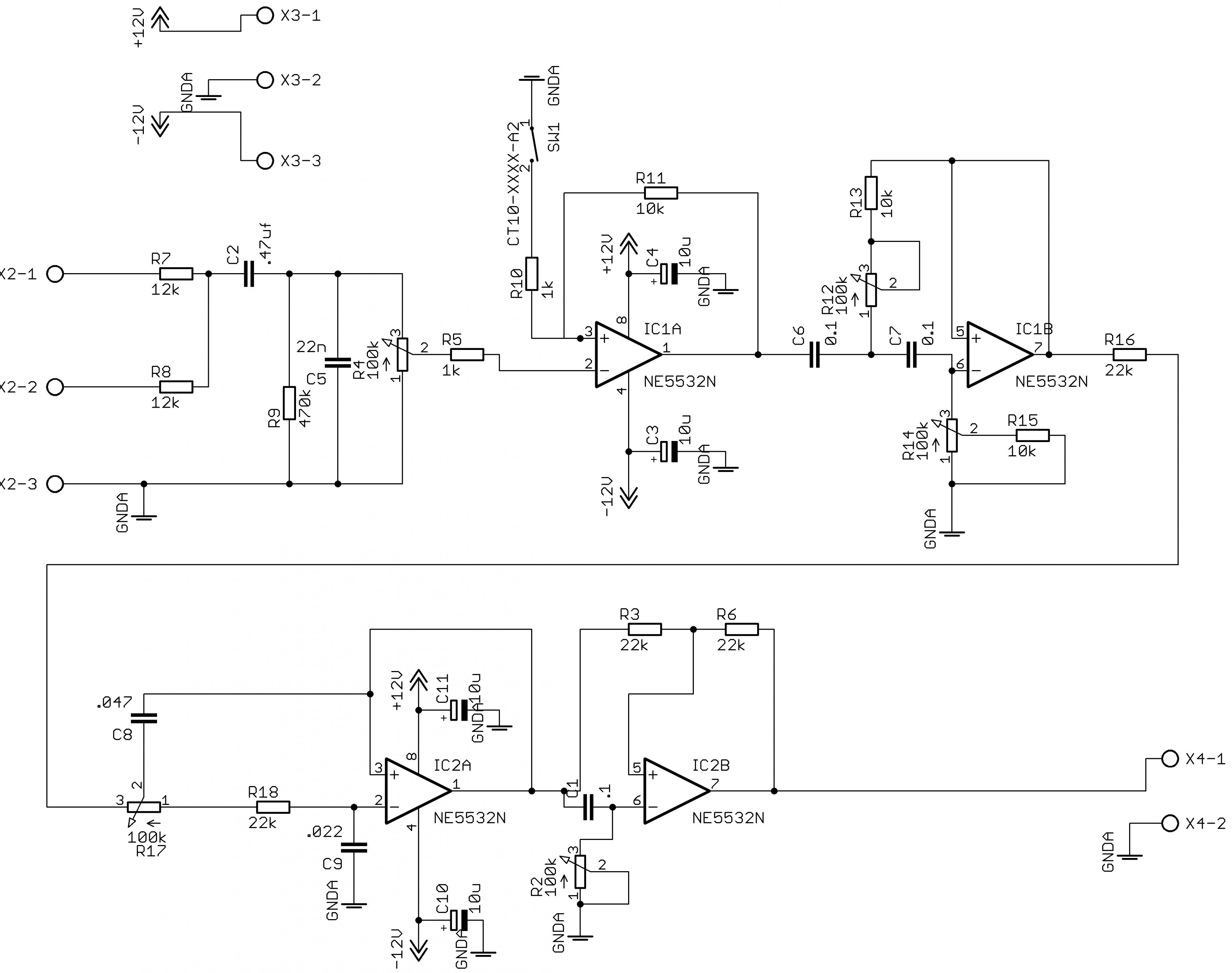

Hi
here is the higher res image in monochrome. Hope its readable. (Hint. click on the four arrows at the lower left corner and it will open in biggger size. ). Also attaching the eagleschematic , if you use eagle..
also can u give the link to your posted filter?

Yours has -
IC1a - input sum/X10 amp
IC1b - rumble HP 2nd order
IC2a - LP 2nd order (X-over freq)
IC2b - phase and output buffer.
This is a cheap car audio filter.
1st post of this thread is a better one
with 24/db octave LP.
U3.1 variable resistor from + input to ground was omitted.
Yours would work ,it would not have as sharp a LP cutoff .
Might hear a little midbass on your sub.
