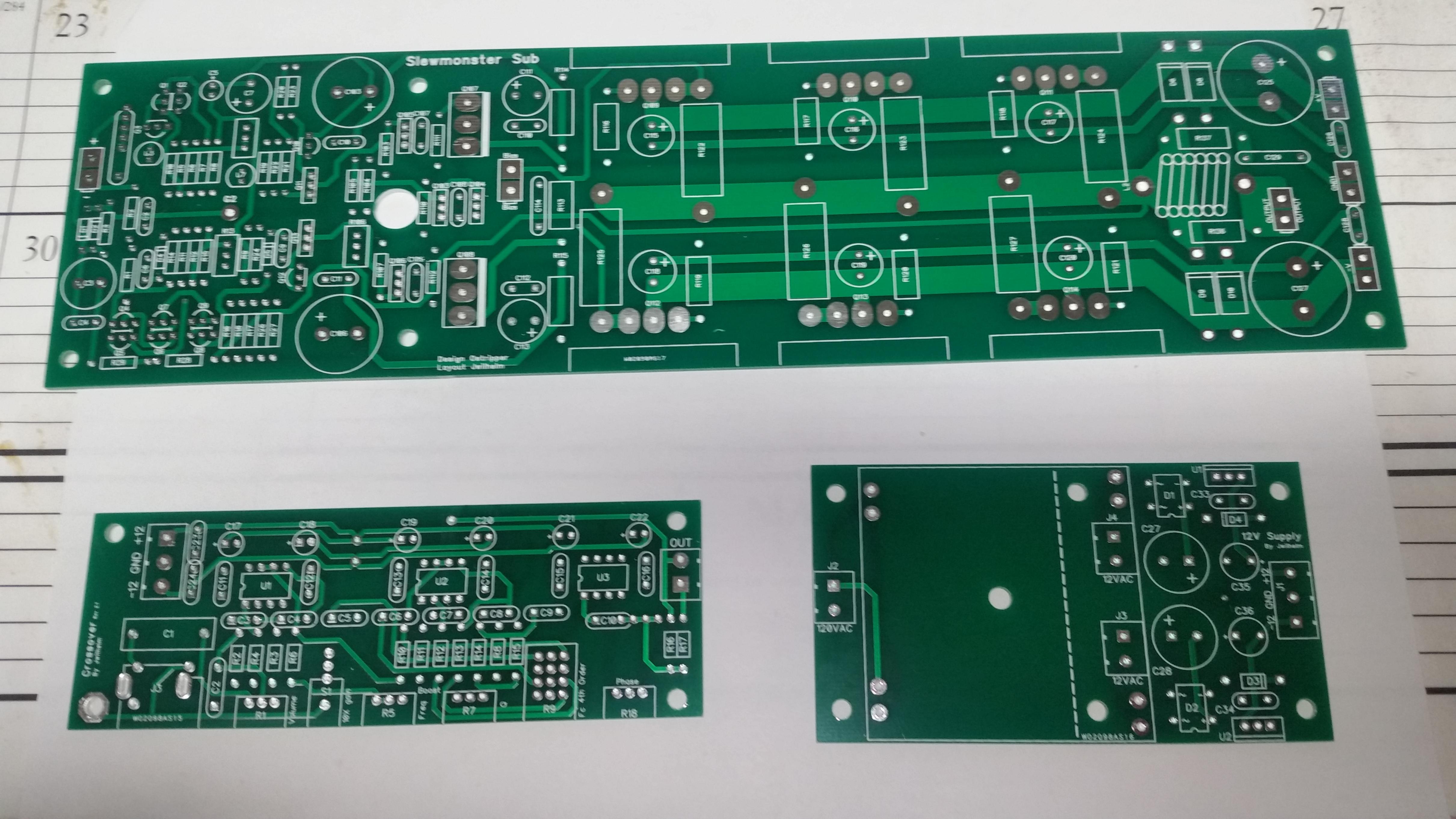

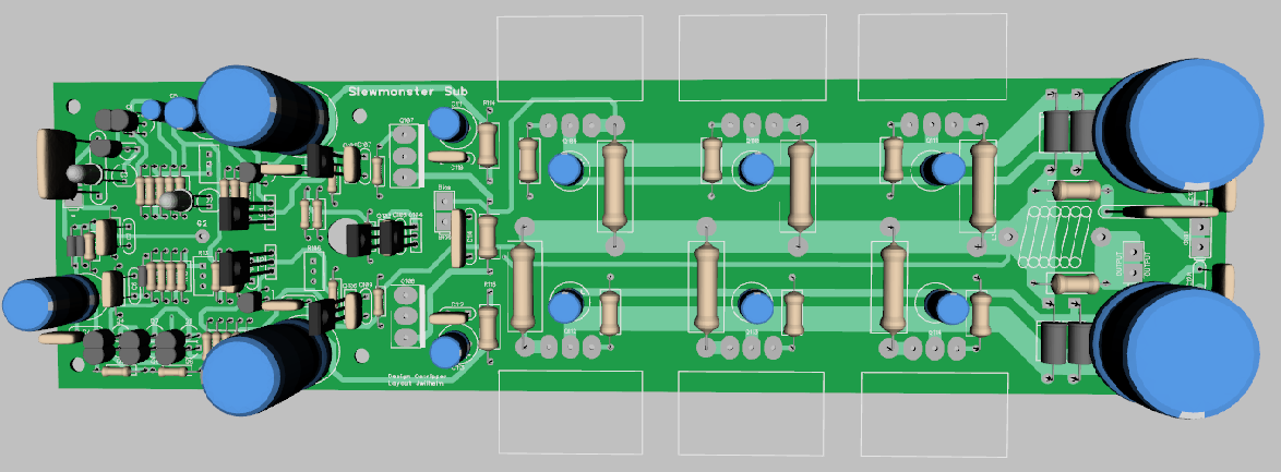

I've got my SlewMonster Sub amp drawn up.

Next generation "Badger" ! Some might want a pair of these for main amps ,
as well.

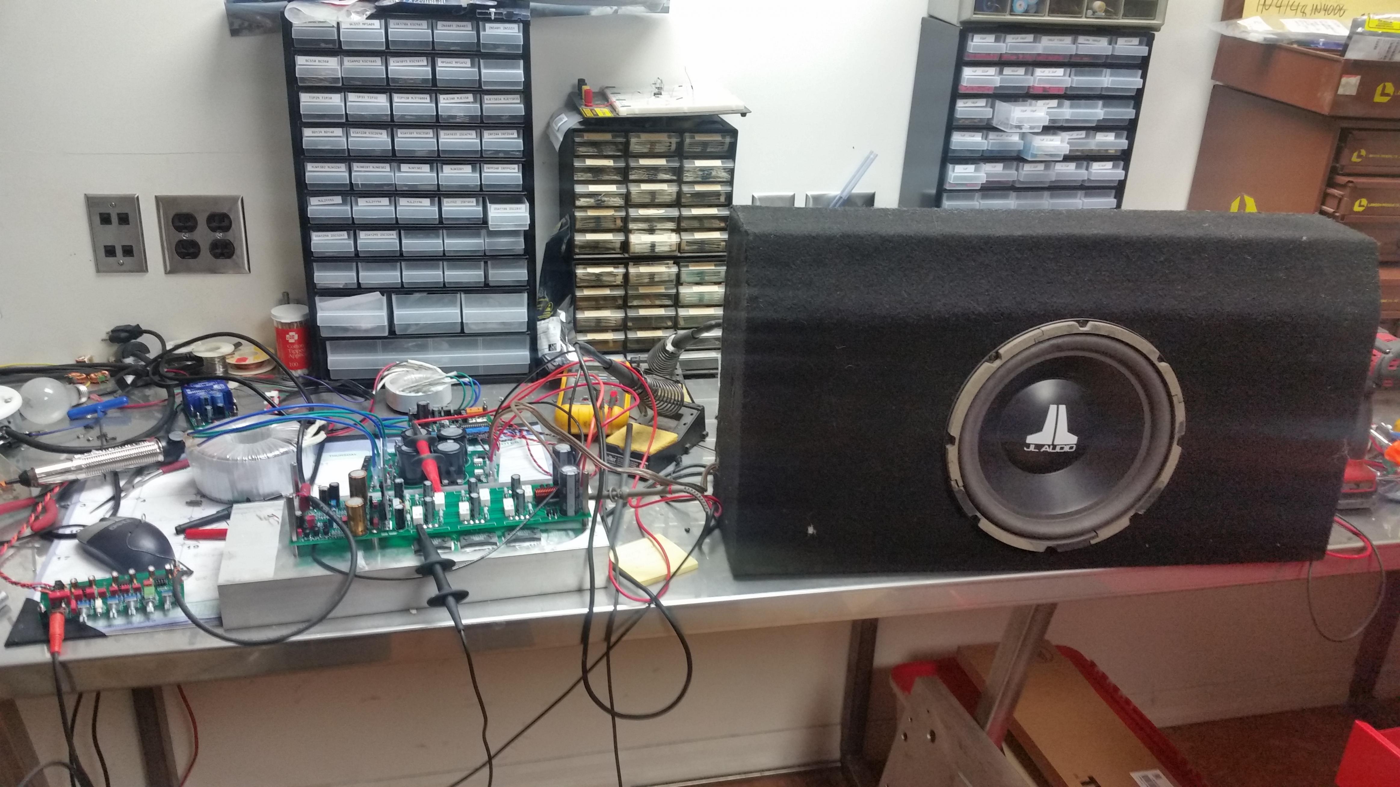

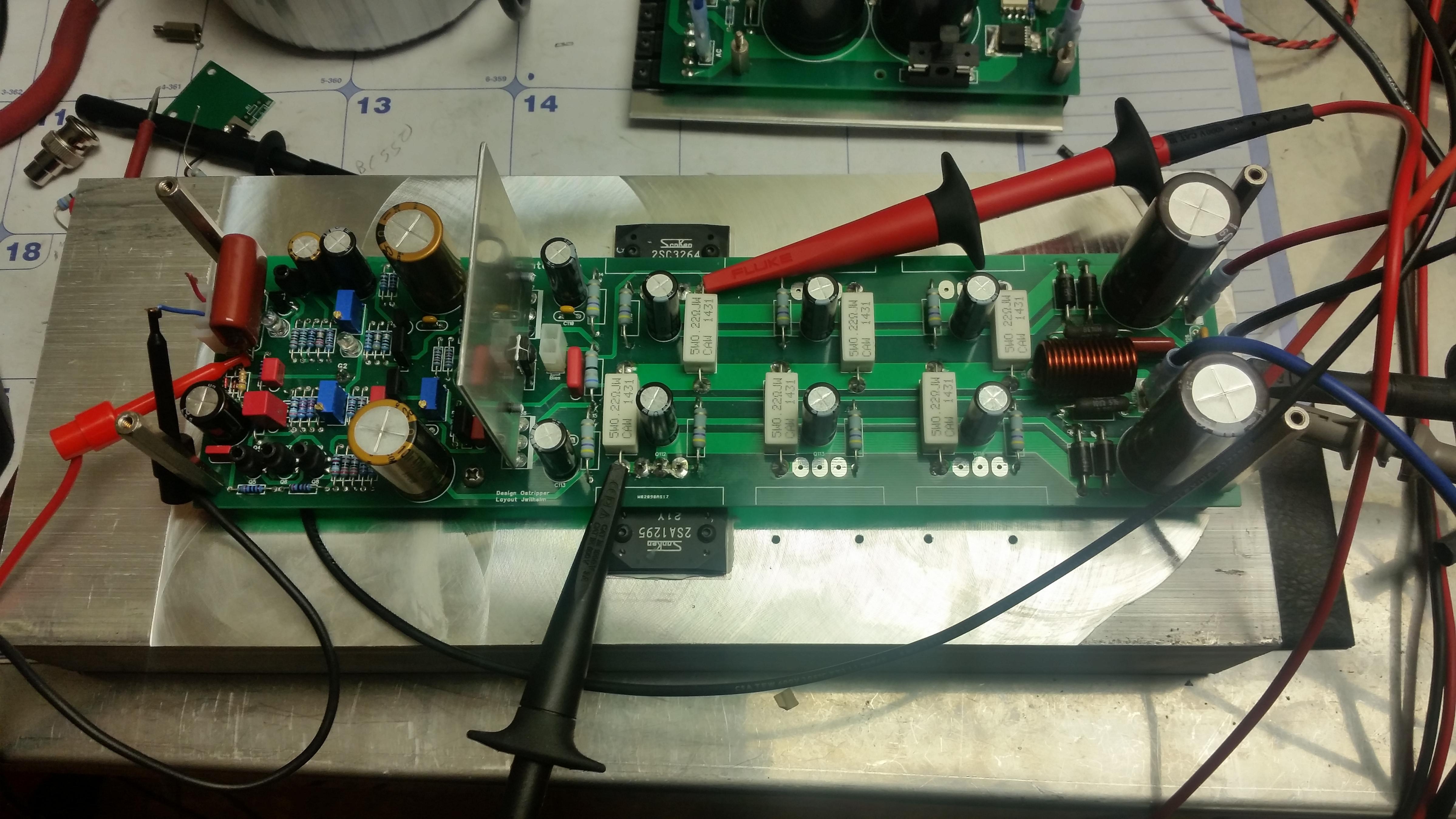

Initial testing with my POS scope looks good so far on the crossover. Waveform looks perfect up until full boosted volume, then it starts to get a notch in the leading edge of the waveform peak. It starts to attenuate power below 33hZ. 3db drop is around 27 hZ. It can be extended lower with boost but I'm going to do a little tweaking to see if I can get it to run lower.
The JL Audio "250 Watt" amp that used to run this driver never moved the cone like my 250W Slewmaster does. It's a quick way to clear the work bench! Crossover works great too.

Next I need to build a test box for one of my ACI subs and try it out. Once the box is sorted out I can design the heat sink and put all this stuff together. I'm actually surprised how cool the amp runs. It's just screwed to some 6" channel. Running the amp at clipping barely gets the output devices above 100F.
