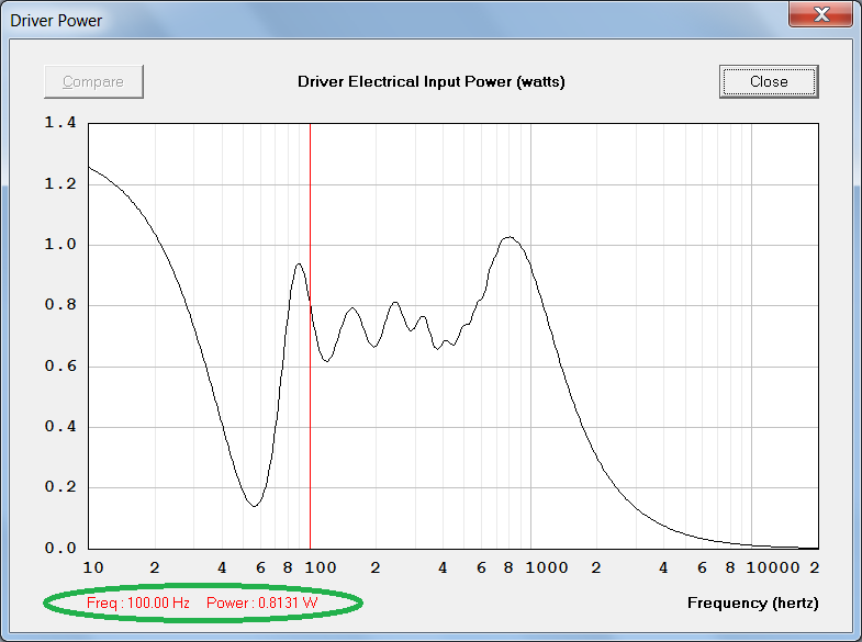

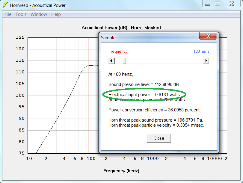

Could someone shed some light on the calculation of SPL and electric power consumption?
For my horn sub, Hornresp predicts about 110db (1 w 1 m). This should be pretty loud.
In that condition how does one calculate the electric power needed?
370 ft^2 is a little smaller than my room and 110 dB/W/m + some room gain is pretty loud, though to hit the 115 dB/listening position THX cinema reference up around 80 Hz with a little dynamic headroom will require another 5-10 W, so using one of the [so far] recommended prosound amps for other than its DSP is incredible 'overkill', i.e. a little 20 W chip amp is all you need.
Every 3 dB is a doubling of power, so +3 dB = 2 W, +6 = 4 W, +9 = 8 W, etc., and since sound power rolls off at up to 6 dB/doubling of distance, then 2 m = drops down to as low as 104 dB, 4 m = 98 dB, etc., though a typical HIFI/HT room usually limits it to 3 dB or less.

For my horn sub, Hornresp predicts about 110db (1 w 1 m). This should be pretty loud. In that condition how does one calculate the electric power needed?
Hornresp does it for you - see attachments.
