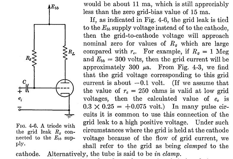

It appears Falstad does not model grid current for positive grid voltage.
I could try with a less-simplified tube model, or feed the dogs now. You're there, they are here, I know my duty. Maybe later.

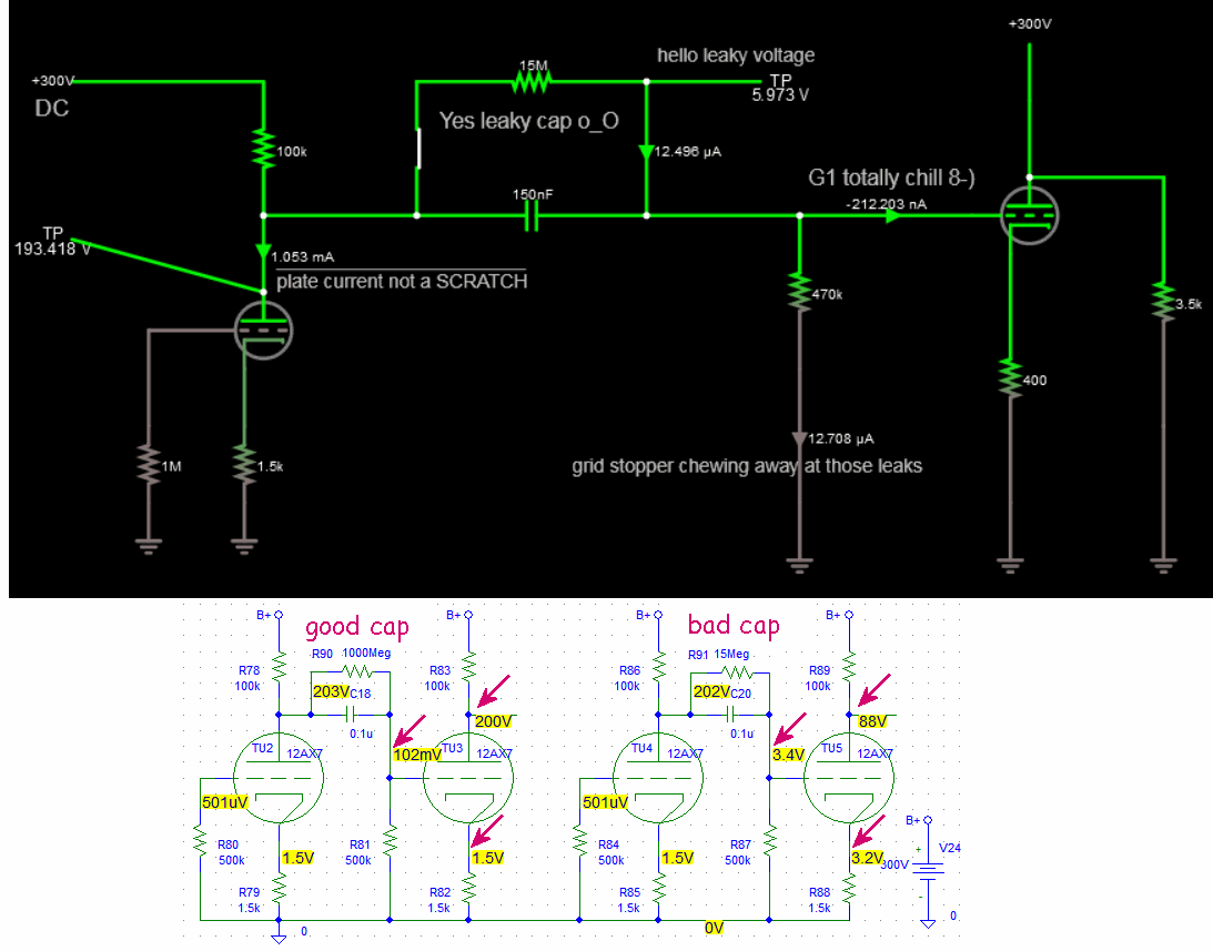

Here's simple 12AX7 stages, cap-coupled, with two values of cap leakage.
With "good" (1,000Meg) cap leakage, the second stage grid sits 0.1V positive of ground for -1.4V bias grid-cathode. That 2nd stage plate sits at 200V, what we expect for 300V 12AX7 100k 1.5k.
With "bad" (15Meg) cap leakage, the second stage grid sits 3.4V positive of ground, cathode at 3.2V for +0.2V bias grid-cathode. That 2nd stage plate sits at 88V, far below what we expect. The positive grid-cathode voltage means large grid current and LOW grid impedance (we expect 499k, we probably get 2k), and dropping further on positive grid swings, causing gross 2nd harmonic distortion.
FWIW, a 12AX7 with these values will NOT be "hurt" by 15Meg from a 200V preceding plate. The 0.04 milliWatts of unexpected grid dissipation is outside the ratings but won't cook the grid. It's just a bad amplifier. Try it.

Also those 6V of leakage being itself @ 13µA cannot affect bias by 6V since the plate current is much higher. There is no way this measly 13µAmps can do anything at all to a plate running at 1 053 000 µAmps. Also, the grid stopper can conveniently drown away even higher leakages before they ever reach the grid itself.
It's not about grid current. But if you bias a, let's say, EL34 with a gm of 11 mA/V 6 Volts off it's nominal operation point, it will carry 66 mA more plate current. The question is: How long will this tube cope with that? And how long will it's periphery, especially the output transformer do?

Yes, although it needs to be said that in the normal cathode bias case, elevating the grid by 6V does not mean 6V more bias because the cathode voltage will rise too and partly compensate. Which is one reason why cathode bias is popular.Kay Pirinha said:But if you bias a, let's say, EL34 with a gm of 11 mA/V 6 Volts off it's nominal operation point, it will carry 66 mA more plate current.

Thank you again for keeping up with all of this mess. OFC I understand basic biasing concepts and valve operation in general. I have already built and tweaked one amp from a DIY kit and now trying something new from scratch. You can check out my second thread - much less futile exercise there.
I was clearly mistaken regarding the effects of leaking current on the next stage grid.
Thank you PRR not just for this but for so much detail down the road. I have really learned quite a bit since the start of the thread.
I'm trying to figure out why's the grid seeing this current instead of it going down the grid stopper. Because, isn't the grid stopper lower resistance to ground then the grid itself ?? What did I miss.
