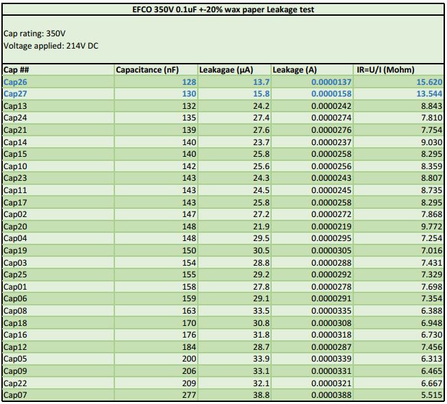

Okay, many of you made great points here, but, I couldn't rest until I was done with this
. You deserve it !
The results are really interesting as most of the IR values are directly proportional to the rise in capacitance values yes.
However, as far as I understand ppl should chill a bit about vintage caps
eh ? I mean all the doomsday and fireworx scenarios are really fun to read but... hey... What can possibly be disturbed by 10Mohms in any kind of a circuit whatsoever!?
Now the fun part: Who can guess whatssup with the first two caps in blue!? Whoever elaborates nicely on this first, gets a pair of those for christmas! Under the condition you honestly want to use them.
Ho ho HO...hO
Any tube stage with 1MOhm gate resistorWhat can possibly be disturbed by 10Mohms in any kind of a circuit whatsoever!?
Your measurements confirmed that you should bin the hole lot.
