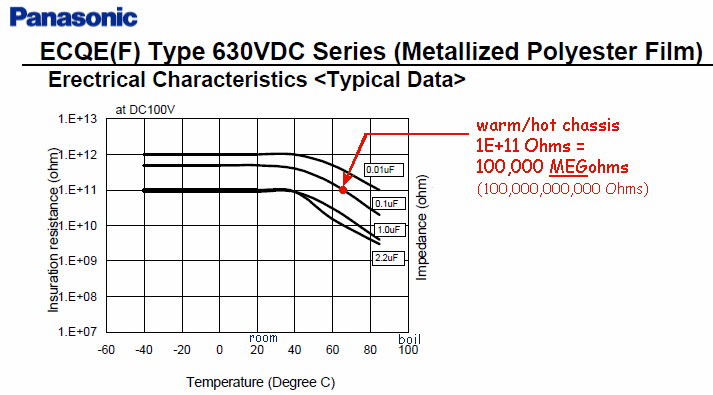

Generally, 1uA/uFd leakage is "Reject" for paper or film caps. So you should be seeing <0.1uA leakage. Good caps will settle down to much less than this.
Here's a random low-price thru-hole film cap factory spec:
Thank goodness for some sense.
So what are "Erectrical Characteristics"
So what are "Erectrical Characteristics"![]()
I saw that but didn't think it worthy of a
