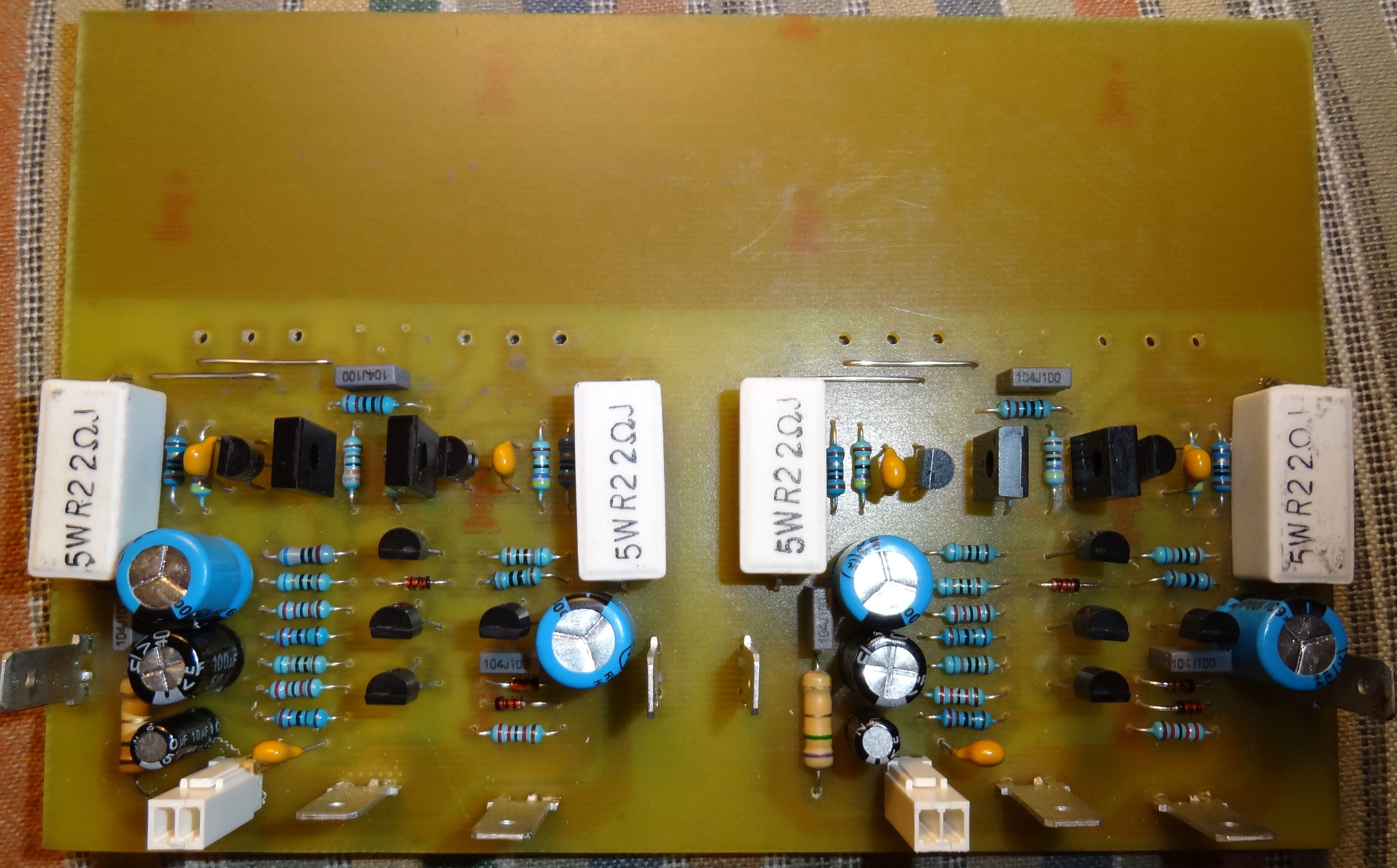

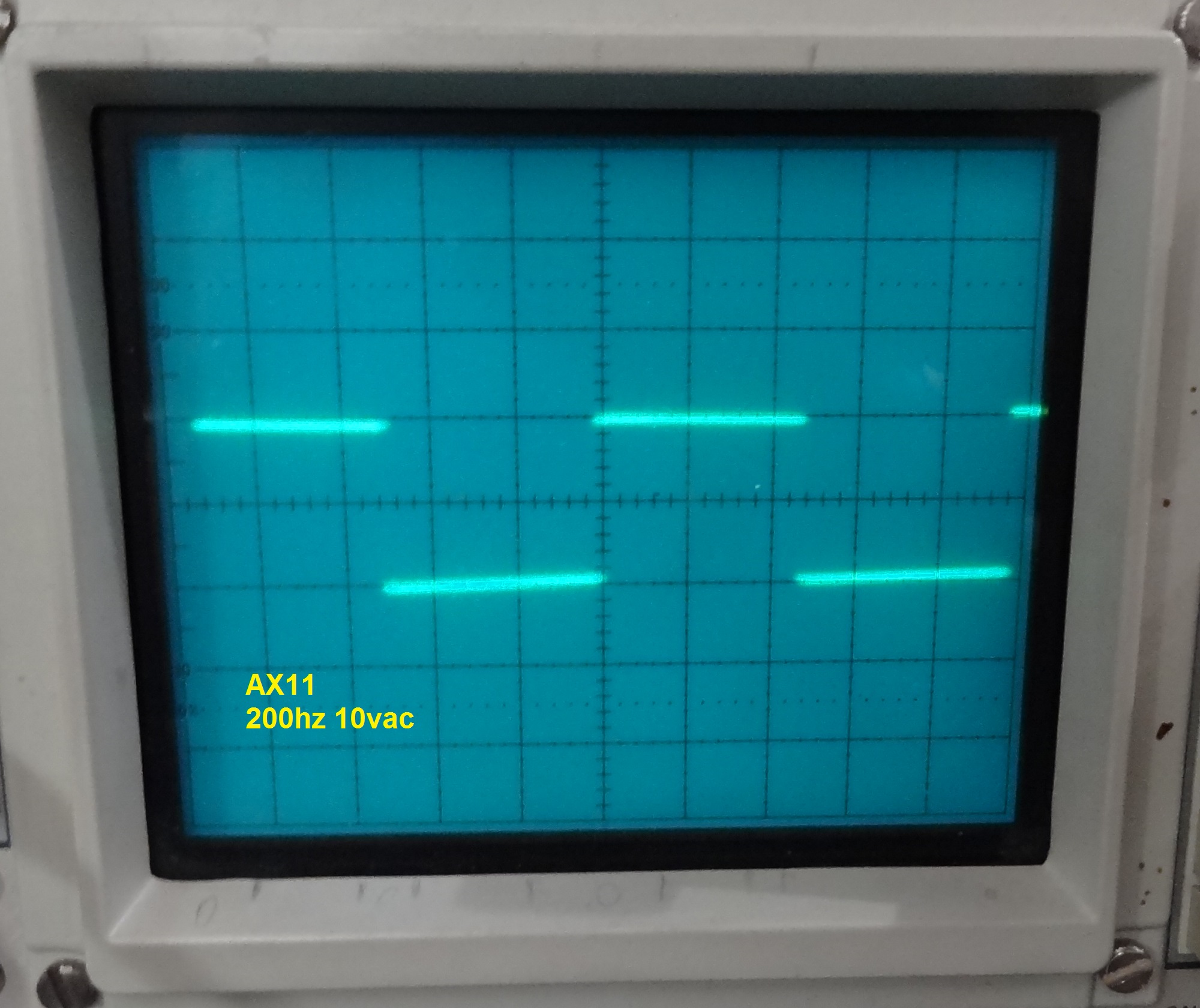

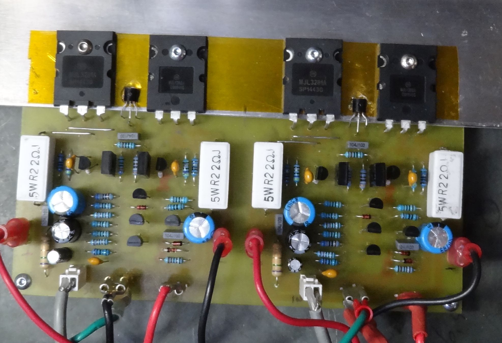

OK, I finished the AX11.
I have a few questions.
Bias is low. 2mv across the pair of R22 emitter resistors.
Gain is low. 1Vac input = 15Vac output.
Sine and square waves look good and music sounds good aside from the low gain.
I made substitutions based on what I had on hand so I am sure some of this is to blame.
I changed BC639/640 for MPSA06/56. (twisted legs for pinout)
MPSA13 changed to MPSA29
BD249/250 changed to MJL3281/1302
Suggestions?

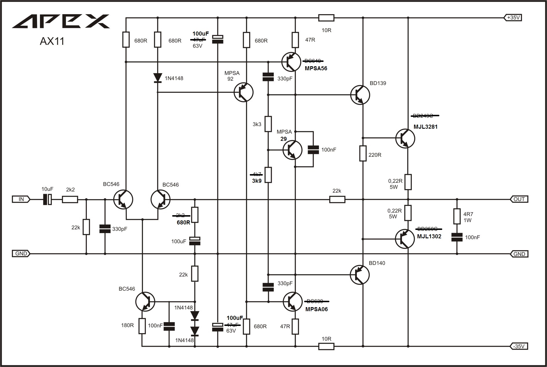

lots of incarnations of AX-11, from one sch I see
R7 is 22k and R8 is 2.2K
gain is 1+(R7/R8) = 11 or 21dB, seems correct

Yes, correct but pretty low without a pre-amp.

Replace R8 with 680R instead 2k2 to increase gain. Instead 4k7 use 1k trimmer in series with 3k3 resistor and set 20-30mA bias.

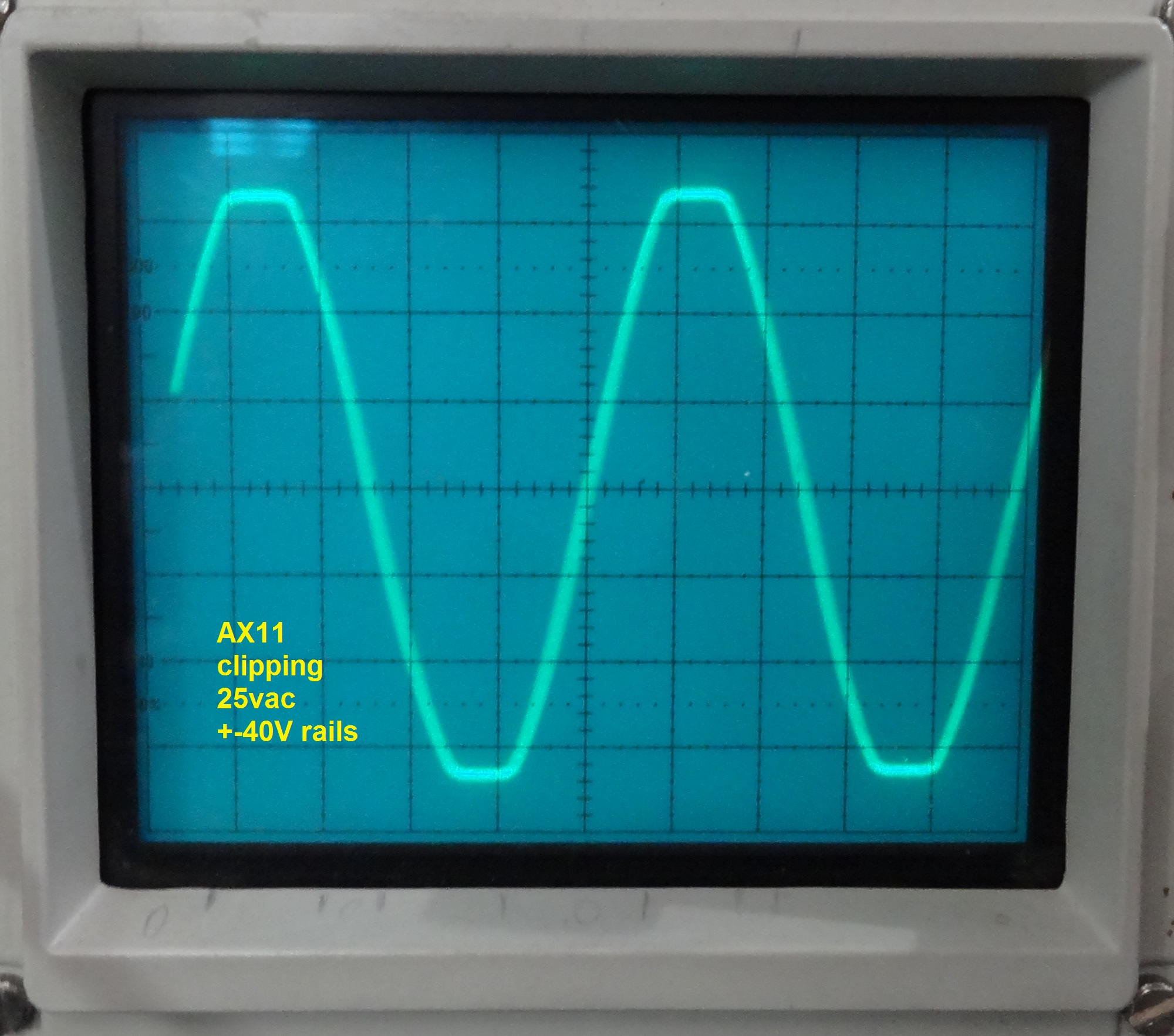

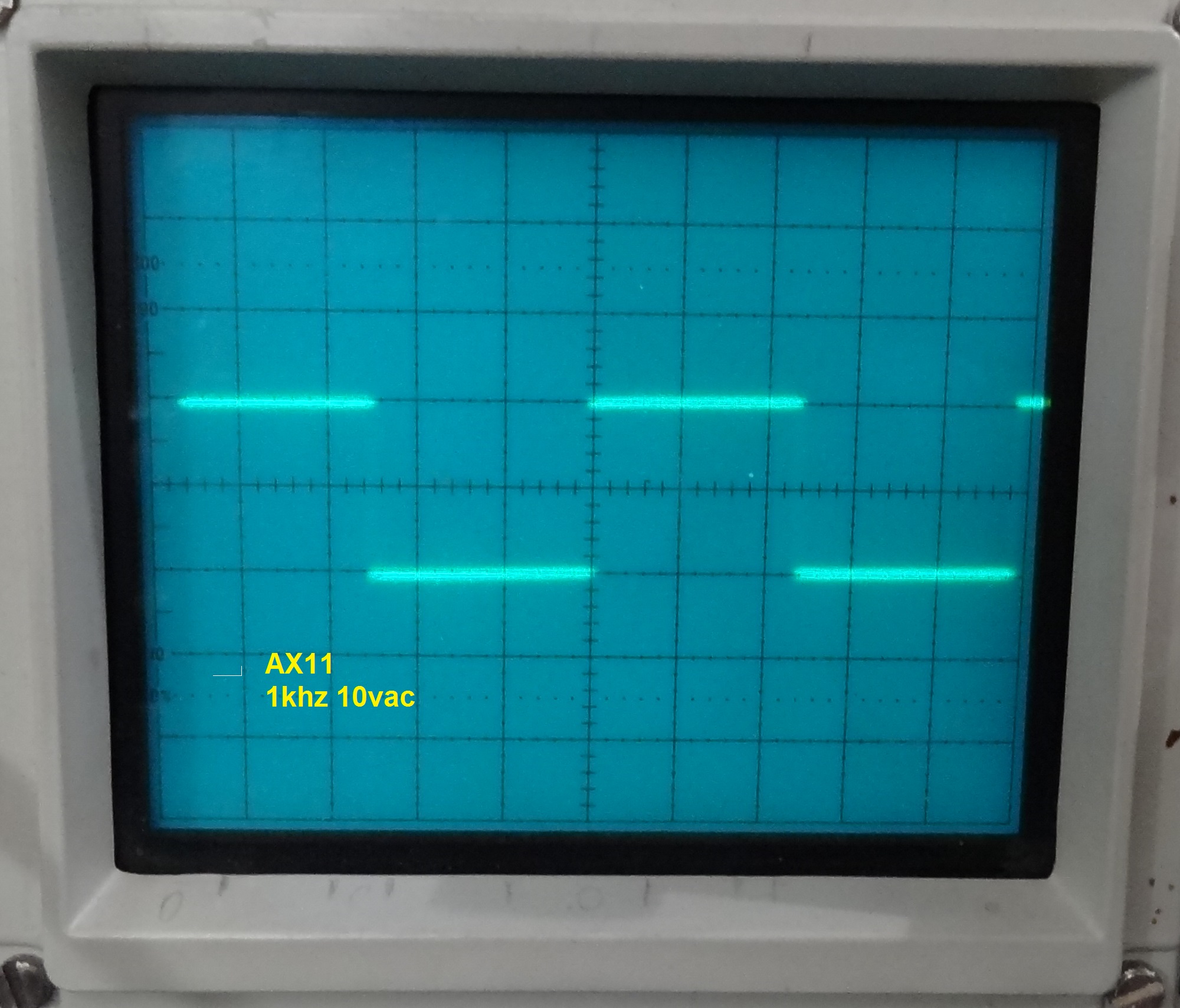

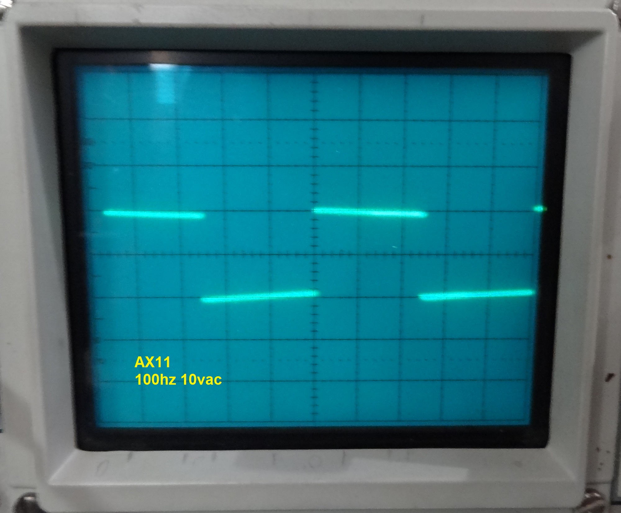

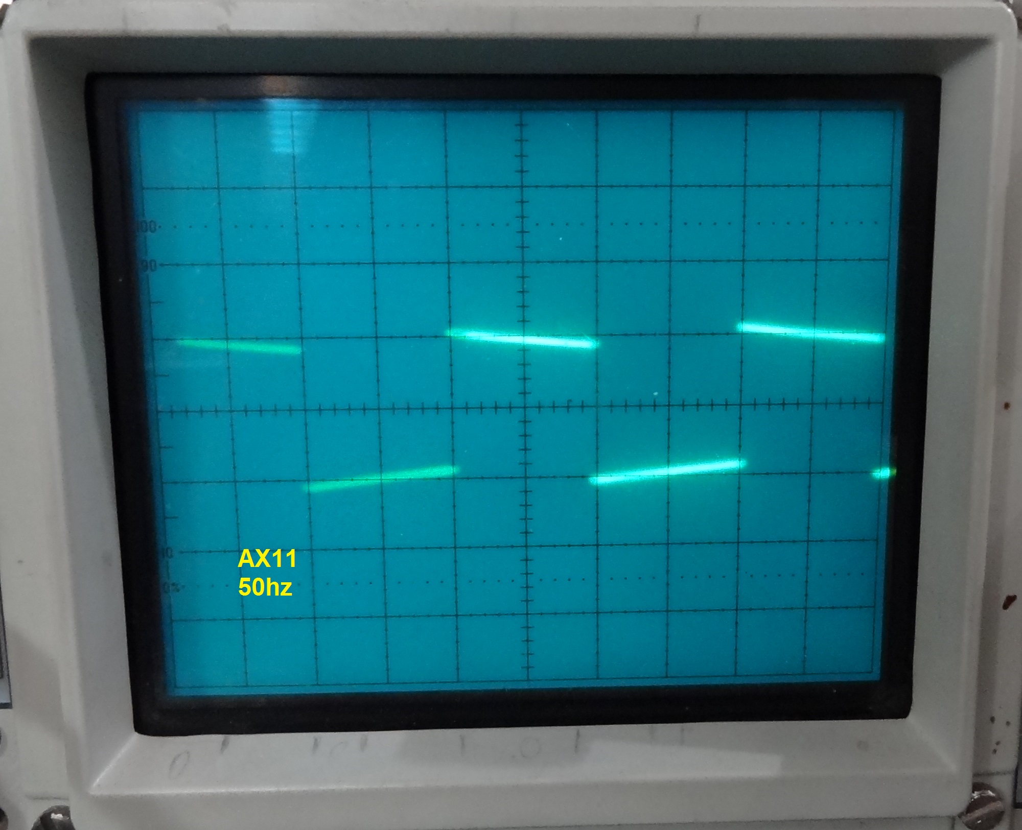

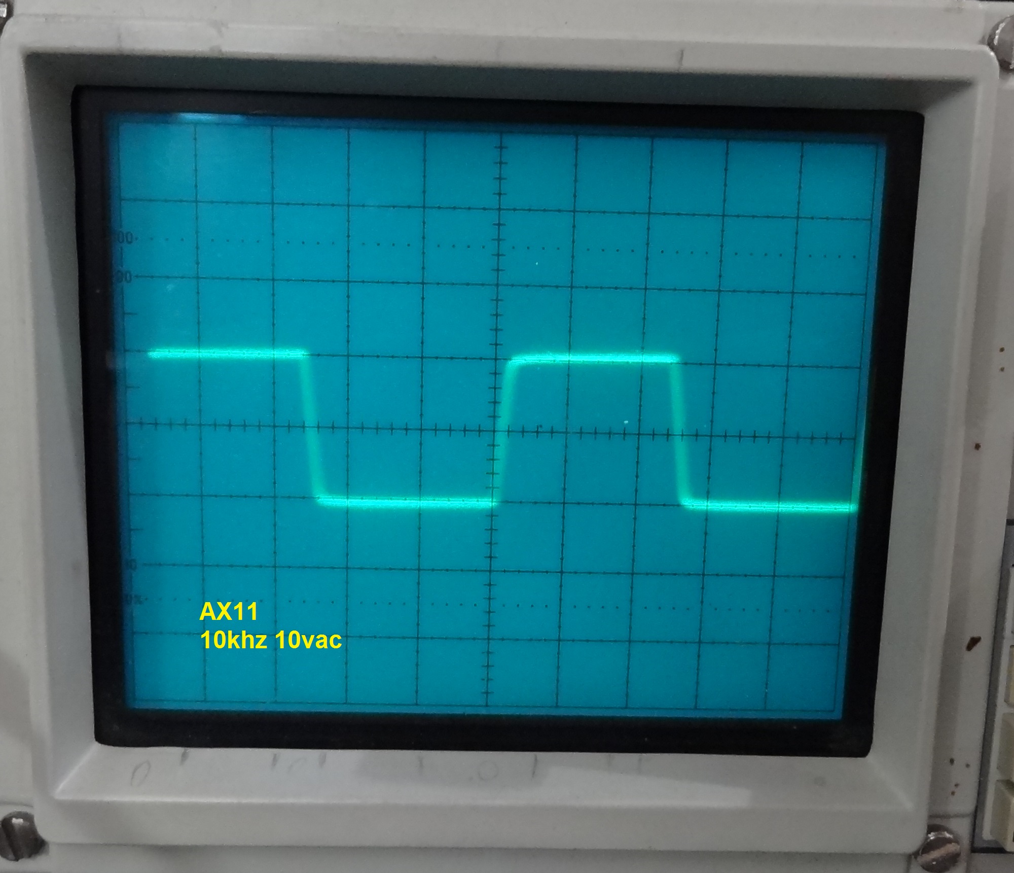

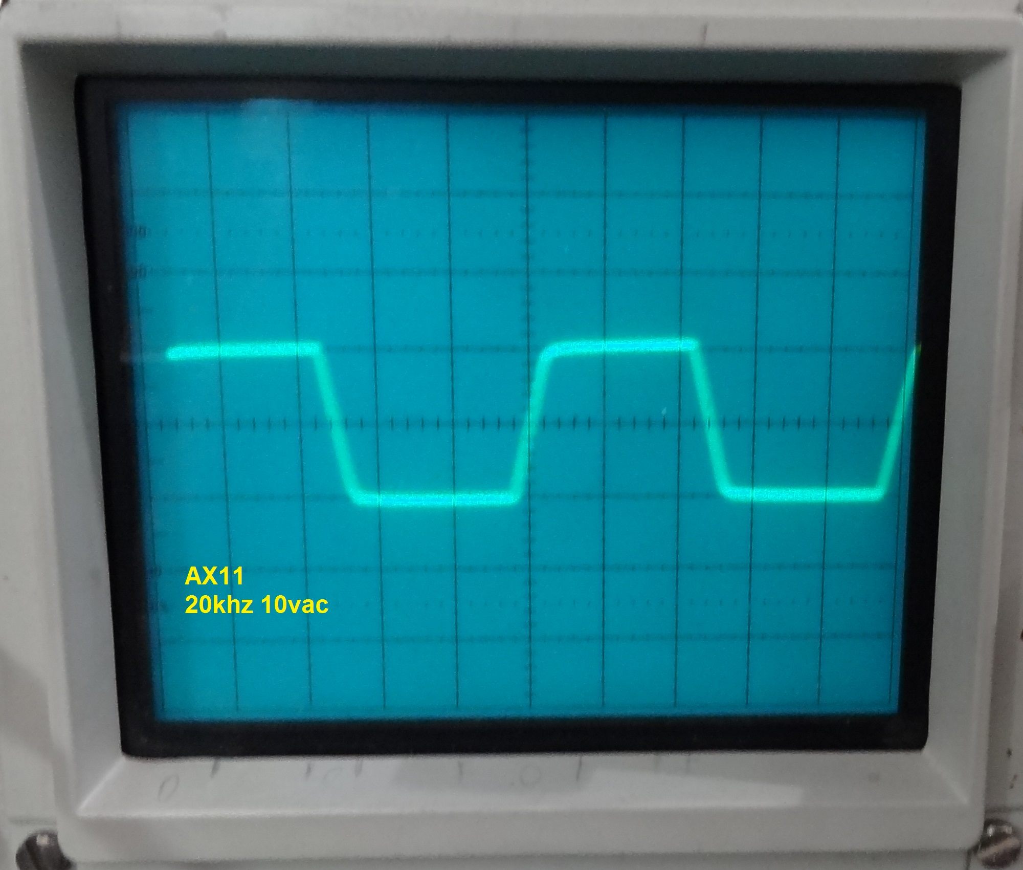

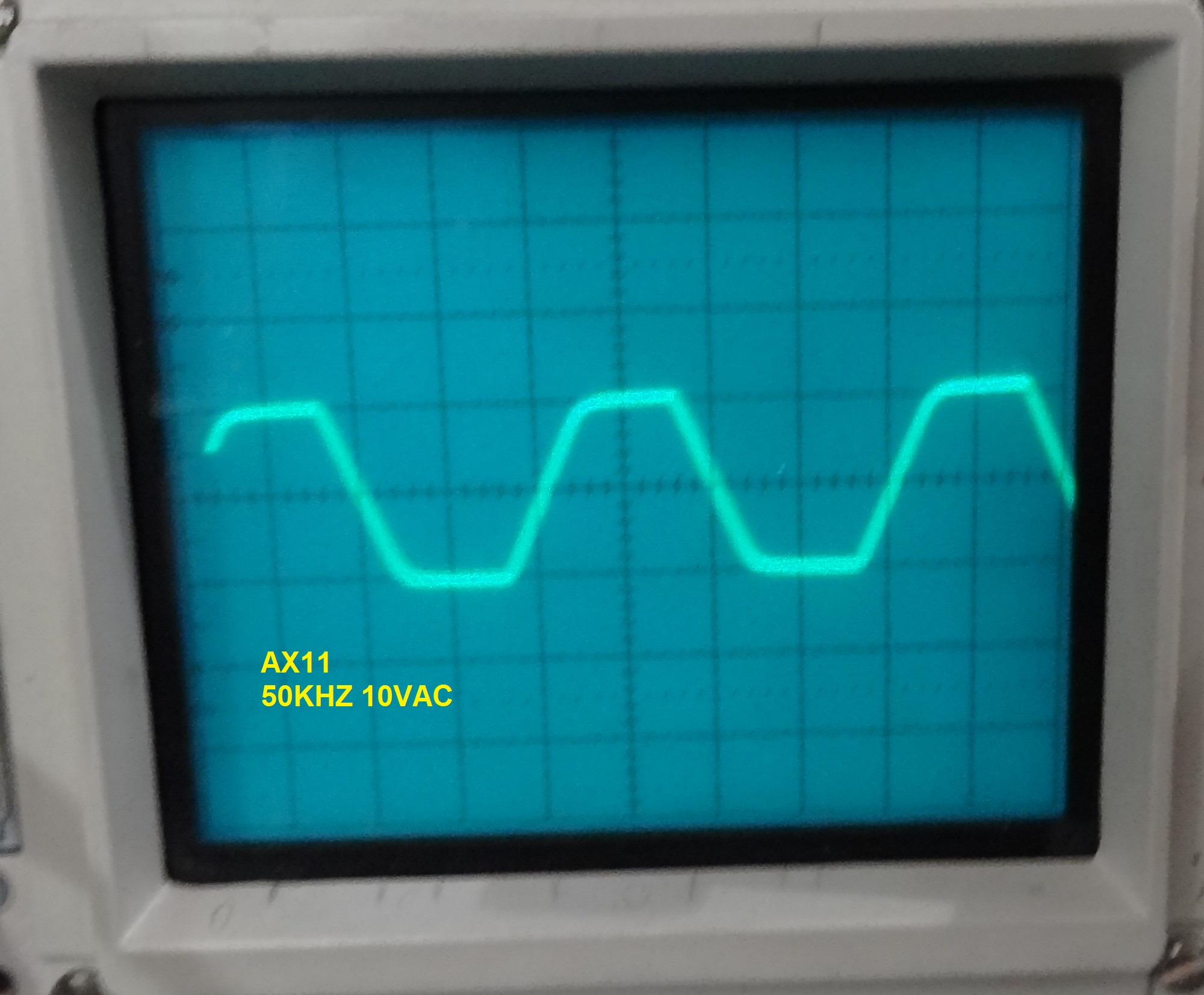

I installed the 680R. What I did with the bias was to parallel a 100k pot with the 4K7 and adjusted until I had 12mv across the emitters. Then measured the resistance at about 3k9 so I pulled the 4k7 and in stalled 3k9 in both boards. Once warmed up both boards are holding between 12-15mV which is around 30mA per. Gain is greatly improved. The amp now clips at 25V with .8V input. It clips soft. Squares look great in the audio range, especially in lower range.
I A/B'ed it against a Symasym and it is indistinguishable. Very nice!

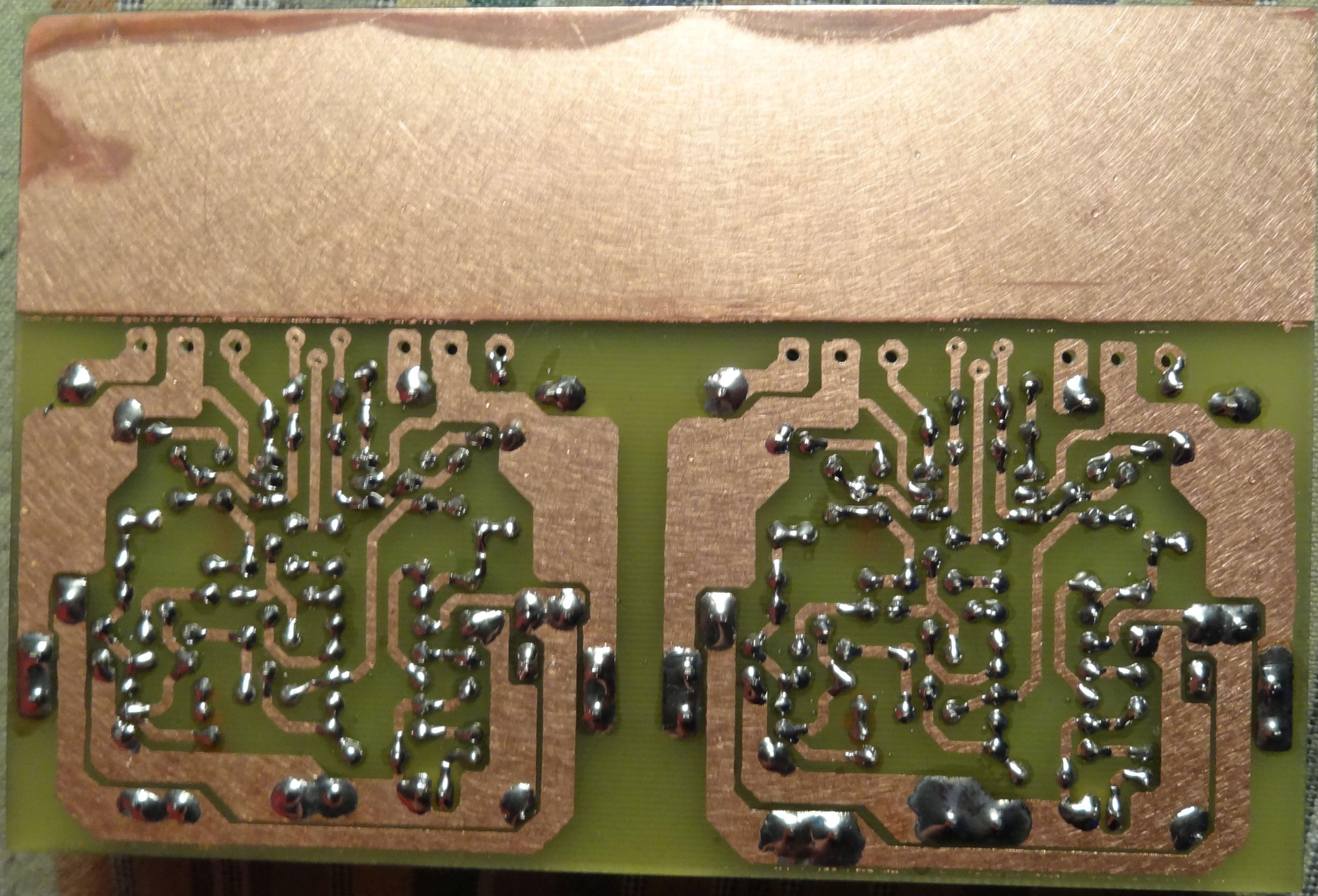

With less than 330pF compensation you could have even better square wave response, but for a simple amp this is very good. I used 100pF without problems and instead of 680R I used 1k (gain of 23). I am building my second pair of AX11 boards at the moment.
Still4, your sqw test signals have a slow slope.
What input filter have you fitted?
This is the asbuilt.

as ivan said,you would get better results with 100p or a bit more instead 330p compensations.
Use 470uF instead 100uF in feedback circuit for better low frequency square waves, 10uF on input can be shorted for test.
