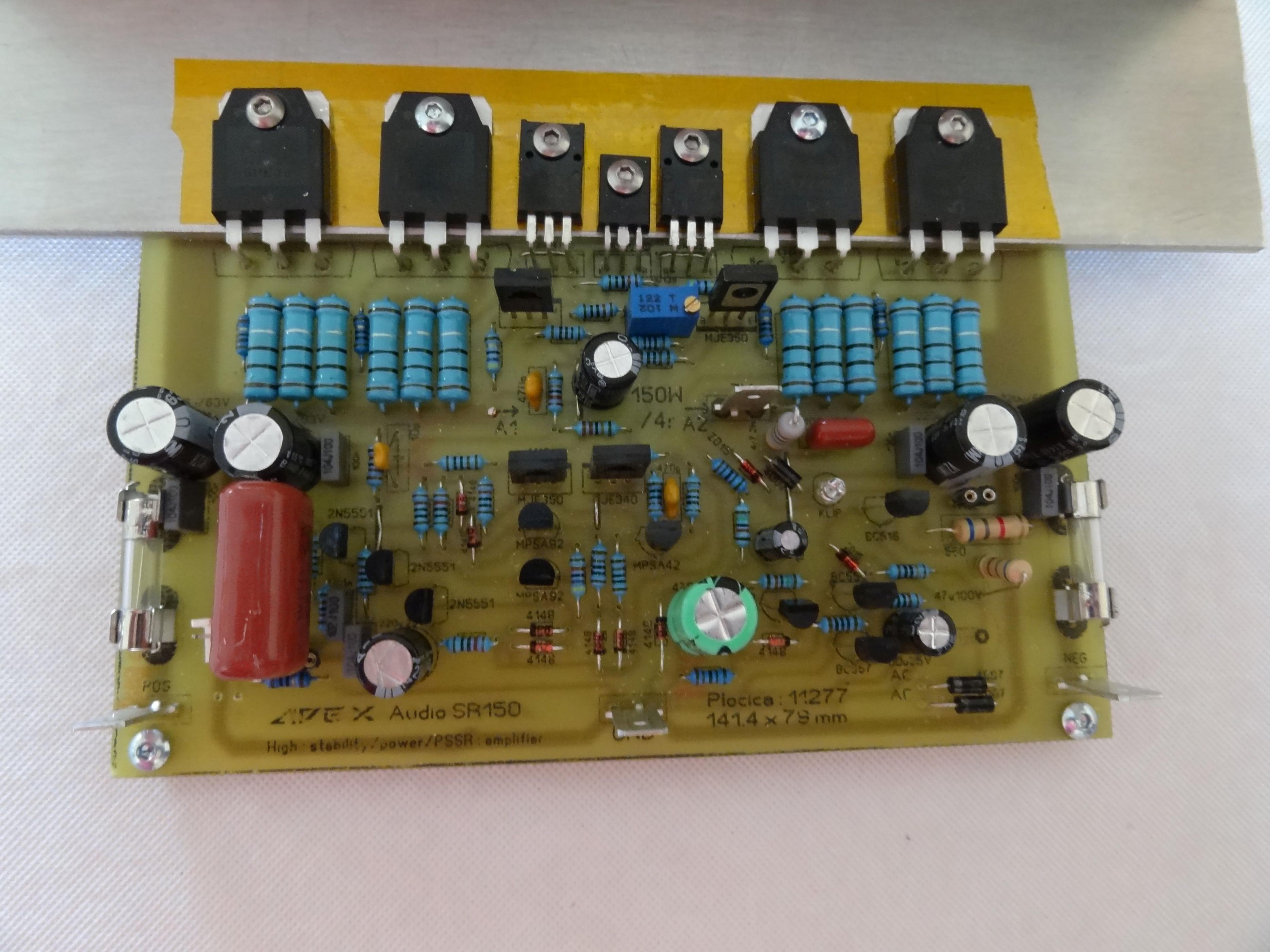

The layout does not follow that schematic. First off, the bridge only attaches to C4, R7 and R9. It does not connect to R10. Perhaps someone who knows the circuit could add the part numbers to the layout so it can be checked. I have the amp playing and it sounds wonderful. I would like to get the Zobels working as well.
One other thing, if you are pulling that 55vac from the main transformer, then the rails would be +-77v which is way too high for two pair of outputs.
The amp plays fine but with the trimmer set to 1R the most I can get is 9mA bias fully warmed up.

Amp rail is +/-55vdc maximum (2x30-40vac transformer).
Replace 220R resistor in series with 1k trimmer... use 180R or 150R and set bias 30-50mA.

Sorry, It didn't quote very well. I am attaching a pic. I see two AC inputs but they are shorted together. Shat is feeding them? Also there is a resistor labeled R rel. What is that?
Also same question on the 560R, what wattage is required?

R.rel is a resistor with value same as relay coil resistance. i did that because i have found a good text in ESP33 Loudspeaker Protection and Muting
Figure 2A shows an alternative method you can use to damp the back-emf from the relay, but to implement it properly, access to an oscilloscope is helpful (if not essential). If the resistors have approximately the same resistance as the relay coils, the back-emf should (!) be limited to about the normal relay voltage, give or take 50% or so. In the tests I carried out (see Tests, below) using a 24V relay, the back-emf was limited to about -30V, which would be fine in most cases.
This method is slightly cheaper than using zeners, but is less predictable. An additional alternative is to use a catch diode to the -ve power supply. A 1N4004 between the top of the relay string and the -ve amp supply will limit the back-emf to the voltage of the -ve supply, so for the example case this would be -40V. I expect that this would be quite acceptable, but have not tried it. Make sure that the diode is connected the right way around - the cathode goes to the top of the relays, and the anode to the negative supply.
AC points on a PCB should be connected to the AC points of bridge rectifier,it has been done by the schematics in post http://www.diyaudio.com/forums/solid-state/173462-studio-reference-amplifier-190.html#post4296935 . i draw that schematics as reversed one that APEX has given earlier. i have drawn an amplifier PCB and have had left a lot of space on a right side of PCB where is negative rail-the original schematics was for positive rail (emiter resistor from positive rail) so i reversed it/mirrored it to use it as it was more convinient for me. that is how i got it done like this.
you should use any transistor that has hFe larger than 200-300 in a place of 2N5401 to get it´s Uce as low as possible. i used BC516 (darlington) and relays on both channels tourn on in a same time and i have under 1V of Uce.
560r is not fixed value and it depends on how high is transformer rail voltage and what is relay coil resistance and defined working voltage. 2W should be enough in most cases,and value of that resistor should be as high as needed to get relay voltage in proper value,signed on relay it self. it is about 700 Ohm in my case.

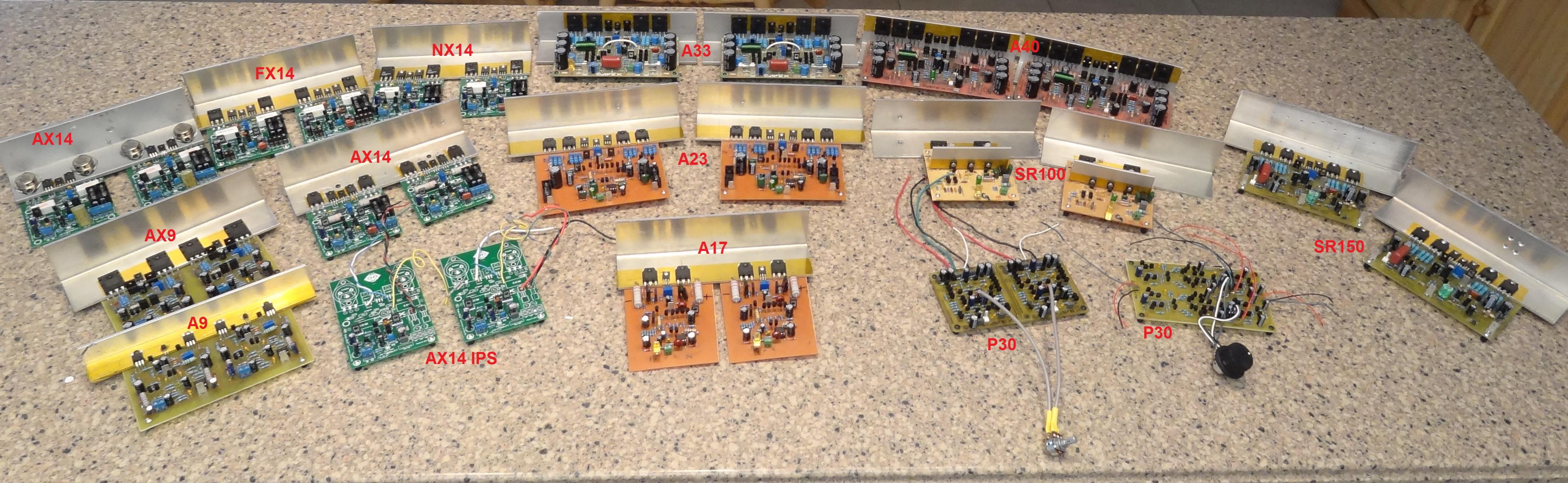

I dug through the stack and found I have built these Apex amps. A9, AX9, AX14, AX14 IPS, FX14, NX14, AX17, AX23, AX33, AX40, P30, SR100 & SR150. As I said my A40 is not working but the others all play perfectly. I can't say from memory which, if any, sound better than the others. If I get a chance in the near future I will try to do some close listening comparisons between them. That sounds like a fun way to spend a couple days. I do remember being quite impressed with the little A9. That one was a very pleasant surprise. I am pretty impressed with the P30 preamp that I just finished. It has good sound and a lot of output. It would be good for an amp that has low gain. The most impressing of all of these is the AX14 IPS driving the Slewmaster 5P OPS. A 250W CFA "Super pair" monster.
I'm attaching a pic of the collection so far.

Nice, can you post picture of SR150,
