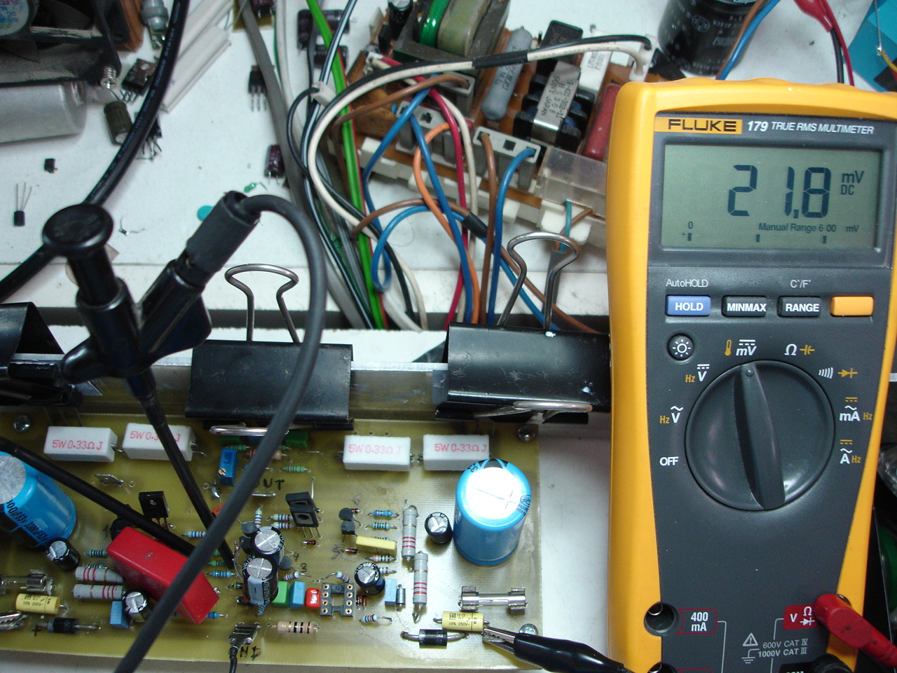

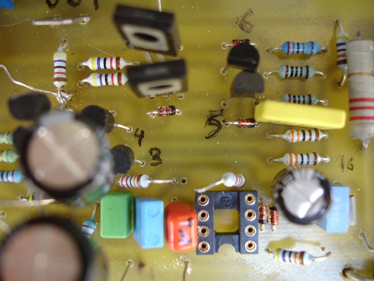

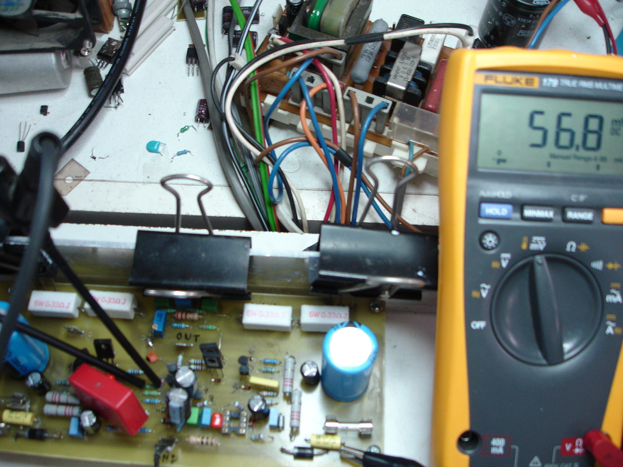

I apologize for this.
V from base to ground Q2=-10mV
V across R14(feedback res.)=100mV.
Sorry for this.🙁
What is voltages measurement on R34 and R35?
Zobel value in uH
V base Q2 to ground = 63mV
V on R14 = 59,6mV

I check again my SR200, now in cold heatsink... DC offset is 0,..mVI apologize for this.
Sorry for this.🙁
V on R14 = 59,6mV

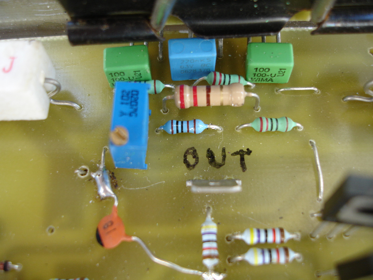

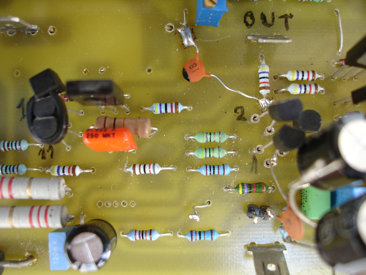

No, I use standard from Apex's schematic no changes... I will try that to solve my oscillation problem
I changed R24 to 2W & C 9 to 250V, high voltage there
Add 18pf capacitor or similar connected from collector Q9 to base Q2 to solve oscillation problem, inductor on speaker terminal is about 1uH.

V across R34=30mV
V across R35=30mv
Welcome Mr Mile!🙂What is voltages measurement on R34 and R35?
V across R34=30mV
V across R35=30mv

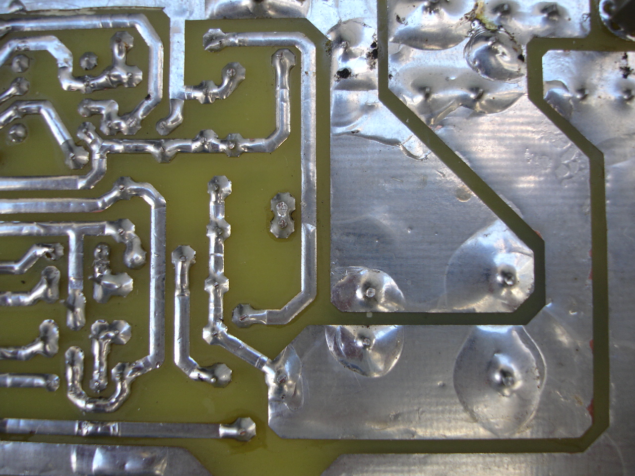

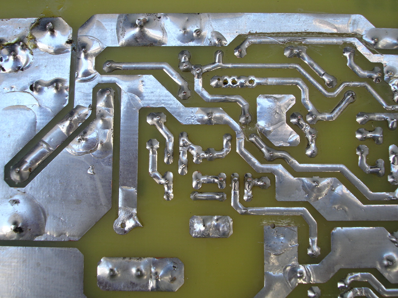

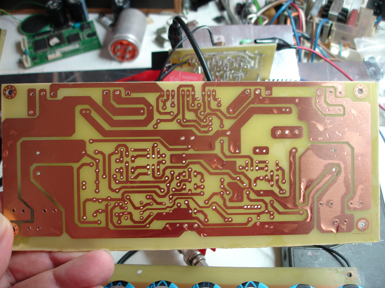

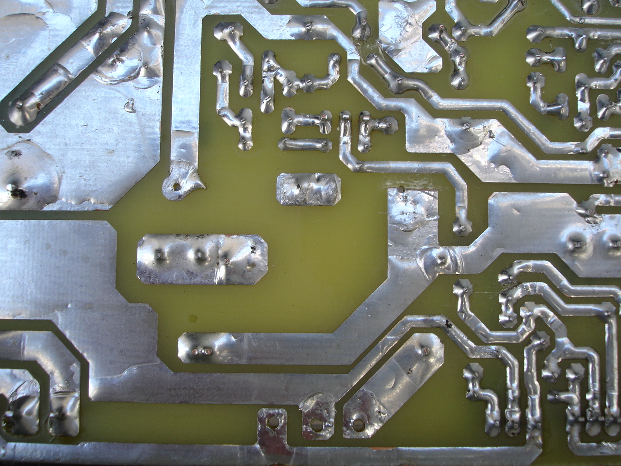

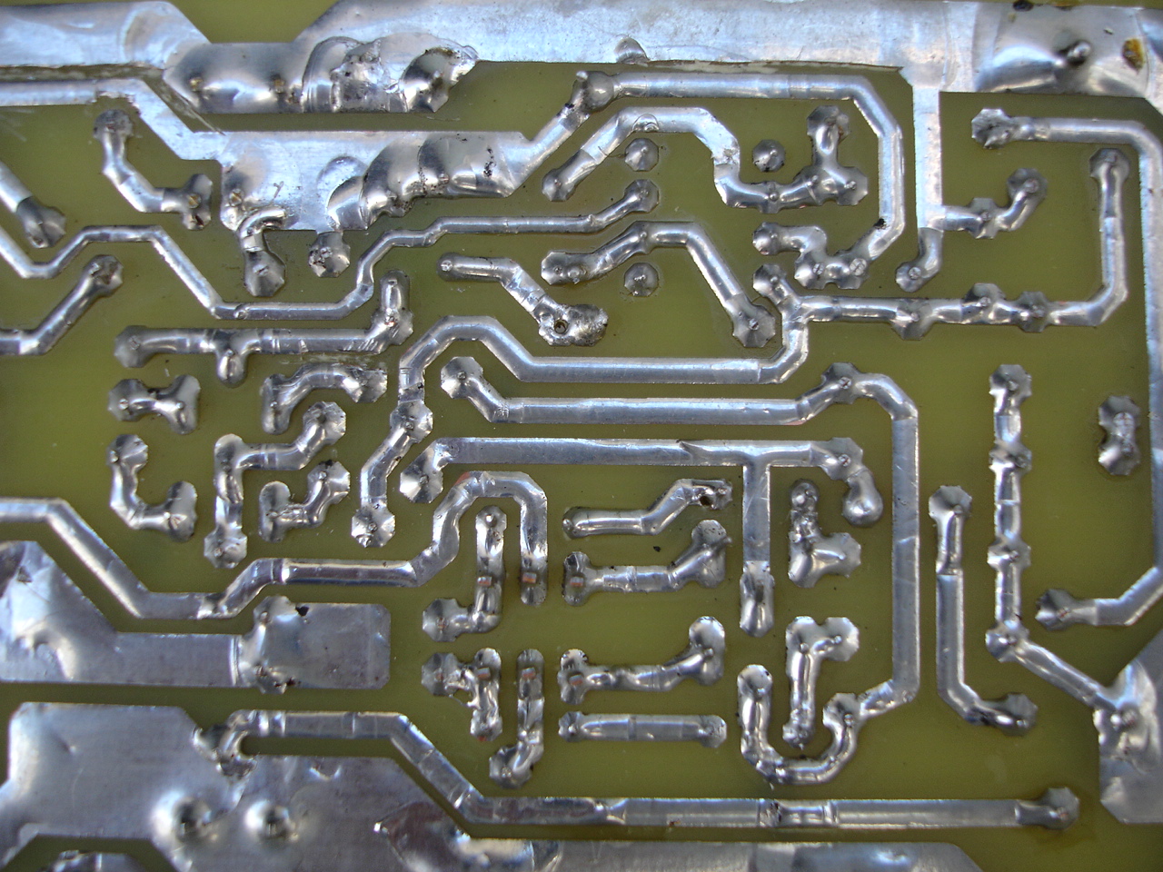

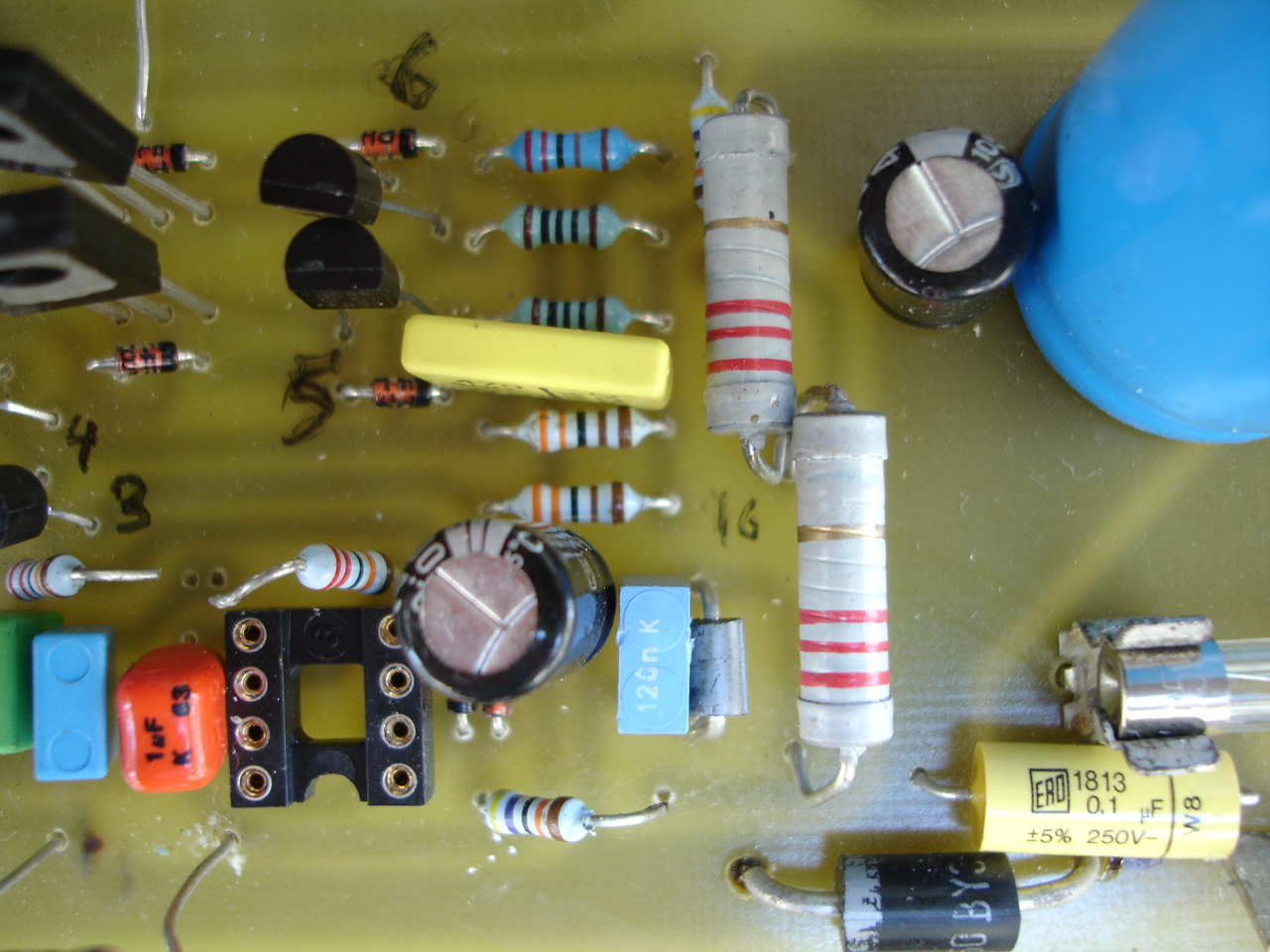

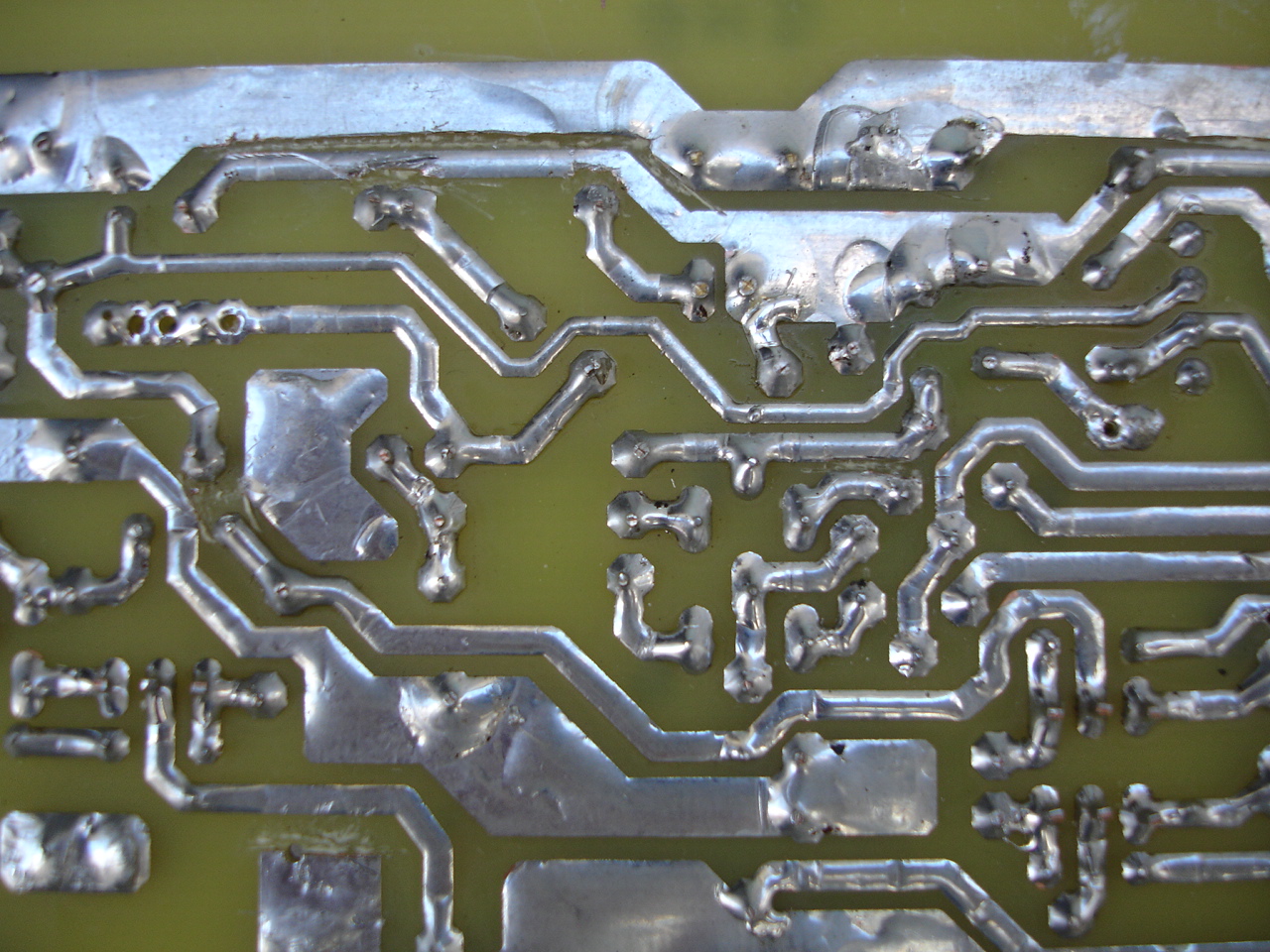

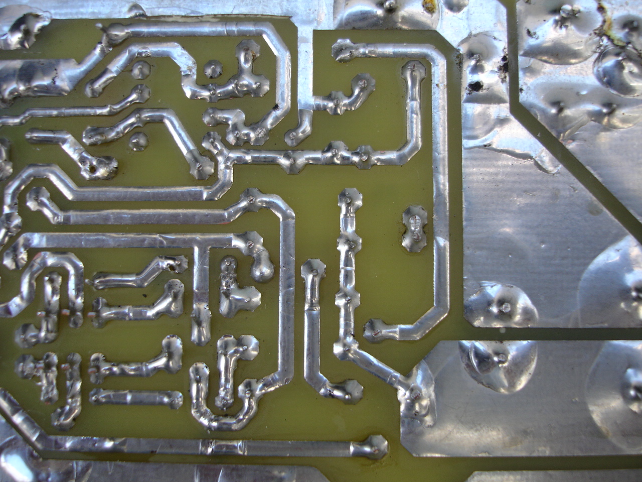

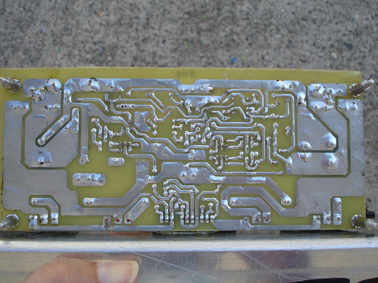

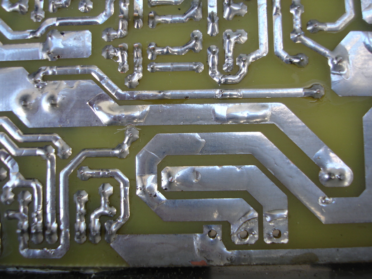

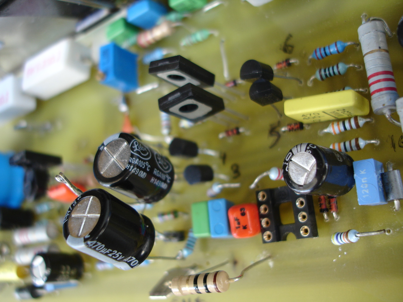

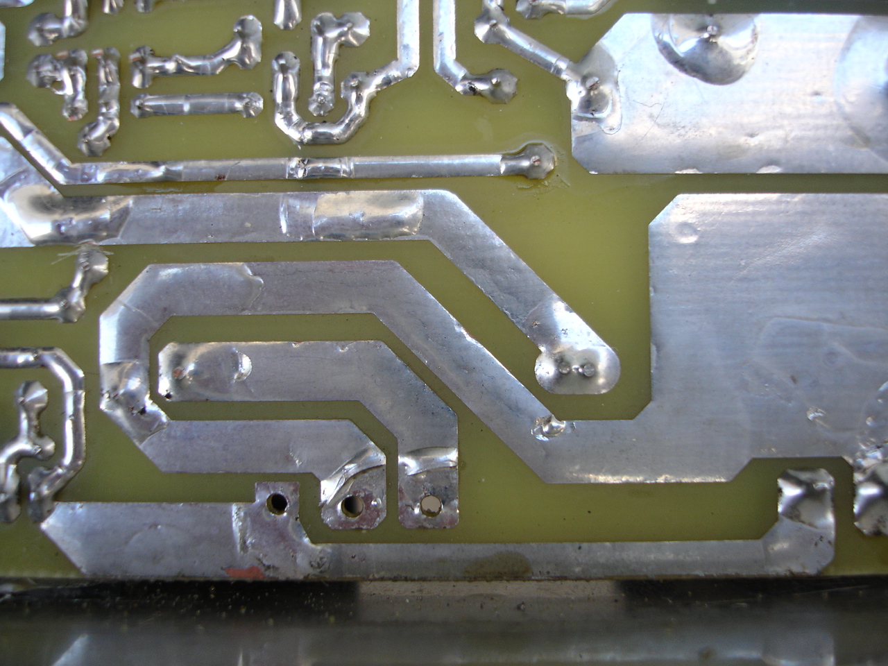

Some photos from serial🙂

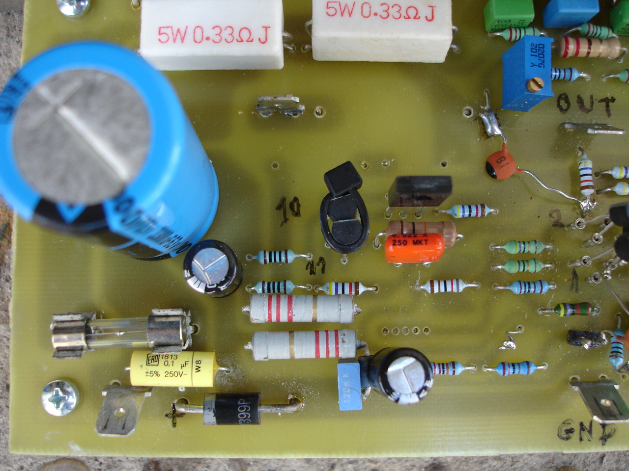

From the photos I can see no heat sink on your MJE's!!!
They are quite warm when I tested, in my mine they are with little heat sink...
Maybe that cause your problem, please try put little heat sink on them, with insulator for safety!
I guess the more heat the more unstable they are...
BTW bottom side just look similar to my build
Mje are quiet cool under test conditions.From the photos I can see no heat sink on your MJE's!!!
At first test mje has small heatshing on it.
Has removed this later for more comfortable test.
No the problem isn't here.
This pcb isn't same to your's
This pcb is Sanken vers. by Alex mm and i don't know if this is tested.
I examine this point to point but i can't see faults.
See here http://www.diyaudio.com/forums/solid-state/173462-studio-reference-amplifier-115.html post #1148 for your problem
In that post you can see the small heatshings on mje transistors.

Can't find error on pictures. 1.15mA R14, 0.53mA R17, 0.6mA leaks somewhere. I think you should measure currents on R14 to R17 path to find where it leaks. Collector currents Q2 and Q4 at first.
1.15mA R14 ?
Propably you mean R13.
Thanks for replay.
1.15mA R14 ?
Thanks for replay.
Yes, it's R13 not R14. Sorry.
@Bli John Widhi...Aha you finally found the problem...
I will modify my SR200 later...as Mr. Mile S. suggested.
Grounding MJEs HS, resistor value changes and 10pf caps are the hot issue here...I have no 18pf caps in my drawer, may I use 20pf? or just put 10pf as compensation caps?
Thank you so much...
Best Regards...

Hi mas Arif,
connecting in series your 20pf, you have 10pf
