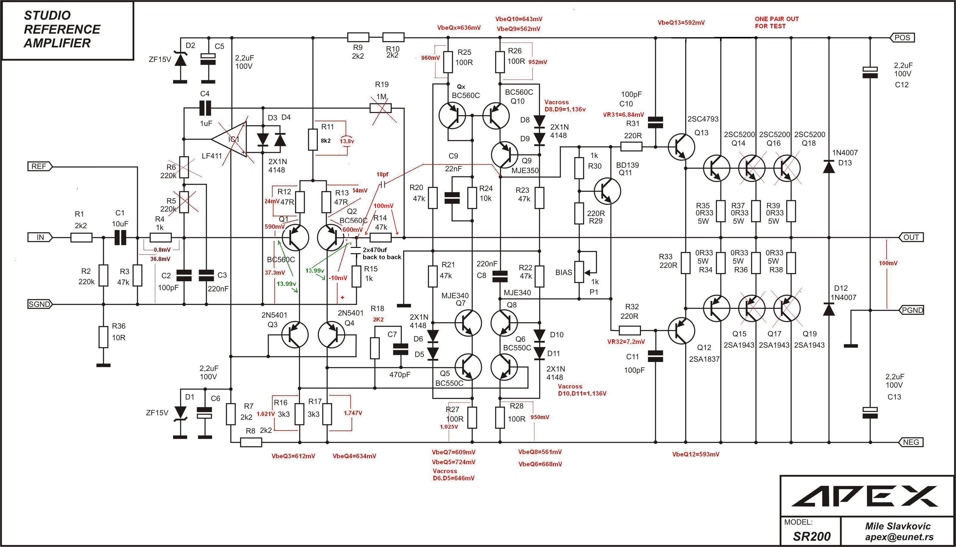

R12,R13 =47R/+-1% MEASURED an color code checking.
kirchhoff say I(R11)=I(R12)+I(R13)
1.65mA=0.51mA+1.14mA
V(R11)=0.00165*8200=13.53V Measurment on R11=13.8v
V(R11)=0.00165*8200=13.53V Measurment on R11=13.8v![]()

resistor checked, input LTP Vbe checked.
There is still serious imbalance in the LTP.
Now check the Vbe of the mirrors and the VAS.

Tkanks Mr, Andrew .resistor checked, input LTP Vbe checked.
I can check this as soon as i can.

Ok here again.None of those are broken. But too much variation.
Now do Q5, 6, 10 & it's partner.
Ok here again.
0mV on base Q2 vs gnd looks impossible, please measure it again and check for errors. Anyway, if it works ok why bother?

I try to remove servo .
Apex say .....without servo and with unmatched LTP transistors the expected
offset is about +/-10mV.
In mine case offset without servo is 100mV with matched transistors

Suppose output offset is +100mV. Left pin R14 is lower potential and current flows where? Capacitor blocks it from R15, and reverse base-emitter Q2 blocks it there. Even more weird, 54mV R13 suggest counter current. If measurements are not accurate, maybe problem is not accurate too?
And if suppose -100mV output offset, R13 is prime suspect. Look for some short circuits on layout, R13 to emitter Q2 connection.

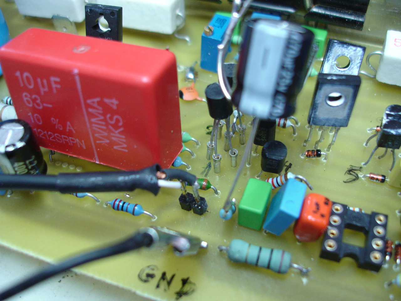

this what I got:
with servo & rail +/-43V
R11 =14,96V (15,59V on the zener)
R12 = 23,3mV
R13 = 23,6mV
R16 = 1,531V
R17 = 1,548V
R25 = 880mV
R26 = 856mV
R27 = 860mV
R28 = 882mV
DCO = 0.1mV (with TL071)
without servo anything not changed to much only DCO = 1,6mV 😉
(I only lift R5 & add a bipolar cap on R15 see attachment)
I try to match all transistor to it partner, they are closely matched
that why I get very small DCO when servo is disconnected
I have my own problem, when I connect input to ground with cable I have smoke on the zobel resistor without speaker connected.
When the speaker connected it all okay but when I disconnect that happen...
Now I must find what wrong with this 😱 btw maybe because the cable is to long

I have a another qwestion .Is any 18pf capacitor or similar connected from collector Q9 to bace Q2 in your amplifier?
Thanks for all.
Now it's clear that it's my problem.
No, I use standard from Apex's schematic no changes... I will try that to solve my oscillation problem

I apologize for this.0mV on base Q2 vs gnd looks impossible, please measure it again and check for errors. Anyway, if it works ok why bother?
V from base to ground Q2=-10mV
V across R14(feedback res.)=100mV.
