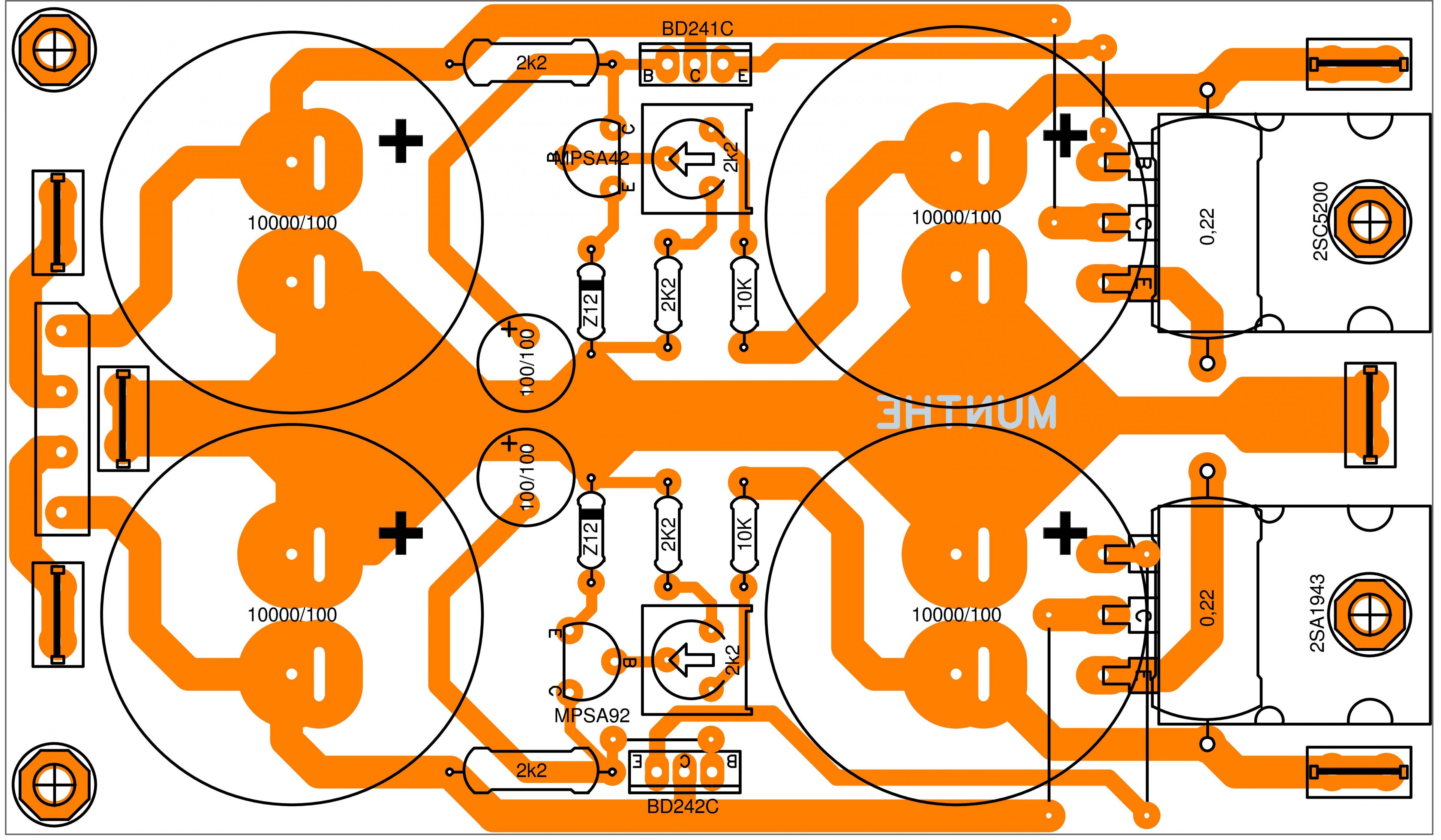

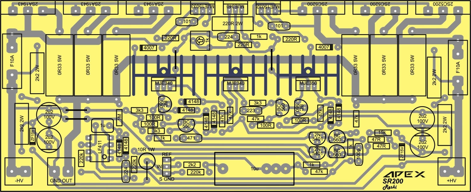

Mr Mile Apex or anyone else, if you have a little time you can correct this regulator I did not change anything except the component layout.
Nice PCB, just use separete layout tracks from 0,22R to cap pins and from output to caps.
Regards
Regards
thanks Apex, if I could use this PCB? whether there are any lines in the correction please, thank you.
You can use this pcb without any correction.
Regards

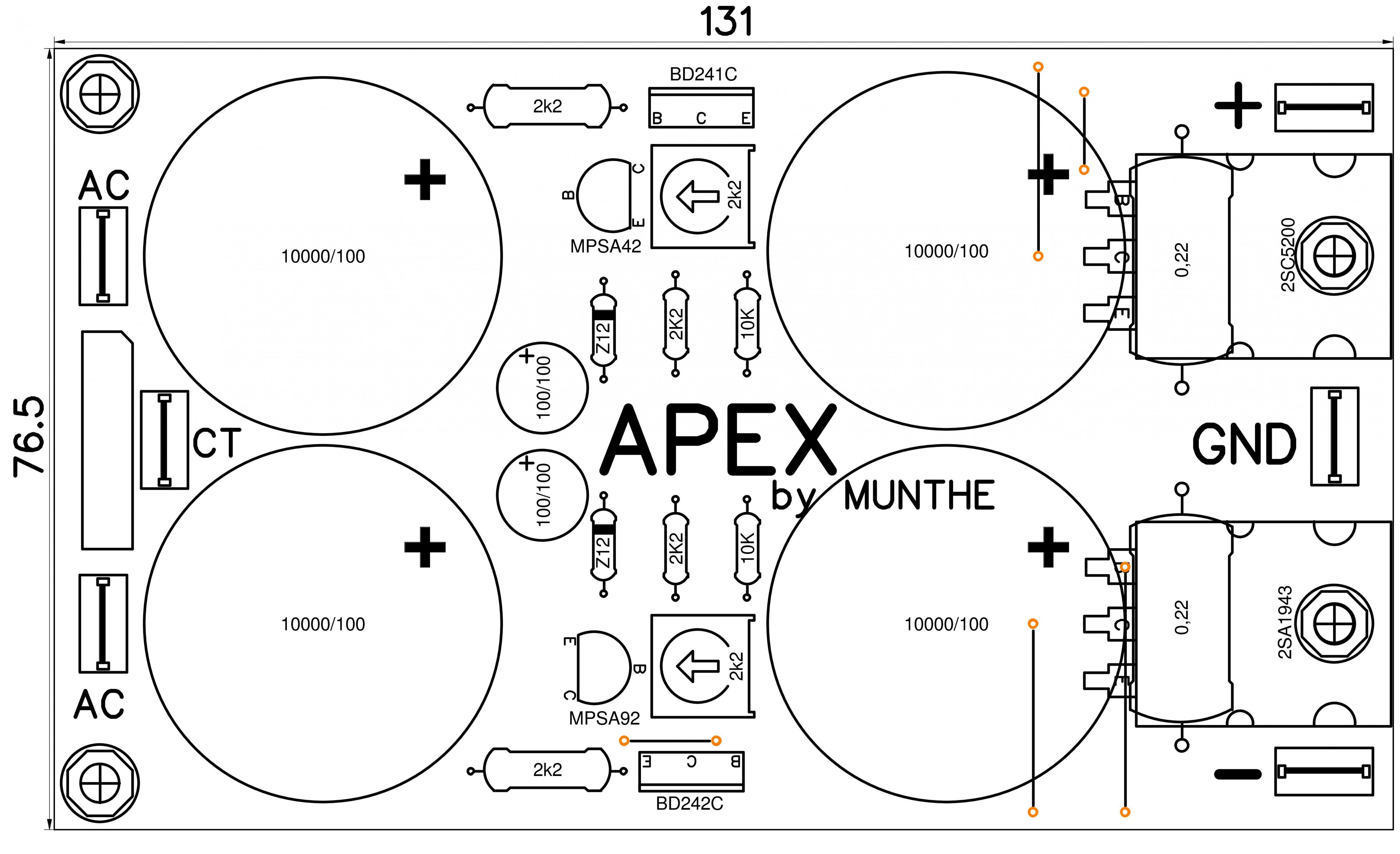

PSU SRA APEX
Mile before I have to thank to all of us share the schematic.
allow me to deliver a new layout for the PSU SRA APEX, may be useful for us all.
PCB unit is a Millimeter.
thank you
Munthe by Damanhuri
thank you
Munthe by Damanhuri

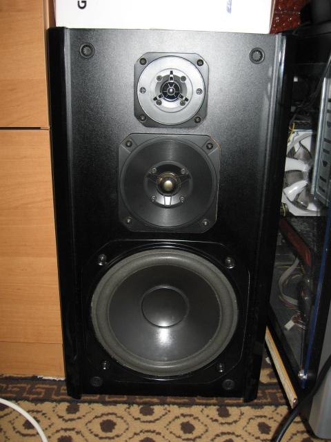

First I want to Say Thanks to ApexAudio and all the STARS that keep woking on the PCBs and more.
I am going to build a stereo amp for my new Wharfdale Diamond 10.1 (100W), hoping they will
sound nice, havent heard them play yet.

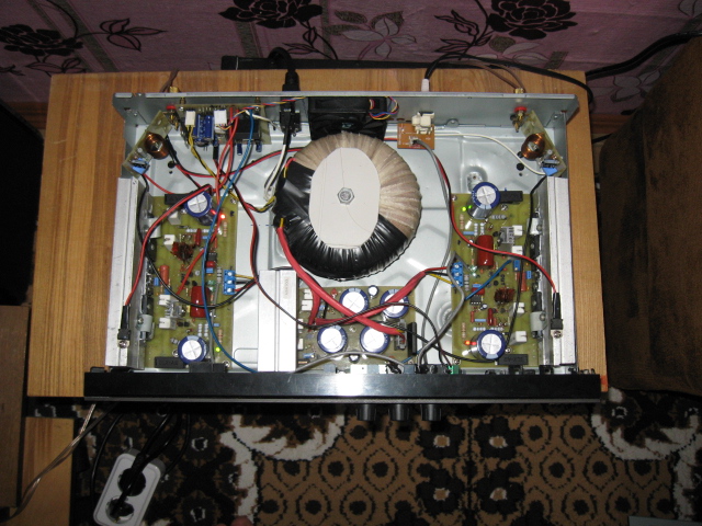

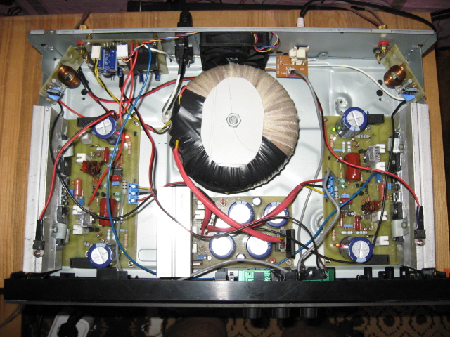

I've remove wire jumper in the bottom side.
Will the bottom foil pattern come-up?..
I like your design rectangular yet compact I figure the output transistors are well spaced on the heatsink.
Nice work!

Does anyone have experience with these speakers and how do you think theyll match
with the SR200 amps?
They small and compact, its very small where I live and I only have a bedroom to myself.
So I thought they would be nice
