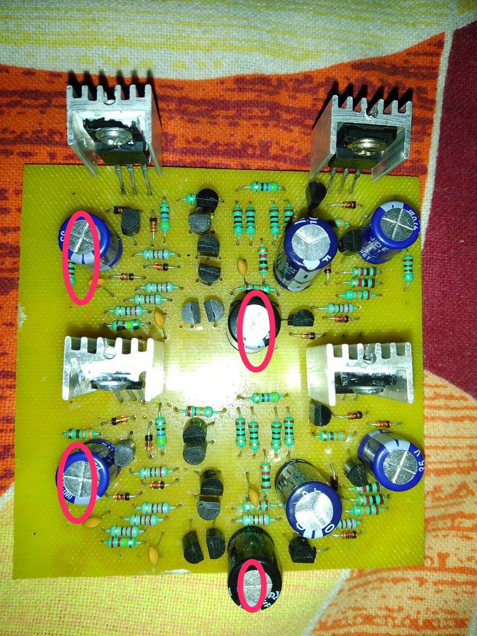

Hello guys finally my sr 200 working.i also made pp12 .1st sr200 I am using 45 0 45 Ac 8 amp supply .
In DC it's 63 0 63. But it's sound too low like 50 to 80 watt. 2nd I made pp12 there are capacitor pop up. Can any 1 guide me .I will upload photo pp12.i just Mark red .Which pop up.i am using 24 0 24 supply.can any 1 guide me .Thanks all
Sunny, if your build of the amplifier that worked fine for 100 people before, doesn't work - it doesn't mean the amplifier is bad.
It means you did not build it the right way.
You ask to help with troubleshooting without giving any information for that.
How do people know what's wrong with your amplifier?
If the problem is that when bass hits you loose the volume of the mids and highs - first thing I can think of is the rails sagging.
Is your PSU powerful enough? Do you use the wires "fat" enough for the high-current connections?
In general, to see if your amplifier works correctly, you need a DMM (preferably True RMS), oscilloscope, signal generator, and load equivalent (100W or so). You send the sine wave through the amplifier, monitor the load with an oscilloscope, and track the rails with DMM at the same time.
Valery
PS. Popped up electrolytics most likely mean you have soldered them backwards. Check the polarity of those capacitors - plus to plus, minus to minus.
