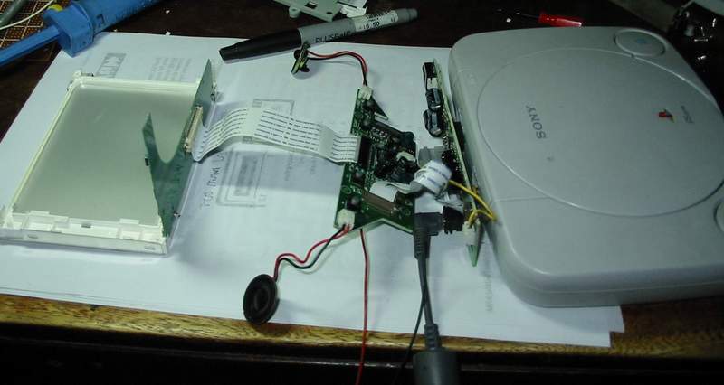

stripping a Redant 5" PSone LCD

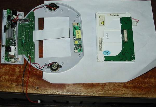

might be helpful to those planning to strip a Redant 5" PSone LCD.

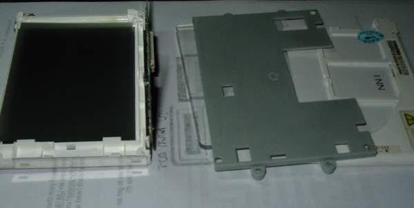

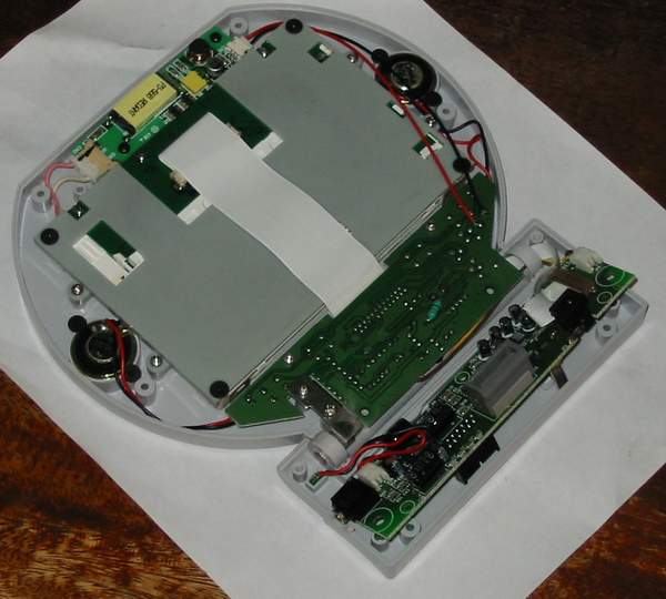

the LCD came from Toshiba with model number TFD50W32-B
here is the back of the LCD with cover removed.

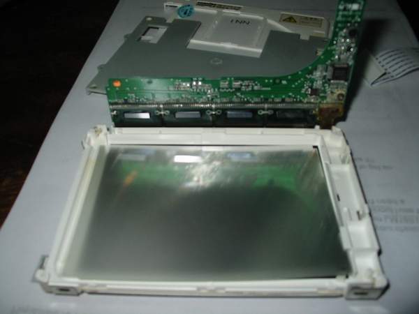

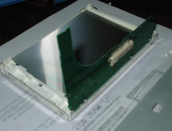

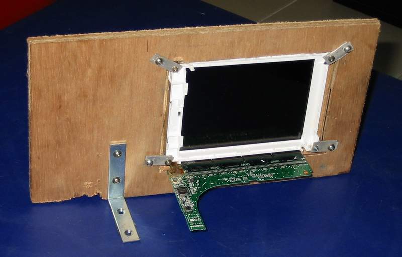

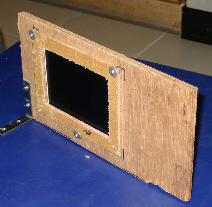

mounted LCD.
based from what i experienced, you still need to cut some parts of the plastic frame as it blocks the light source going to the LCD or the other way around, blocking the projected image going to the lens

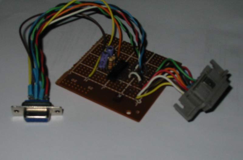

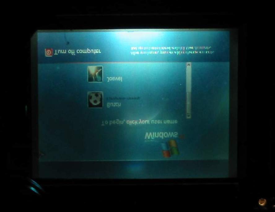

🙂 are you also using the same LCD? this LCD has only RGB input and i had to do the VGA hack to play DVD/VCD via a PC.
my problem now is the setting of the display. i can only see the upper part of the screen (about 70%). any settings you can recommend?
this is the H-sync/Vsync mix to VGA adapter i made for the LCD

If you are looking for 5" LCD with RCA(composite)
video then i would go for the Sony branded PSone LCD screen. I'm stuck with the Redant as it came together with the PSone player i bought for my son. The Redant LCD has no composite video input hence you can only make do with the RGB and convert it to VGA interlaced or as indicated in the computer 640 X 480 i.
