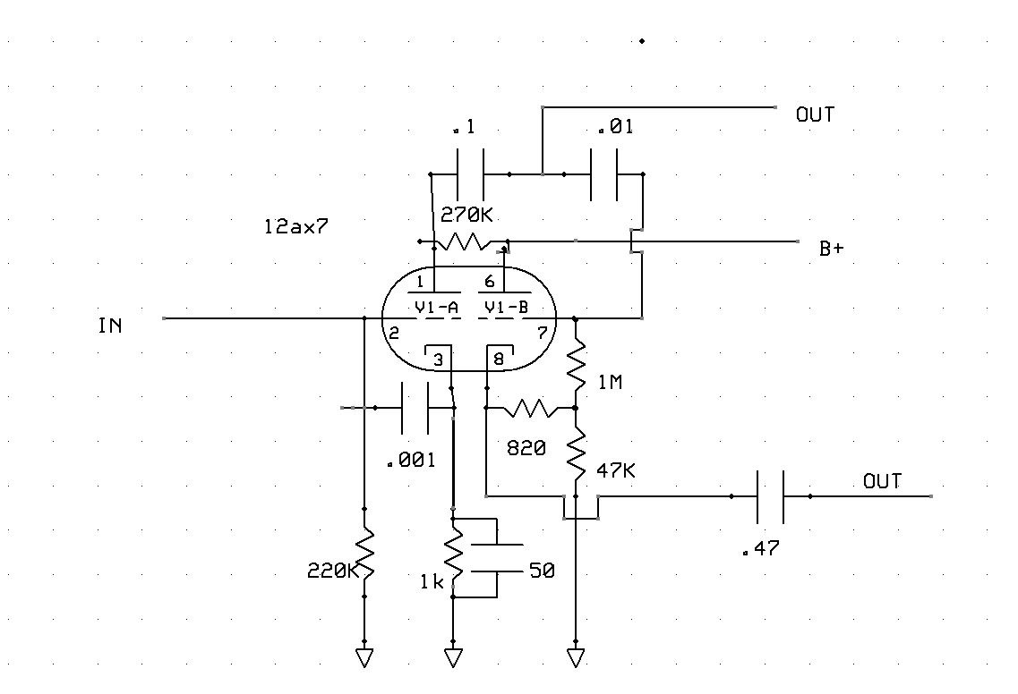

strange preamp
What type of preamp is this? I have never seen one wired quite like this. Its from a Baldwin organ amp I plan to convert for guitar use.

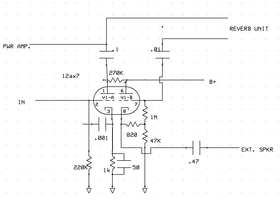

It is point to point not a PCB. I do now see another wire from the second cathode, It goes to a cap then on to a socket for an external speaker cabinet. I didn't notice it before, it is quite cramped in there. Now it makes sense, thank you for pointing that out.

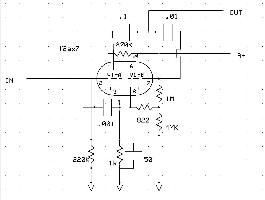

What's the thing driven from? I thought at first the .001µF on the input was a bootstrap, but there's a cathode bypass capacitor, so it's essentially rolling off high frequencies.
And while the cathode follower is giving a decently low output impedance, with that 47k it's not capable of driving current into it.
I Now it makes sense, thank you for pointing that out.
I've drawn a LOT of circuits out over many years - if it doesn't make sense it's almost always because you made an error 😀
In this case it didn't help the actual way you had drawn it (I usually draw it out roughly, and then rearrange it to be in a normal configuration), but it was a standard looking circuit IF there was a connection to the second cathode, and no reason for the second triode if there wasn't any connection.
The thing with drawing circuits out is you really need to know what it's going to look like before you start 😀
