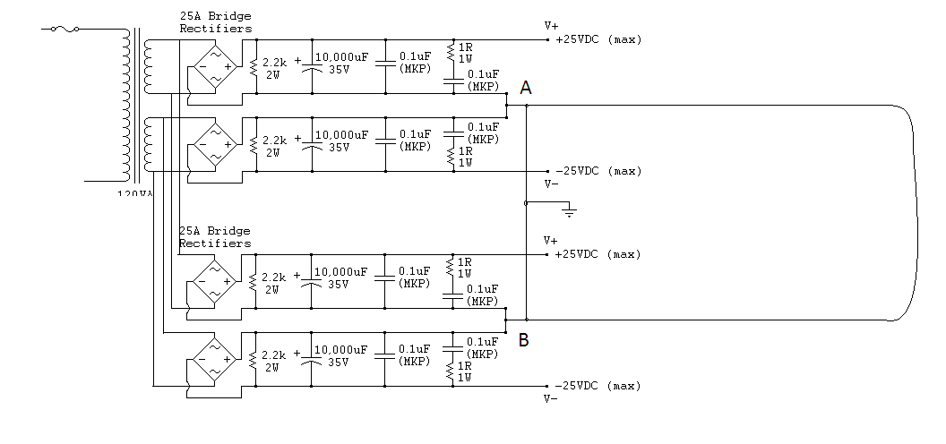

Since you are using separate bridges for each secondary I think it's better to create the 0V rail at the output?
Yes, given the perverse design one could still improve things a little by directly joining the two 0V outputs, then running a single wire from there to the groundbreaker. This would shorten the piece of wire with uncontrolled charging pulses in it.

Actually I meant like the power supply here DIY TDA2050 Hi-Fi Chip Amplifier (chipamp)
I think my PSU is very similar to this.
My ground on CRC is solid 12ga bare copper wire. Whether is single or two doesn't matter. But ground pints are connected to clean DND
But it isn't. You have two of these parallel with diodes switching in parallel at slightly different times. But that is not your only problem, it's the way you have positioned the parts and connected them together. You will not find one good amp that has been build like this.
Yes, that is clearly your firm belief. While you persist in this misunderstanding you will have difficulty making a low hum amp.xrk971 said:I think my PSU is very similar to this.
It may be slightly worse than that. The chassis connection you show should be moved to the right hand end of the diagram.Mark Whitney said:It is more like this.
I was still half asleep this morning. The bendy line on the right is meant to be the interconnects, which could/should have their own chassis/PE connection.
Ok, I will take it apart and rewire from scratch. The last iteration followed you guys' recommendations and still had hum.
I will try to follow the Pass FW standard PSU to the letter and see what happens.
If you really follow our recommendations then you won't have PSU-based hum, although hum may still get in in other ways. In your case you need to remember that two things cannot be both isolated and connected, so one secondary should feed one rectifier which feeds one reservoir cap. Then join things at the clean end only, using just one wire. Finally, use one wire to connect the whole thing to the safety ground.

You might interprete 'the letter' incorrectly if you are 'just' reading it. Unfortunately, in cases such as this, there is no way around to studying what is being said here until you grok it. Then you can do it in various ways that all are correct, rather than having to rely on something that could be right, could be wrong, could be read wrongly, or any other opportunity to take your chances.
