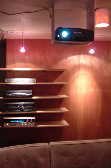

I've been consumed by the pressures and self induced stress from the material world, hence my delayed response, sorry about that, check out the NEW PICS of this diy lcd projector INSTALLED on my entertainment room ceiling, I encourage you to do the same, email with question, stay busy !
Hello, post your results too, as you finish your lcd/slide projector projects, yes, that is a usps cardboard box screwed to the ceiling, elevating the projector, I would recommend this as a simple, effective, and inexpensive way to (with no build time) get that projector out of the sweet spot, or your lap ! just tack the wires up and bravo !!!!!!!!!!!!!!!!!!

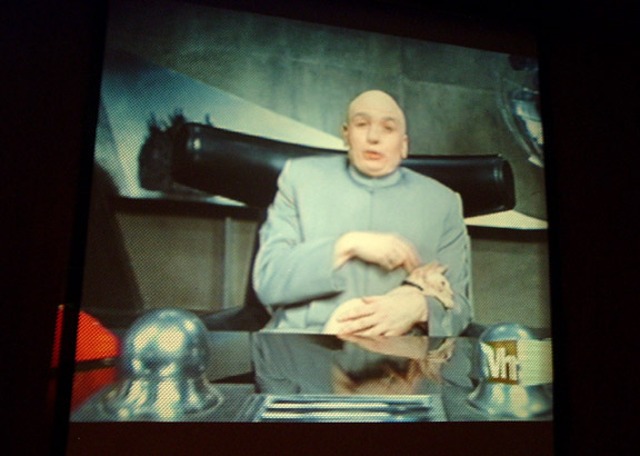

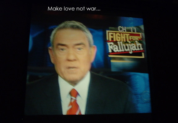

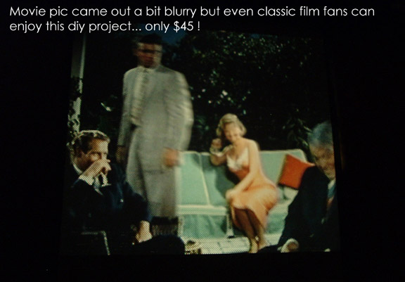

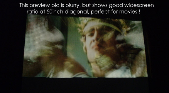

Dale - Nice screenshots man! Too bad they had some motion blur. I like the box idea, but I think someday it will collapse on your head, lol😉
