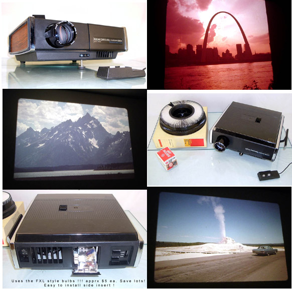

here is a PERFECT example of a slide projector for this application ! checkitout>>>
want big screen ????? without the costs !!?? > start with this projector !***here***
