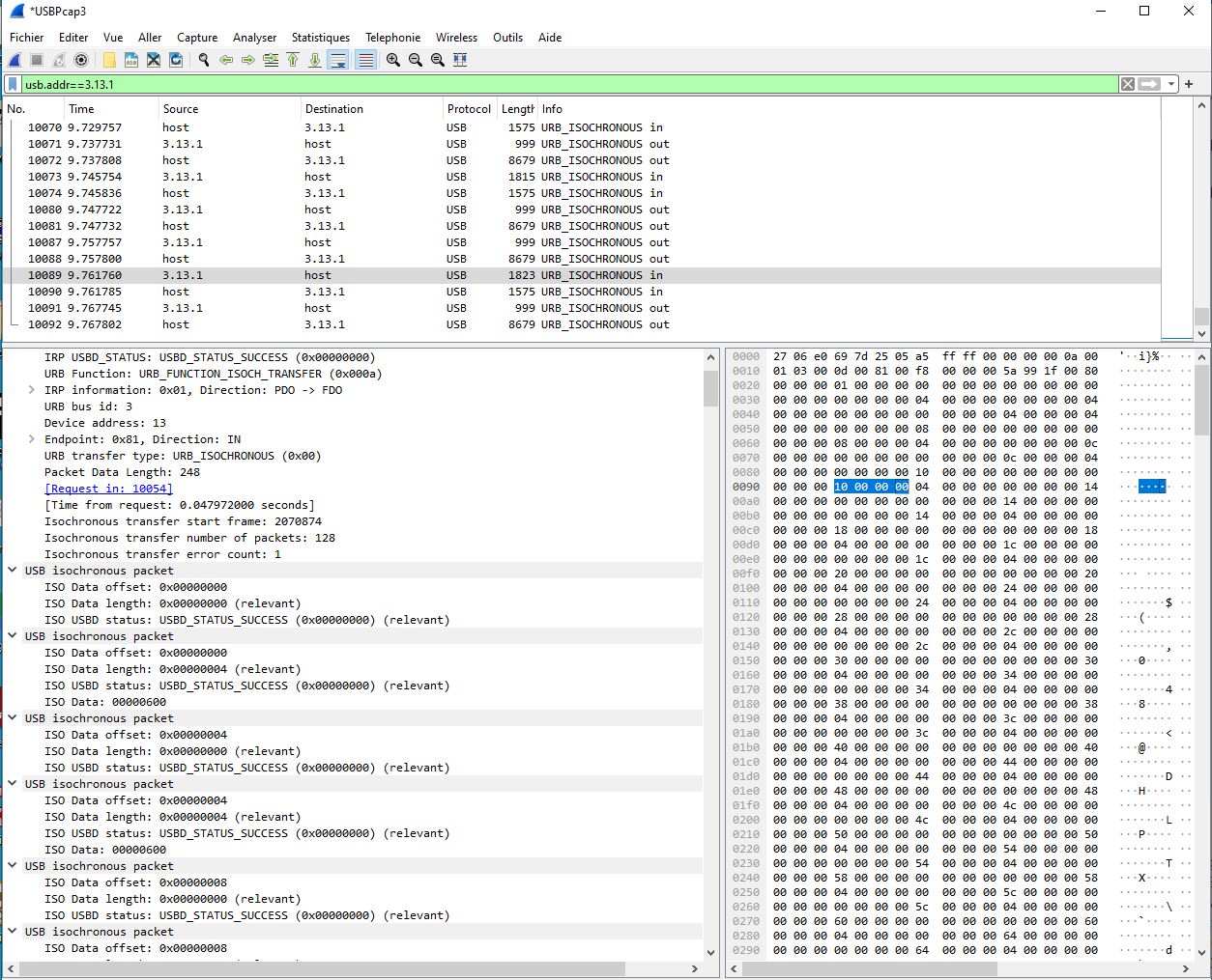

This is unfortunatly systematic. And I still have buffer over/underruns. Host and device don't synchronize. Something is wrong there.
I try to use Wireshark, but this not easy for me. I captured something that looks like my USB packets. I get some ISOC in from the device to the host, with correct endpoint (0x81) but the frame is 18xx length, which looks big for 4 bytes feedback. There may be encaplusation overhead but...
I include a screenshot in case someone could help analyse, or guide mo to what to look at.
I look at the above, ant I see for each feedback packet:
  • 248 data length, instead of 4 bytes,
  • 128 packets,
  • alternance of empty packets and 4 bytes feedback data packets (ISO Data: 00000600) !!!!
  • repeated many times (possibly 64 times ?)
So the capture contains the relevant feedback data for the correct endpoint (so not a pointer on something completly different), but not packed in a correct way (many duplicates) ?
Do I read the capture correctly? Are those duplicates normal, like "as I have nothing else to do, I diplicqte the data so that you can cross check that all is OK or catch-up if you missed the first one) ?

From https://ask.wireshark.org/question/...k-usb-bus-capture-of-an-isochronous-endpoint/ I understand that what I see in Wireshark is that my feedback packets are not "OK". It groups the packets over 10ms. Each packet is an independant sending. So I have a mix of good feedback packets, and some empty ones (which report a message in the Windows UAC2 logs).
The USBX placeholder for the feedback implementation is too crude for the stm32 specificities of odd/even frames and IsoInIncomplete. It requests sending a feedback packet and suspends up to when the packet is read, and then immediatly puts another one. Will not work here...
@JMF11 : Thanks a lot for linking to that discussion, very nice description of the wireshark output. IMO it does look like some of your feedback packets are empty.
@bohrok2610 : The super informative comments to https://ask.wireshark.org/question/...chronous-endpoint/?answer=31679#post-id-31679 mention that USB timeouts to IN requests are "insanely short" (below 1us). IIUC the device must respond to an IN request immediately, i.e. it must have the data already prepared in HW.
