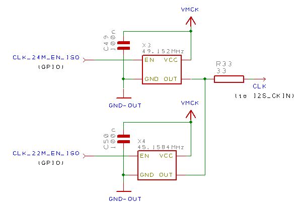

Would you have a schema for that, with typical components? Without such thing I won't be able to implement this config, and will have to go to the system clock reference from the OpenUac Bridge.
Schema is very simple (see attachment). In my implementation GPIOs and CLK go through digital isolator but that is not absolutely needed. MCK divider is set in register SAI_ACRx. Reference manual has all the required information.

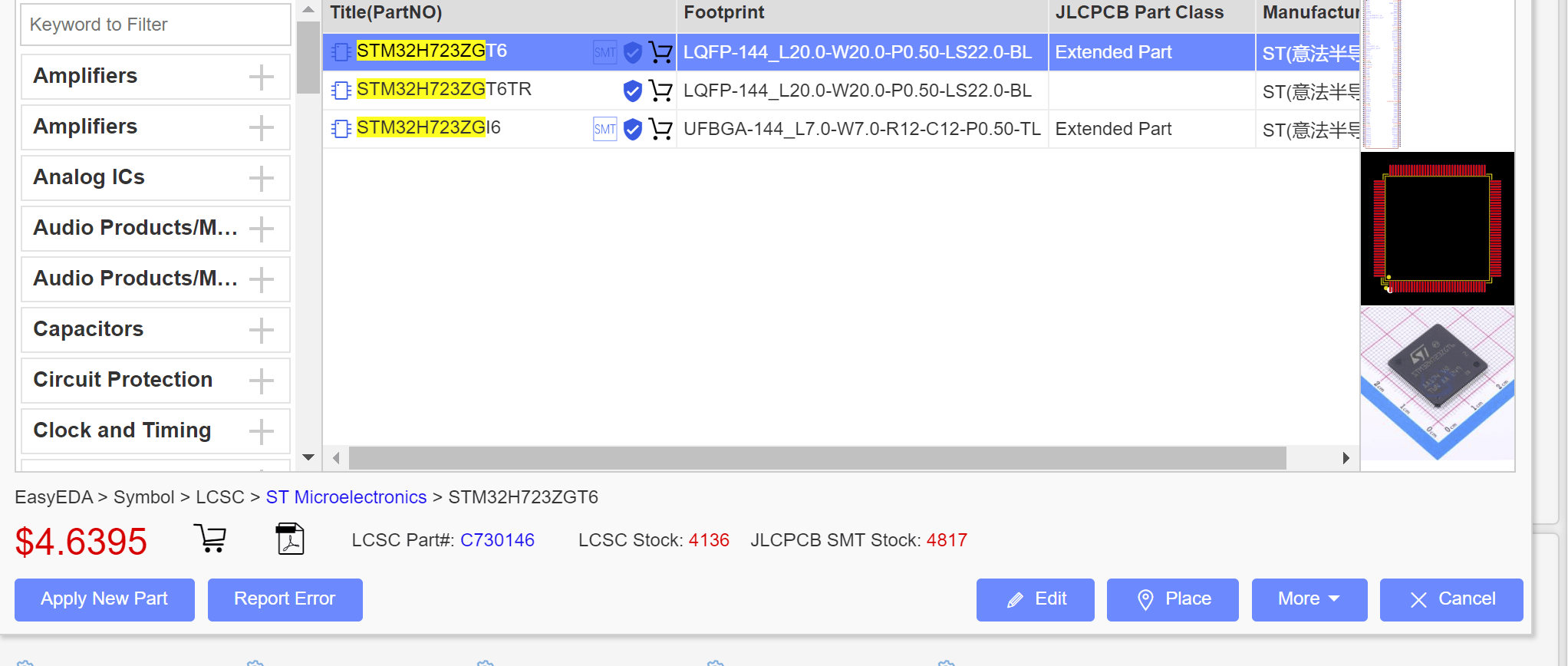

Last time I checked, on JLCPCB, they had stm32H7 and no stm32F7. So it would ne the natural way to go. The mchstreamer-lite could be a good inspiration source for the pinouts. But I won't be able to all the functions they do. It looks like a really versatile product a reasonable price.

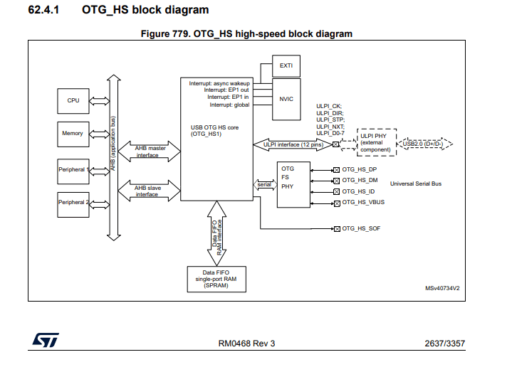

I was looking if the nucleo board has USB HS. It is stated in the databrief: USB Device only, USB OTG full speed, or SNK/UFP (full-speed or high-speed mode)
What means or SNK/UFP (full-speed or high-speed mode) ? I don't understand if they have two boards models, if a single board can have full-speed or high-speed mode, or if additional hardware is needed 🤔
Most Nucleo boards do not have USB HS so external PHY (ULPI) is needed. But Nucleo board layout does not work well with ULPI as required pins are scattered on different pin headers which makes it difficult to connect all ULPI pins without exceeding maximum trace length (about 75mm).
It is fairly easy to use ULPI PHYs with these MCUs on a custom design where trace lengths can be kept very short (below 20mm). I use USB3343 with STM32H7s and to keep ULPI traces short and equal length I have placed the ULPI chip below the MCU on the opposite side of the PCB.

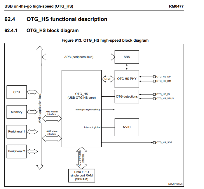

The new STM32H7R and STM32H7S have embedded HS PHY. But the flash size is limited.
