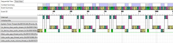

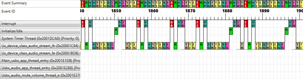

For traceability purpose, with bInterval = 4,
I have the packet length=0
[0]0000.0000::04/30/2024-19:02:59.319 [USBAudio2](0x01): buf 0 feedback packet 0 has invalid packet length 0, ignoring packet [0]0000.0000::04/30/2024-19:02:59.319 [USBAudio2](0x01): buf 0 feedback packet 1 has invalid packet length 0, ignoring packet [0]0000.0000::04/30/2024-19:02:59.319 [USBAudio2](0x01): buf 0 feedback packet 2 has invalid packet length 0, ignoring packet [0]0000.0000::04/30/2024-19:02:59.319 [USBAudio2](0x01): buf 0 feedback packet 3 has invalid packet length 0, ignoring packet [0]0000.0000::04/30/2024-19:02:59.319 [USBAudio2](0x01): buf 0 feedback packet 4 has invalid packet length 0, ignoring packet [0]0000.0000::04/30/2024-19:02:59.319 [USBAudio2](0x01): buf 0 feedback packet 5 has invalid packet length 0, ignoring packet [0]0000.0000::04/30/2024-19:02:59.319 [USBAudio2](0x01): buf 0 feedback packet 6 has invalid packet length 0, ignoring packet ...
There is a IsoInIncomplete event every uFrame. See traceX below:
Red II = IsoInIncomplete events
Single SP interrupts = Feedback read events
SP/IR interrupts = EP01 OUT datastream
SP alone are strange. I thought is war related to the feedback Read, but it is the same Semaphore as for DataOut (and should not be)
Next message, I will provide the same for bInterval=1

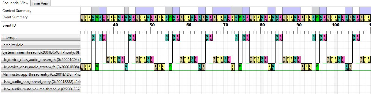

With bInterval=1:
There is no IsoInIncomplete (red II)
The SP are Semaphore Put, when the USBX stack receives data requests.
Single SP interrupts = Feedback read events every 2 uFrames. It is a different Semaphore than the DataOut (as expected), and it activates the Feedback Thread every 2 uFrames (bottom line)
But, I still have in UAC2 logs [USBAudio2](0x01): buf 1 feedback packet 50 has invalid packet length 0, ignoring packet
Arghh. And stopping at the breakpoint at the transmit, the length on stm32 side is 0x04, and pointer to data looks correct: value 0x00060000 (in memory 00000600).
Back to the workbench...
