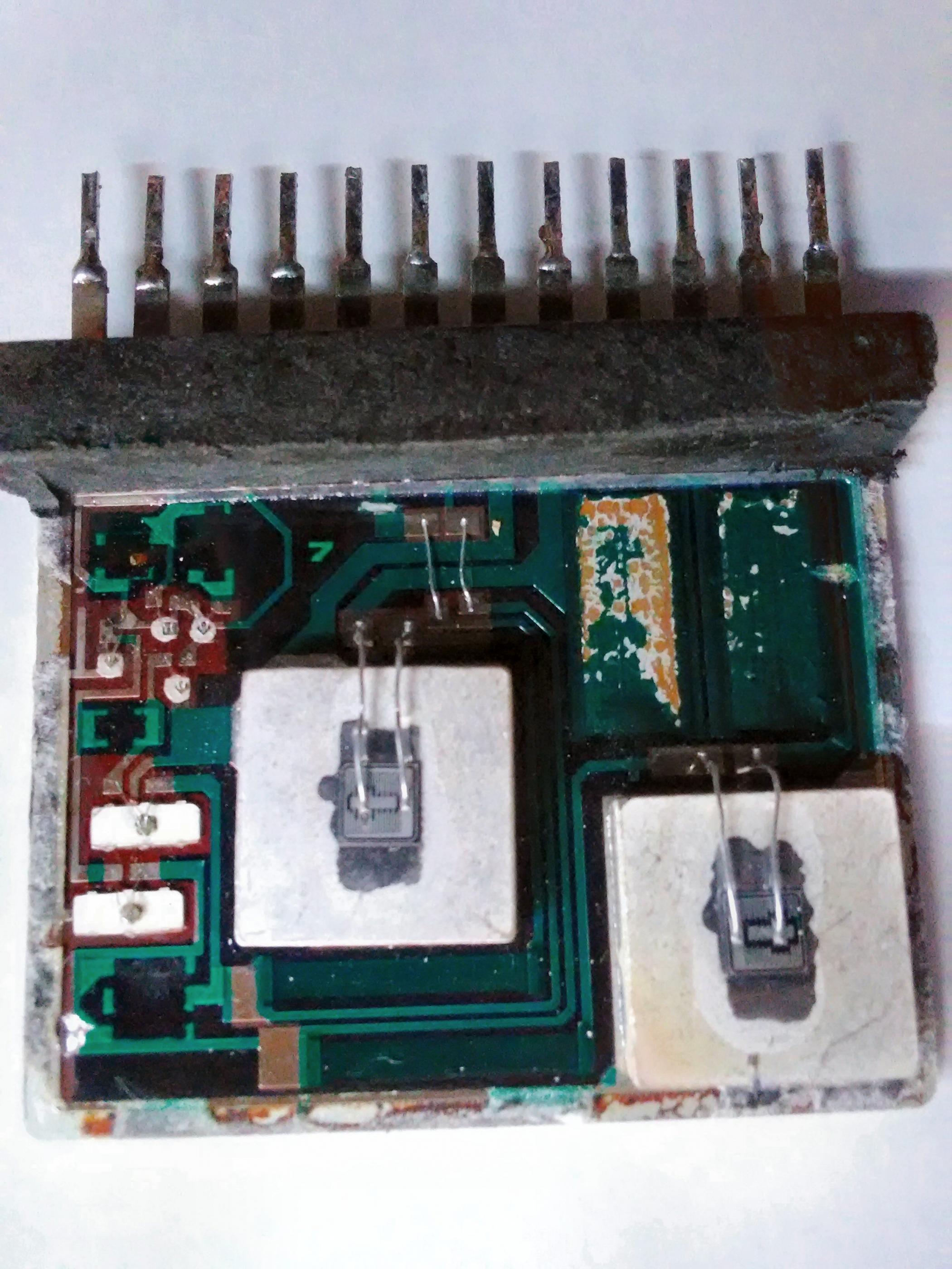

For information , my picture of genuine STK .

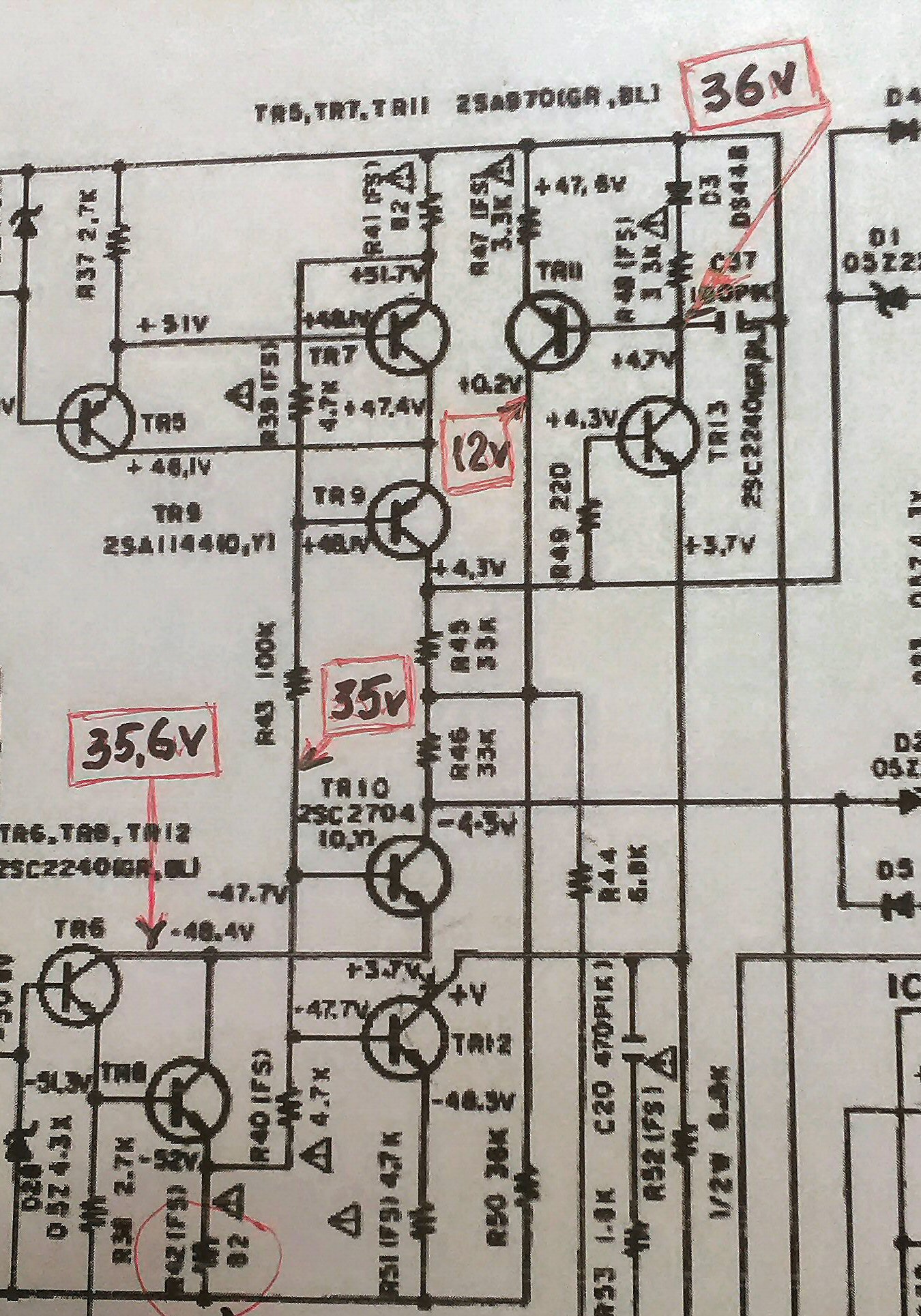

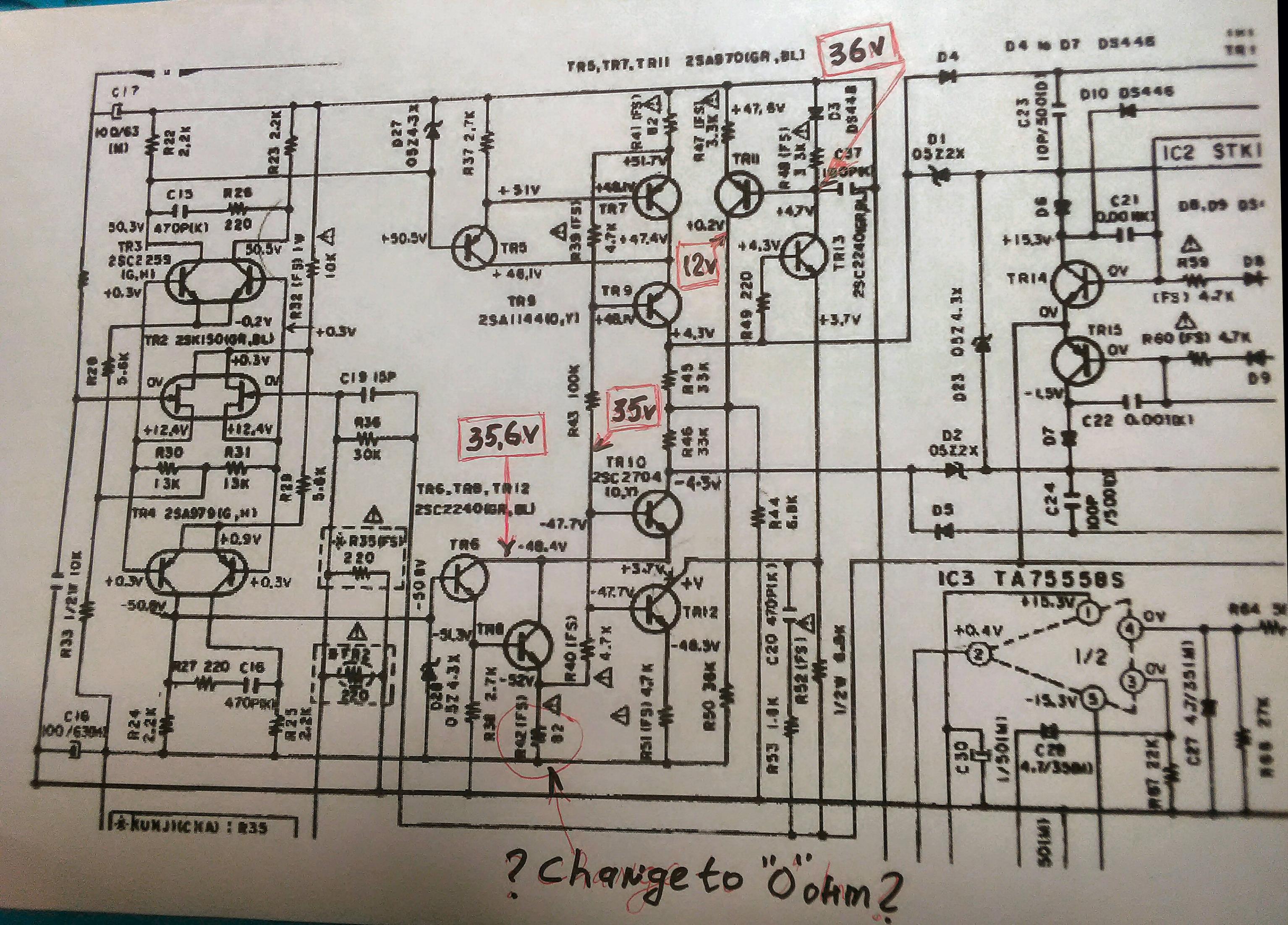

Repair problem AM-U61
After replacing the STK1080 ii of the right channel, it is not possible to adjust the voltage of 47.7v on the TR6 and TR8 collectors (actually 36v). Transistors, diodes and zener diodes around STK1080 have been tested.I NEED HELP ! Asking for advice. Thank you.

Hi Folks, just my 2 cents; I have a replacement STK1080ii on it's way from overseas but from what I've read here, it will probably not work. At the risk of sounding like an STK hater, I feel they are at a disadvantage from the start because they have an extra thermal barrier between the output transistors and the heat sink. This problem is compounded by the use of the heat pipe. Isn't the purpose of a heat pipe to conduct the heat away from the heat producing devices? This heat pipe does a U-turn and brings the heat right back behind the STK mounting plate.
I am very tempted to replace the output section with a couple of discrete power amps from a scrapped home theatre receiver. At first glance, there seems to be lot's of room once the STK's and heat pipe assembly are removed. I was considering amps from a 100 WPC (into 8 ohms) Denon home theatre receiver but the the AKAI B+ and B- voltage is 53 V. The Denon B+ is 43 V. Strange.

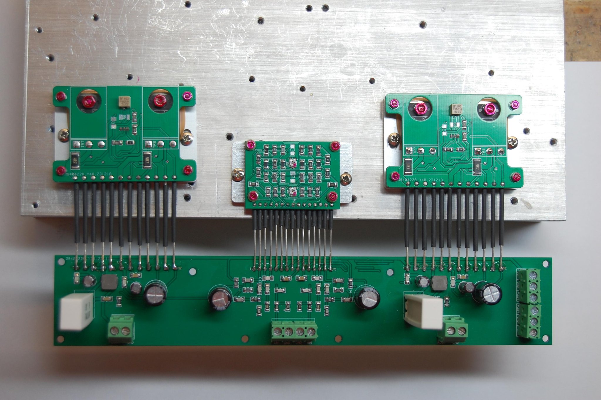

STK1080 Devices
Well, I seem to have had significant success.
I mounted the Output Devices onto a piece of 5 mm Thick Aluminum which I have attached to the Amp's Heatsink with Thermal Paste and screws.
After powering it up on the Variac, I slowly Increased the supply voltage up to our normal 230 Vac while monitoring the Quiescent Current, which I have set to 15 Ma in both channels. I have also attached the Vbe Multipliers to the heatsink and these appear to be doing what they should. After watching it for a while to see where things were going, I connected up the Oscilloscope and lo and behold, it seems to be Rock Stable, which is good considering there is probably some extra wire length in there between the mother board and my additions. Then I connected a set of speakers while still monitoring the outputs, all good. Then, a Signal Source to the input; and it sounds great.
Tomorrow I will give it a Power Output Test into my Fan Cooled Resistor Stack and see what is what. In the Final Build, I used .33 of an Ohm Emitter Resistors as I believe this might help the Thermal Stability and Current Limiting to activate a little earlier. I have attached some shots of the exercise. Thanks to All who have given help!
