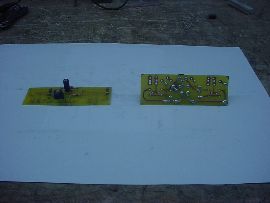

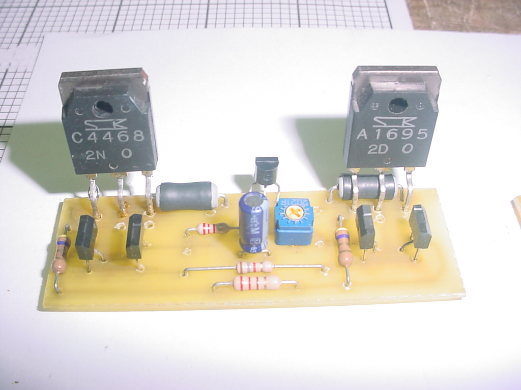

STK1080ii Device Replacement
Thanks for that --
I have now completed the Pc Boards and are now assembling them; see attachment;
I Need some advice; Due to the fact that I don't know how this amp is going to be treated, Do You think it could be an idea to increase the values of those Emitter Resistors to say .33 of an Ohm to make sure that the Current Limiting Circuit of TR14 and TR15 comes into play a bit earlier -- Or is it just best to leave them at .22 of an Ohm?
Thanks for all, and Kindest Regards --
Thanks for that --
I can't answer that one I'm afraid... because many current limiting schemes would not protect an amp from major abuse. Thermal issues would still come into play under sustained overload and probably see the module off.
All you can do is make a judgement call. Try 0.33 (or 0.47) and see how loud you can play the amp and then decide if it will be OK for the customer. Try adding a fixed a 8 ohm load across the speaker to make things a bit tougher and see if it still plays OK without noticeable clipping.

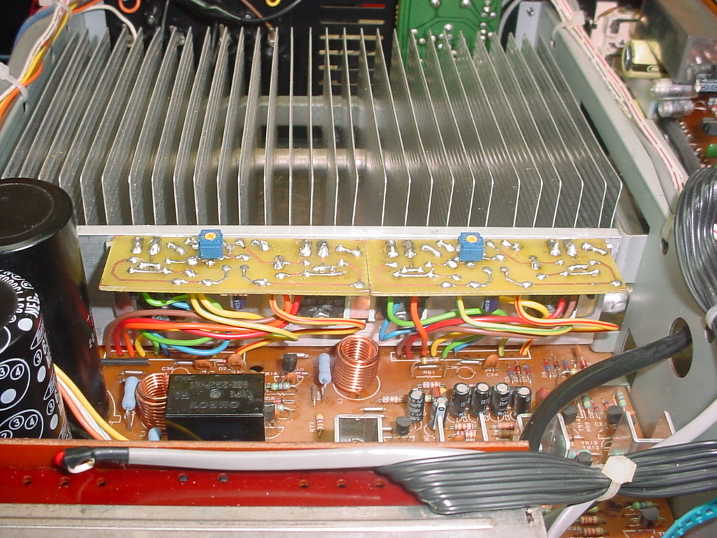

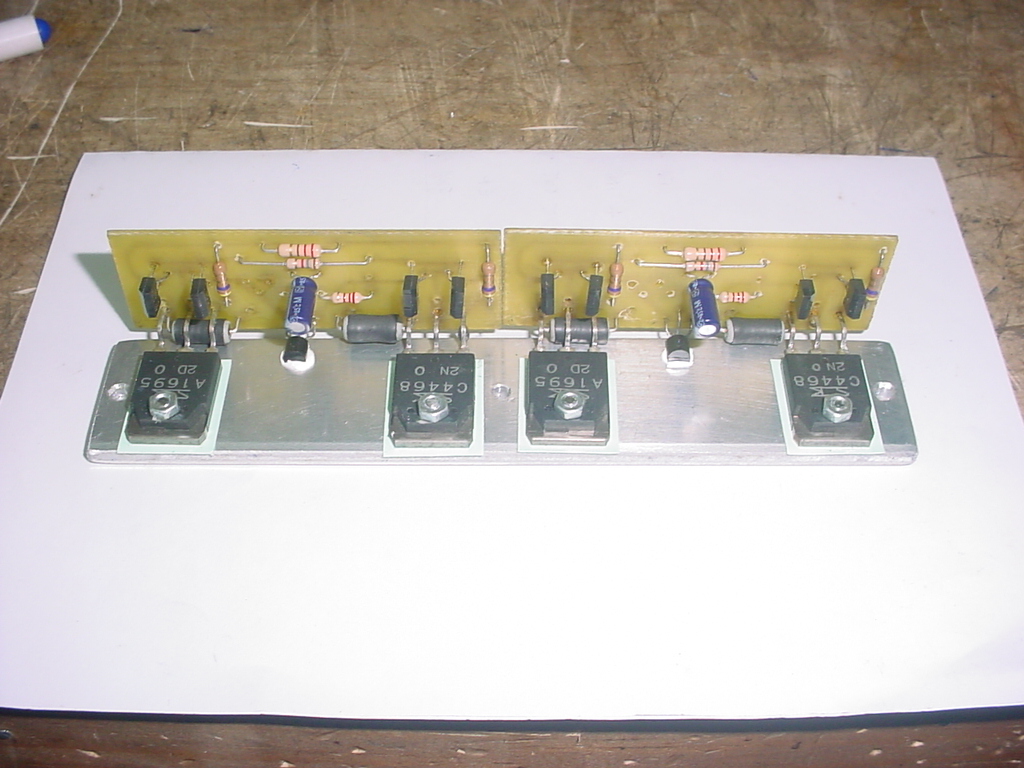

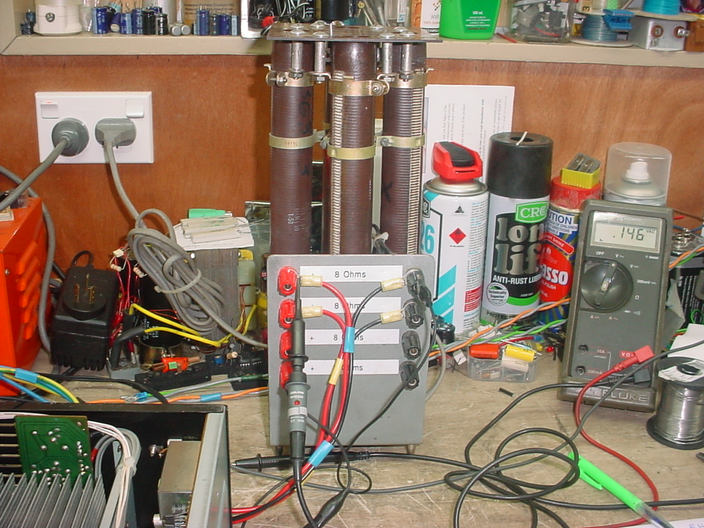

STK1080 Devices
Well, I seem to have had significant success.
I mounted the Output Devices onto a piece of 5 mm Thick Aluminum which I have attached to the Amp's Heatsink with Thermal Paste and screws.
After powering it up on the Variac, I slowly Increased the supply voltage up to our normal 230 Vac while monitoring the Quiescent Current, which I have set to 15 Ma in both channels. I have also attached the Vbe Multipliers to the heatsink and these appear to be doing what they should. After watching it for a while to see where things were going, I connected up the Oscilloscope and lo and behold, it seems to be Rock Stable, which is good considering there is probably some extra wire length in there between the mother board and my additions. Then I connected a set of speakers while still monitoring the outputs, all good. Then, a Signal Source to the input; and it sounds great.
Tomorrow I will give it a Power Output Test into my Fan Cooled Resistor Stack and see what is what. In the Final Build, I used .33 of an Ohm Emitter Resistors as I believe this might help the Thermal Stability and Current Limiting to activate a little earlier. I have attached some shots of the exercise. Thanks to All who have given help!

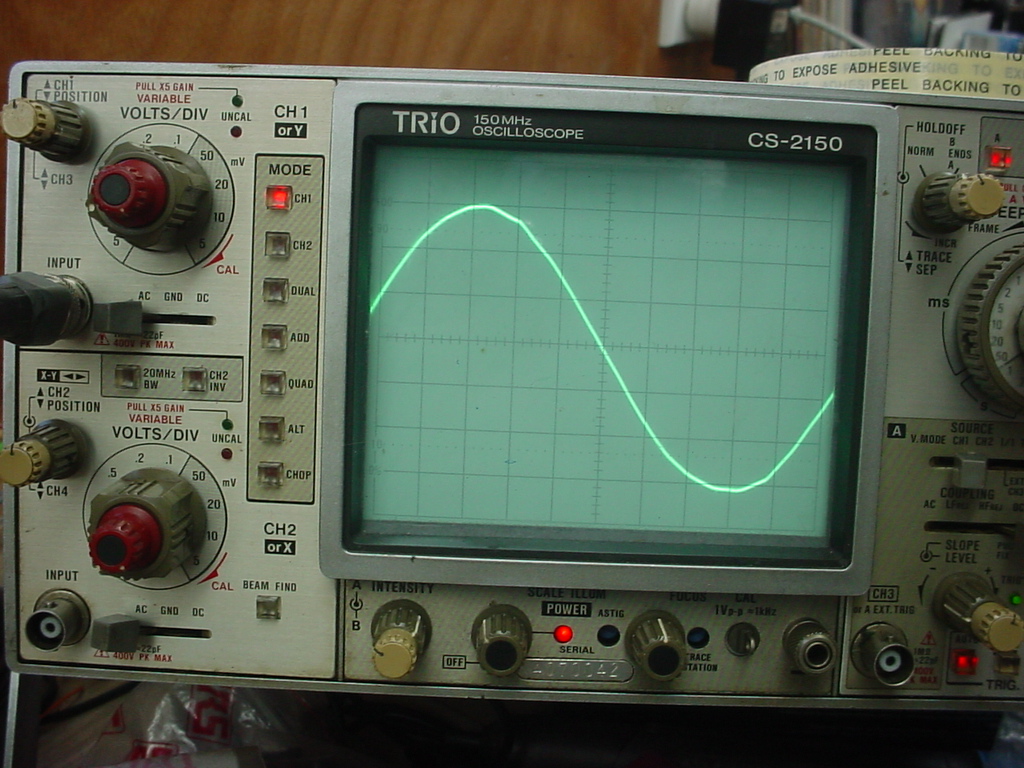

Hello, All --
Did an all up Performance Test after playing it for a couple of hours.
The result was 75 V p-p into 8 Ohms, which equates to 87.5 Watts RMS, measured with 1 Khz Input; that is just short of Akai's 88 Watts. That was with only One channel Driven.
No sign of any sort of instability, so that's good.
if Any One wants the Artwork for my PC boards, just ask.
Thanks for all help received; I'm really thankful for that.
Attached is the Output, just short of clipping, as viewed on the 'Scope.
