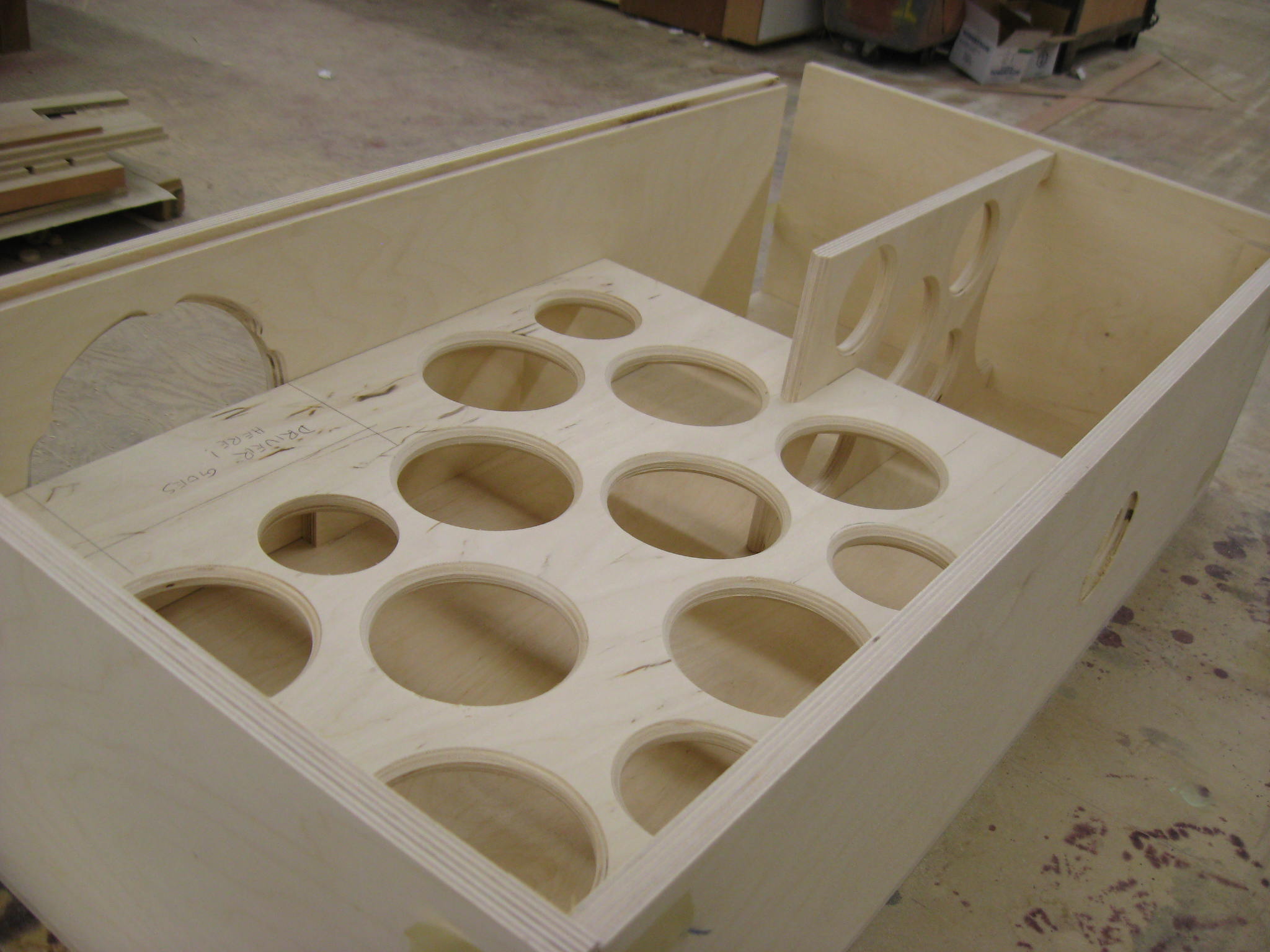

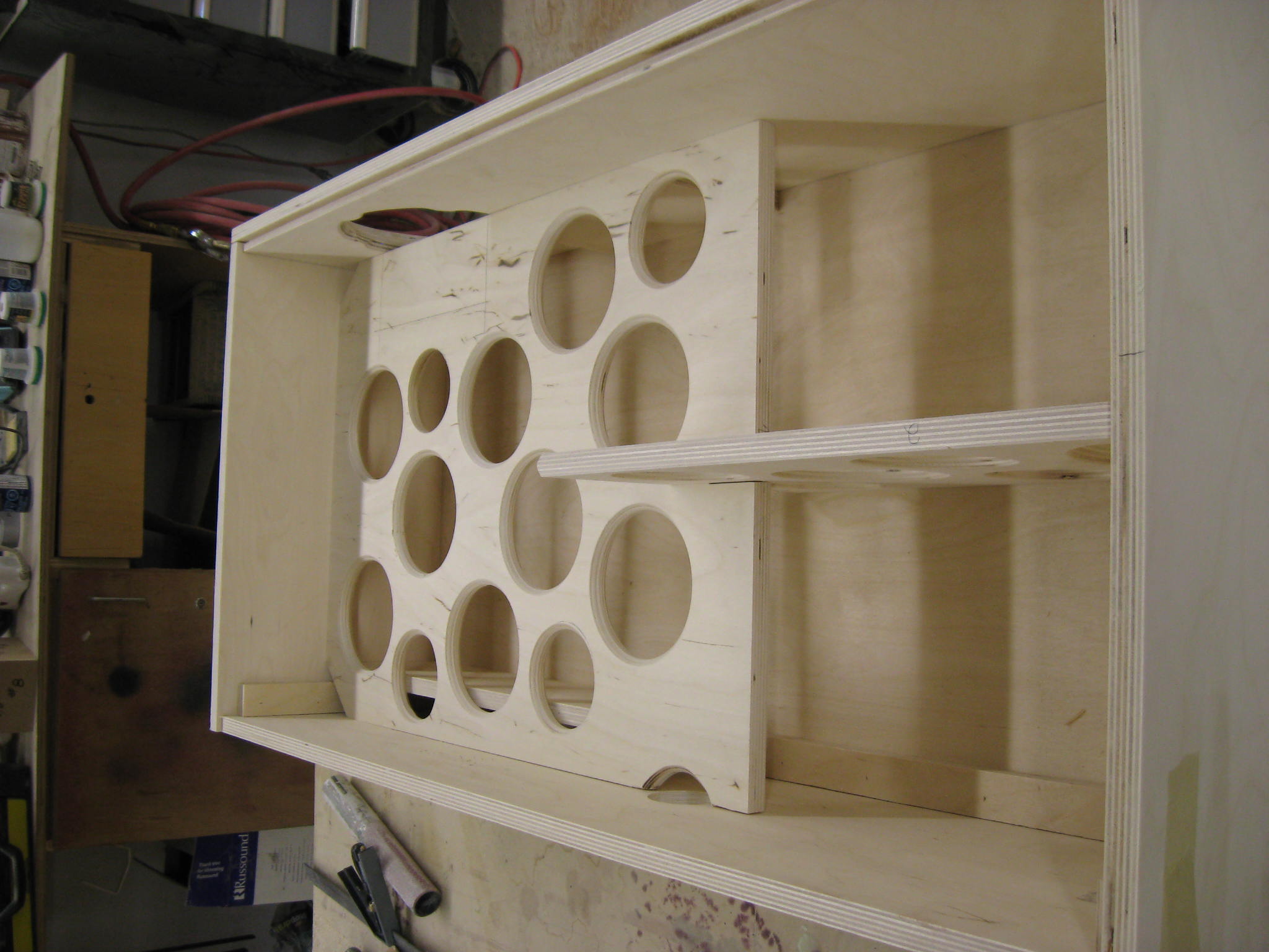

Rather than biscuits, if have a decent enough router, I'd take the extra time to cleat the rear panel and machine rabbets into the other 5 panels - makes for a much more glue surface area and a very well braced enclosure than biscuits.
Remember one guy's "Overkill" in another's "sure I guess that'd be OK for a quick n dirty" 😉 These boxes definitely benefit from bracing, but it could be less elaborate than shown - those took longer to cut /fut than all the rest of the material for the boxes.
